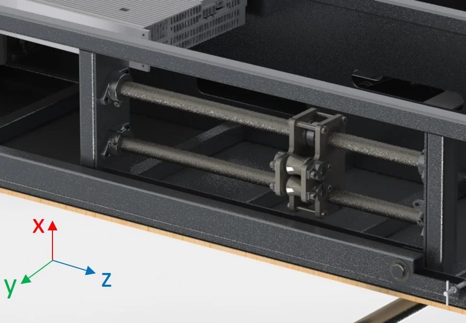

Consider this common design scenario: a machine part is guided along two parallel rails. At first glance, this seems like a great design. The two rails ensure alignment, and with some decent bushings, the moving part should glide along effortlessly. Right?
two rail assembly

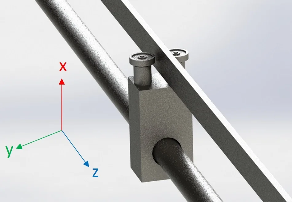

Not quite. Let’s look at the degrees of freedom (DOFs) at play. The first rail allows movement in the z-direction and restricts movement along the x and y axes. It also allows rotation about the z axis, but restricts rotation about the x and y axes. The first rail eliminates four DOFs, and allows movement in two — and our goal is to have movement in only one DOF (along the z axis). So far, so good.
Then we introduce a second rail that also tries to eliminate freedom in the same four DOFs. The result is an overconstrained assembly — the two rails will never be perfectly aligned. A better solution is to use one round rail to constrain four DOFs and a second rail with wheels on either side to eliminate the remaining DOF rotation along the z-axis.
two rail assembly with wheels restricting z-axis rotation

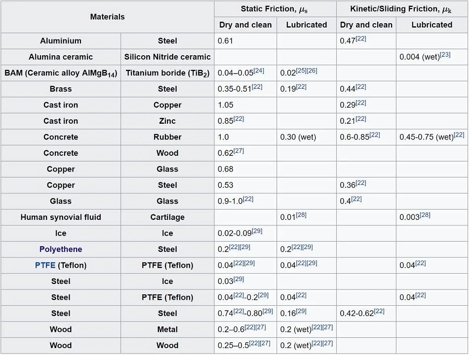

A quick glance at coefficients of friction shows that not all materials are created equal when it comes to friction matings. Rubber on concrete is incredibly high — a coefficient of 1.0 – while teflon against teflon is only 0.04. Even for materials with middle-of-the-pack coefficients, the numbers typically halve when lubricant is introduced.
So, how can you take advantage of these disparities?
coefficient of friction polymers and metals table
The most straightforward solution is to look for mating materials with a naturally low coefficient of friction, and incorporate them into designs whenever possible. Obviously, Teflon and Delrin are always low-friction material options, but other plastic materials work well, too. Nylon is low-friction against many other plastics, as well as metals, and costs less. Plus, with low-friction plastics or plastic-to-metal matings, you can avoid lubrication in many designs.

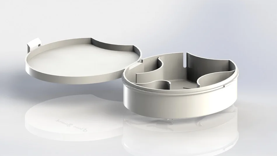

Before plastics were common, industrial designs had an amazing number of pins, joints, rails, and slides. Growing up, my dad’s blacksmithing shop had a hundred-year-old industrial automatic power hammer, and the only way to keep it running was to dump half a can of grease into the dozen Zerks lubricating all the moving parts. However, since the advent of polymers in the last half of the 20th century, we’ve enjoyed significantly more flexibility in our designs.For instance, take a look at an old-style candy container, like an Altoids tin. Even on a cheap container like this, the tin is carefully folded around to make a hinge, creating a small, high-friction joint. Now, take a look at a Bubble Yum container (man, haven’t thought about these for a while) or a floss box, and notice the complete lack of sliding parts. A living hinge across the back has replaced friction with flexure.
A Bubble Yum container in which a living hinge across the back has replaced friction with flexure
Similarly, latches on old cabinets or enclosures used to be complex and friction prone, where an axle support, pin, latch and spring were all part of the design. Current designs replace that complexity with simple cantilever latches, which eliminates friction points and a great deal of cost.
