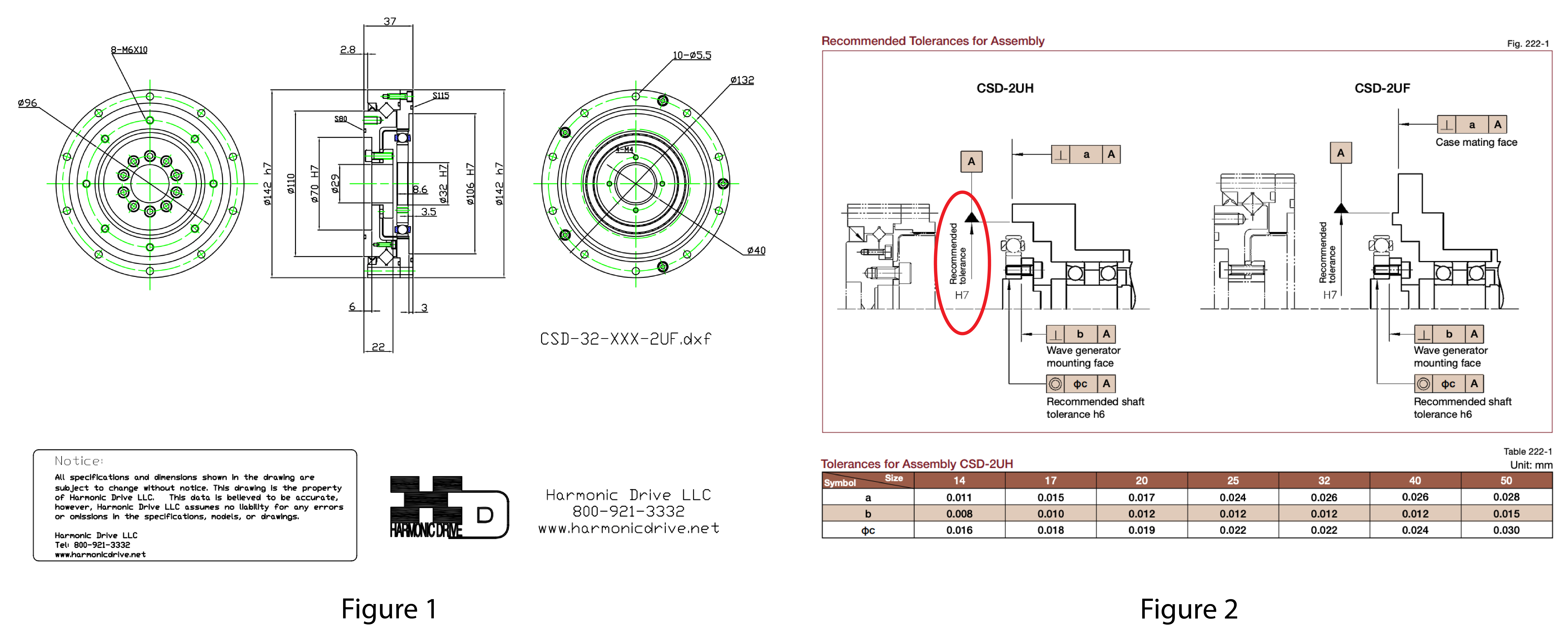

Most every robot joint houses a transmission, commonly a harmonic or strain wave gear set. The manufacturer will give the designer a specification for the fit of the gear set to the housing.  Many components will be specified in the ISO fit system. For example, in Figure 1, a gear set is specified as an h7 fit for the internal diameter. In Figure 2, the outer diameter is specified as an H7 fit. So the goal for fit between the housing and the gear set is a 142mm h7/H7 fit – what does this mean?

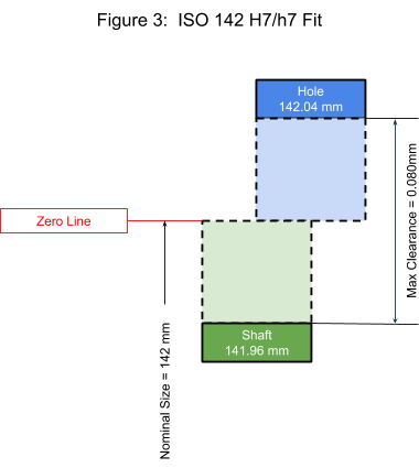

Figure 3 shows the layout of the ISO fit the manufacture is specifying for the gear set.  What this means is that the gear set will be manufactured 142mm 0.00/-0.04, and the housing the gearset fits into will should ideally be manufactured to 142mm 0.04/0.00.

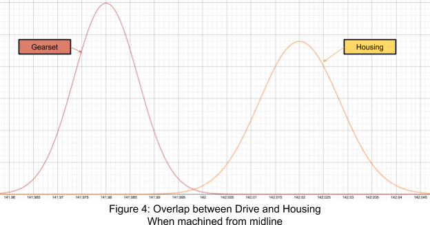

What about the machine shop? Can it make the part to the tolerance the manufacturer specified? Let’s say the CNC machine shop can hold a tolerance of +/- 0.025mm. This would mean they would be able to produce a part a little out of tolerance to the H7 fit by about 5 microns per side. For some perspective, spider silk is 3-8 microns!
Without going to the formalism of calculating a Cpk, think of the shop’s capability as a normal curve. If the housing were machined from the middle of the range, the resulting part would range from 141.995 to 142.045mm. The distribution of the tolerances would look like Figure 4. The figure assumes that the +/- 0.025mm corresponds to +/- 3.
figure 4
The takeaway here is that there is a very good chance that a shop capable of offering +/- 0.025mm will deliver housings that meet the specified H7 callout with minimal fallout.

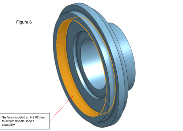

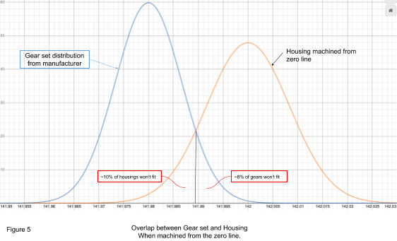

Using ISO standard fits can create a mismatch between the machined part 3D file and the component to be installed. For example, if the surface the gearset is modeled at the “nominal size” shown in Figure 3. This creates possibility the part would be made to 142mm 0.025/-0.025. This is particularly true if the 3D file is modeled with the housing surface at a diameter of 142mm which is the “zero line” in Figure 3 and the shop uses the 3D file to program the tool paths. This scenario is outlined in Figure 5.
figure 5
Looking at Figure 5 a few items are worth noting:
  • ½ of the housings are out of tolerance since they are below the minimum 142.000mm of the H7 fit.  This would result in the lot being rejected.
  • If the lot were 100% inspected and matched assemblies were created to bin the two distributions together, about 10% of housings would be scrapped.

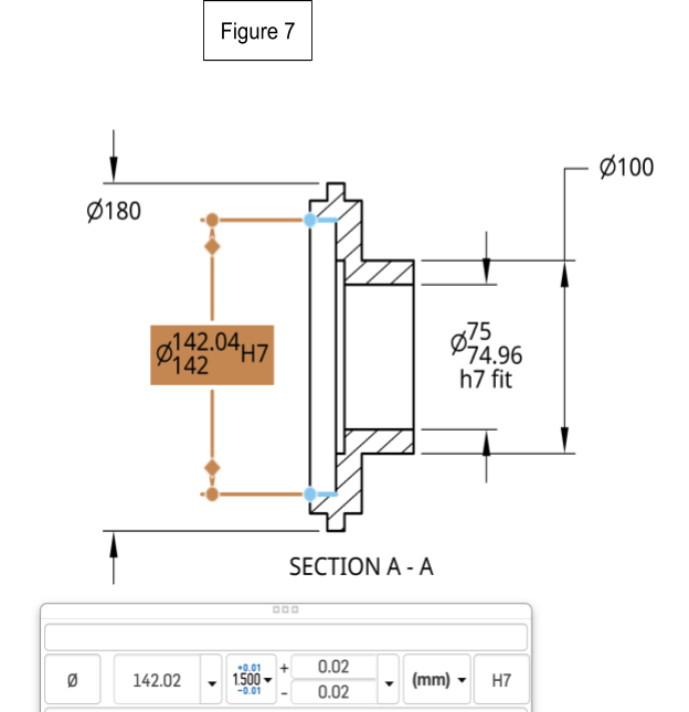

One way for avoiding this situation is to model the 3D file with a small offset to put the machined surface in the middle of the shop’s tolerance (see Figure 6).  This way the machine shop can use CAM software directly on the 3D model and centers the surface to the shop’s published capability. Keeping the ISO standard on the drawing keeps the ISO standard information and helps preserve design intent relative to the manufacturer’s recommendation (see Figure 7).
