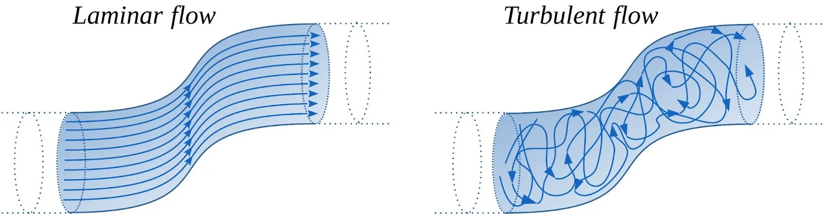

Fluid mechanics encapsulates multiple pairs of concepts — first, statics and dynamics, then compressible and incompressible, then real and ideal flow types. And real flow is further divided into laminar and turbulent flow.
