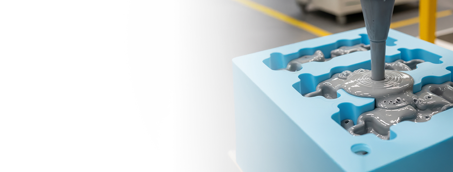

Urethane casting (also known as RTV molding, cast urethane, and silicone molding) is a fabrication method that uses silicone molds to produce production-quality plastic parts.
Urethane Casting production consists of three main steps:
1. Build a master pattern using 3D printing or CNC machining
2. Build the mold by pouring platinum silicone around master
3. Pour liquid polyurethane resin into mold, create polyurethane casting under vacuum
