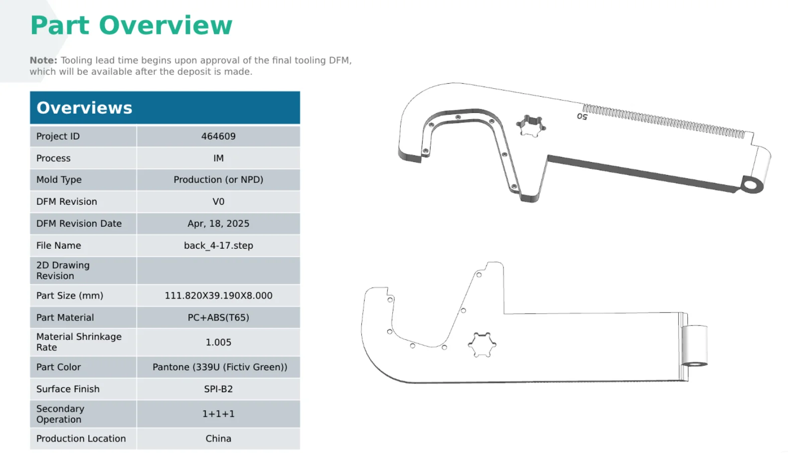

Full DFM feedback is often presented in a PowerPoint slide deck that includes detailed feedback for each part. The first slide for this component provides an overview of the part, confirming details such as material, color, and surface finish.
Fictiv DFM Part overview

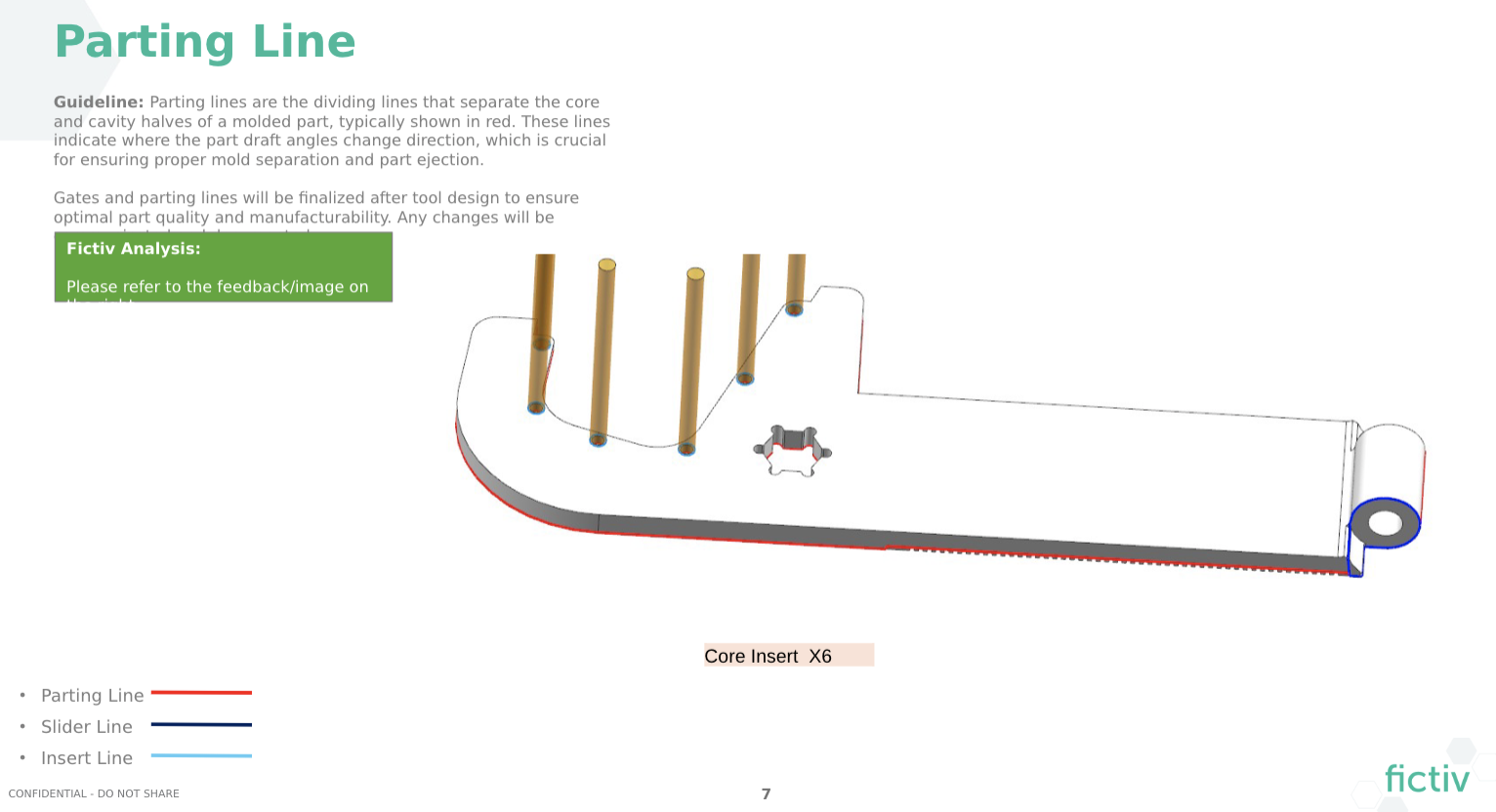

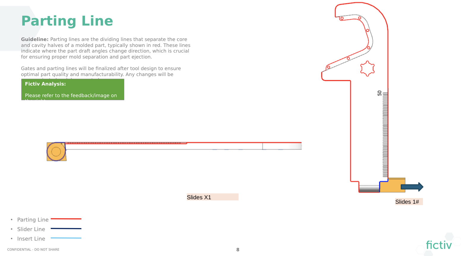

Parting Lines
Multiple images show the parting lines around the entire part, including core insert pins to create the holes in the overmold rib, and slides to create the undercut hole in the hinge.
DFM showing parting line with slide location.
DFM showing parting line with core inserts.

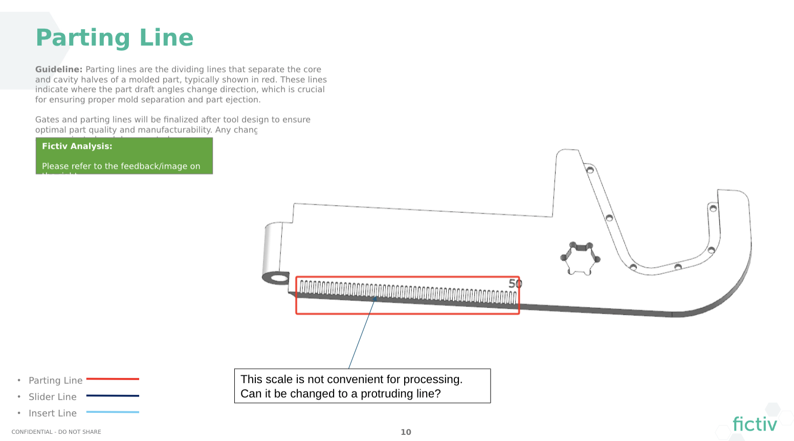

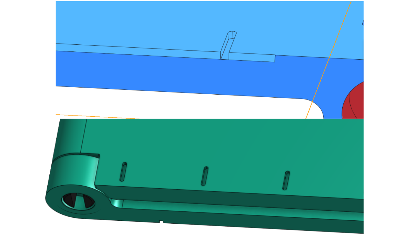

One piece of feedback was that the millimeter markings were too close together, as shown below. Our manufacturing partner suggested protruding rather than recessed lines, but I wanted the part to be able to lie flat on a surface. Instead, I changed them to centimeter marks and inset them from the edge for a simpler parting line.
DFM showing parting line issue with thin steel for millimeter markings.
Design change to mitigate the jogged parting line at measurement markers

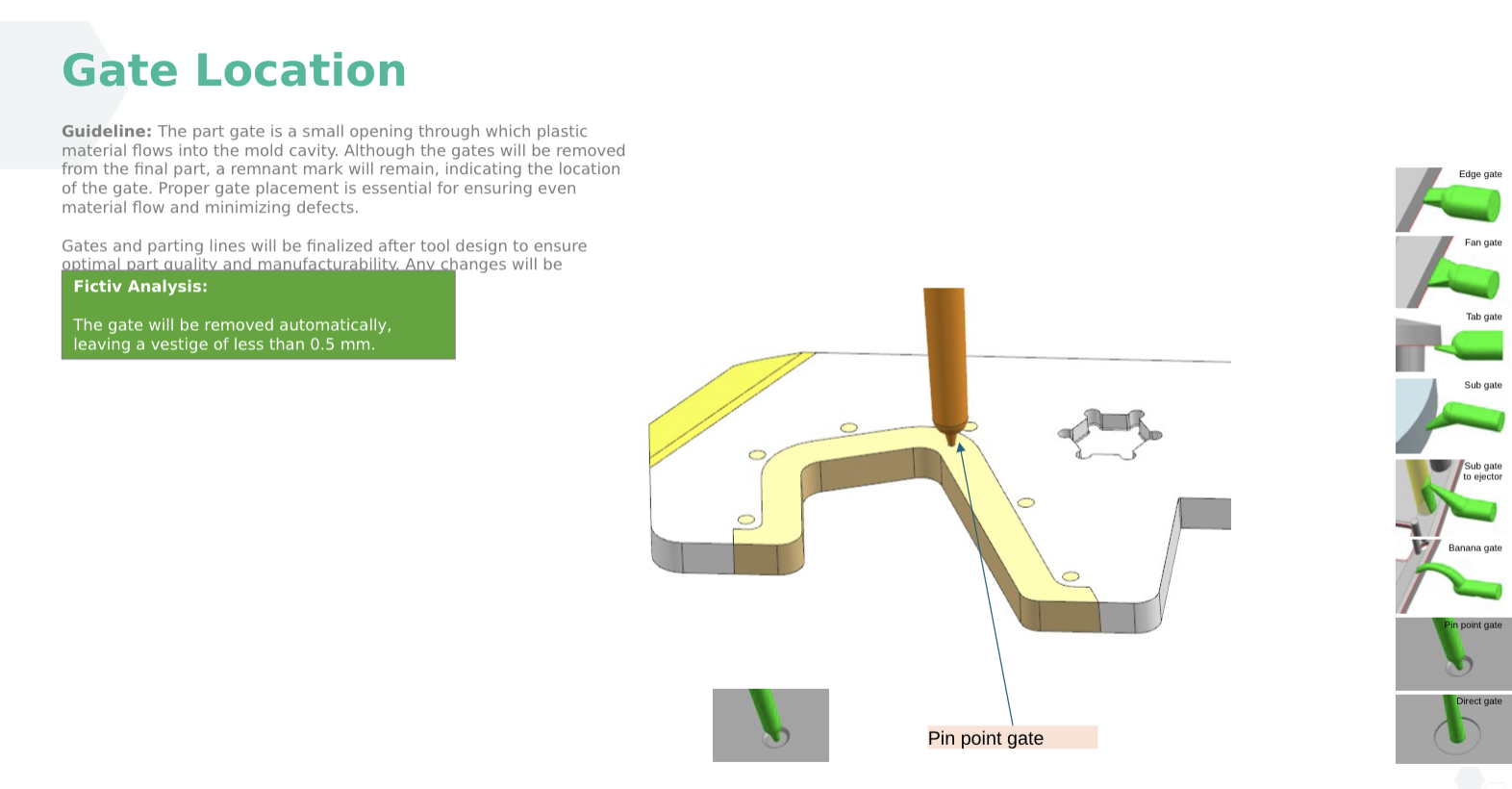

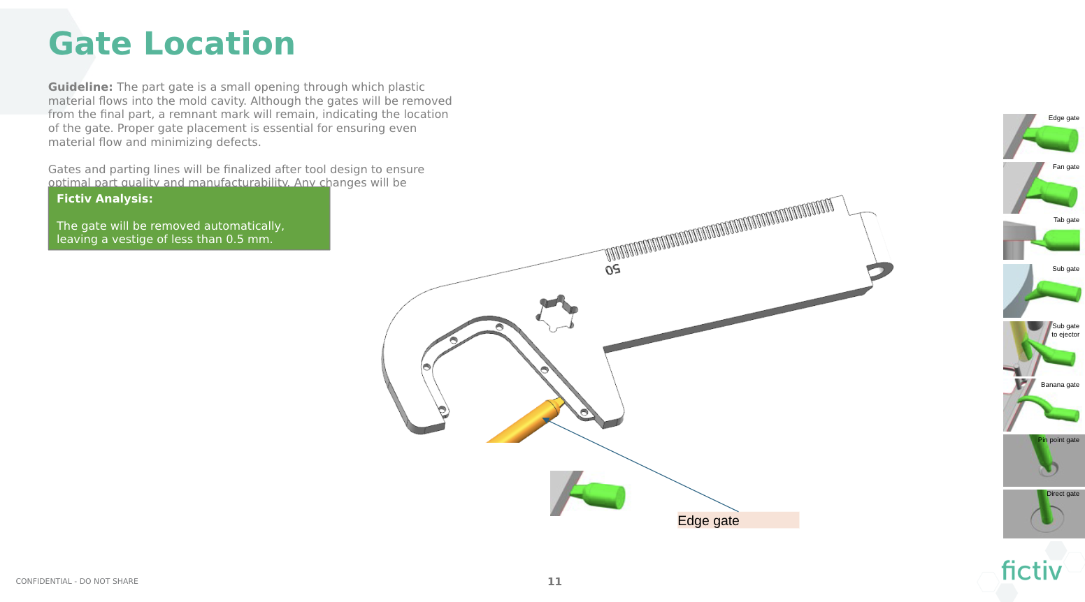

Gate Location
The DFM shows the gate locations, which I approved. There is an edge gate for the front part that is covered by the TPU overmold, and a more minimal pin point gate for the TPU overmold itself. There are various pros and cons to different gating options based on how visible you want the gate vestige to be on the part, and what is allowable for proper material flow.
Pin gate location.
Edge gate location

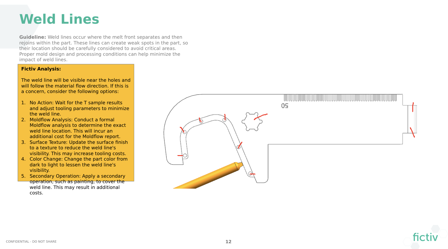

Weld Lines
Our manufacturing partner pointed out that weld lines might form around the holes in the part, which was a valid concern. However, I kept these features unchanged because they’re essential for functionality. Although a minor weld line could appear outside the hex recess hole, we optimized the gate location to help reduce this risk.
Weld lines sketched on DFM slide.

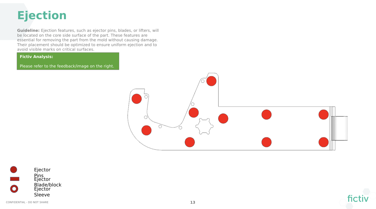

Ejection Pins
The DFM showed the ejector pin (and mark) locations on the interior of the part. I wasn’t sure it was necessary to have this many EJ (ejector) pins, but I accepted it because it’s a less visible B surface. In cases where aesthetics are more of a concern, there are ways to reduce EJ pins, such as an ejector block or manual removal of the part (though this can increase the risk of defects, such as warping).

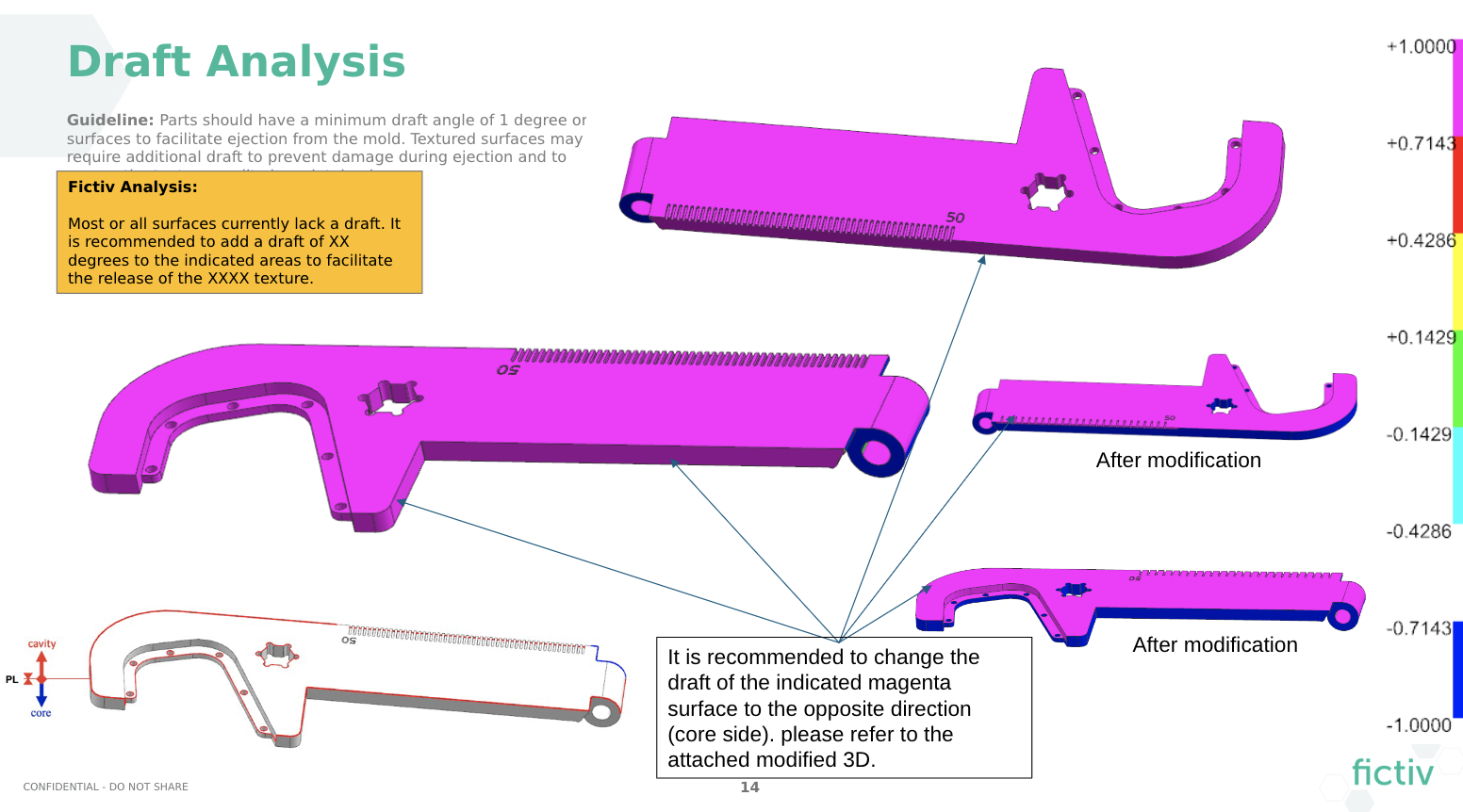

Draft Analysis
One significant change suggested was to modify the draft direction (and parting line), particularly in the overmold area, which would move the rib to the internal side of the part. Initially, I wanted to hide the rib entirely within the TPU—but Felix Zhang, Manufacturing Engineer for injection molding, recommended this change to facilitate demolding. I agreed, figuring it might be visually interesting to showcase the mechanical fastening features on the interior.
DFM showing draft analysis.

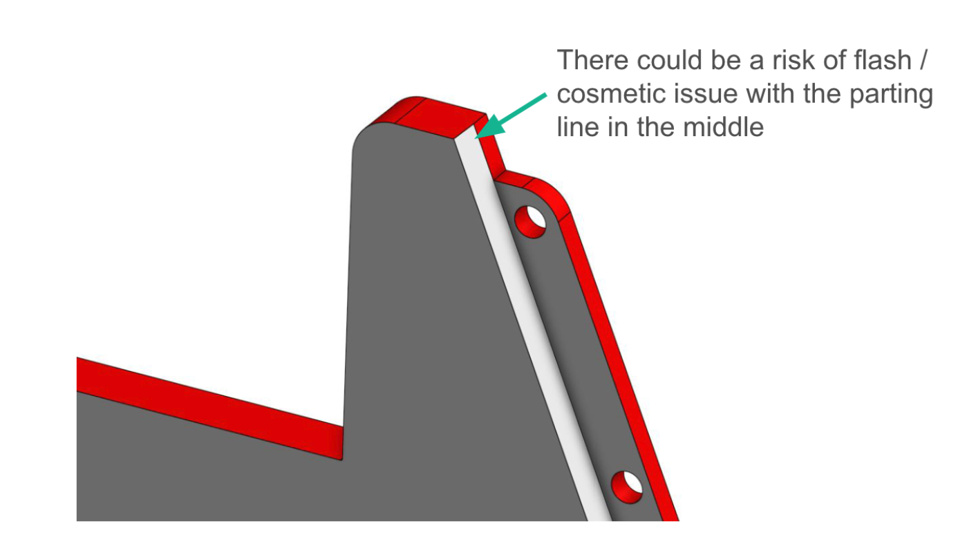

However, I highlighted the risk of flash and mismatch at the parting line. I was correct that this was a concern with the TPU overmold, but it was solvable by trimming the flash.
DFM feedback flash concern with a centered parting line

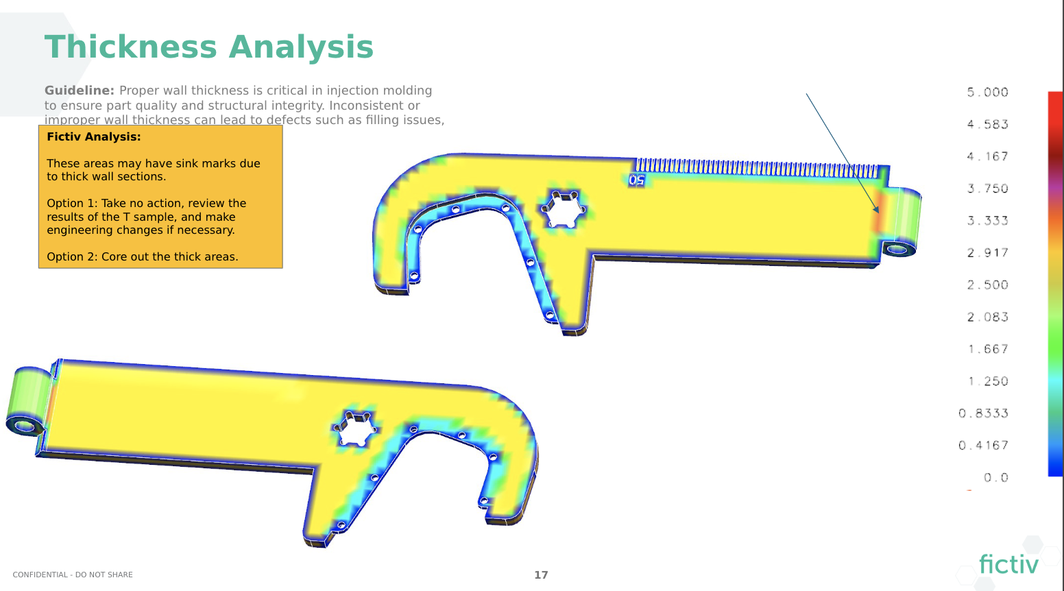

Wall Thickness and Sink Concerns
When evaluating wall thickness, there was a risk of sink in the thicker section by the hinge. I had used a fillet to remove the undercut underneath the circular hinge, but it added thickness to that area. I moved forward with the risk, because it was a gradual transition, and therefore sink could likely be processed out.
DFM showing thickness analysis.

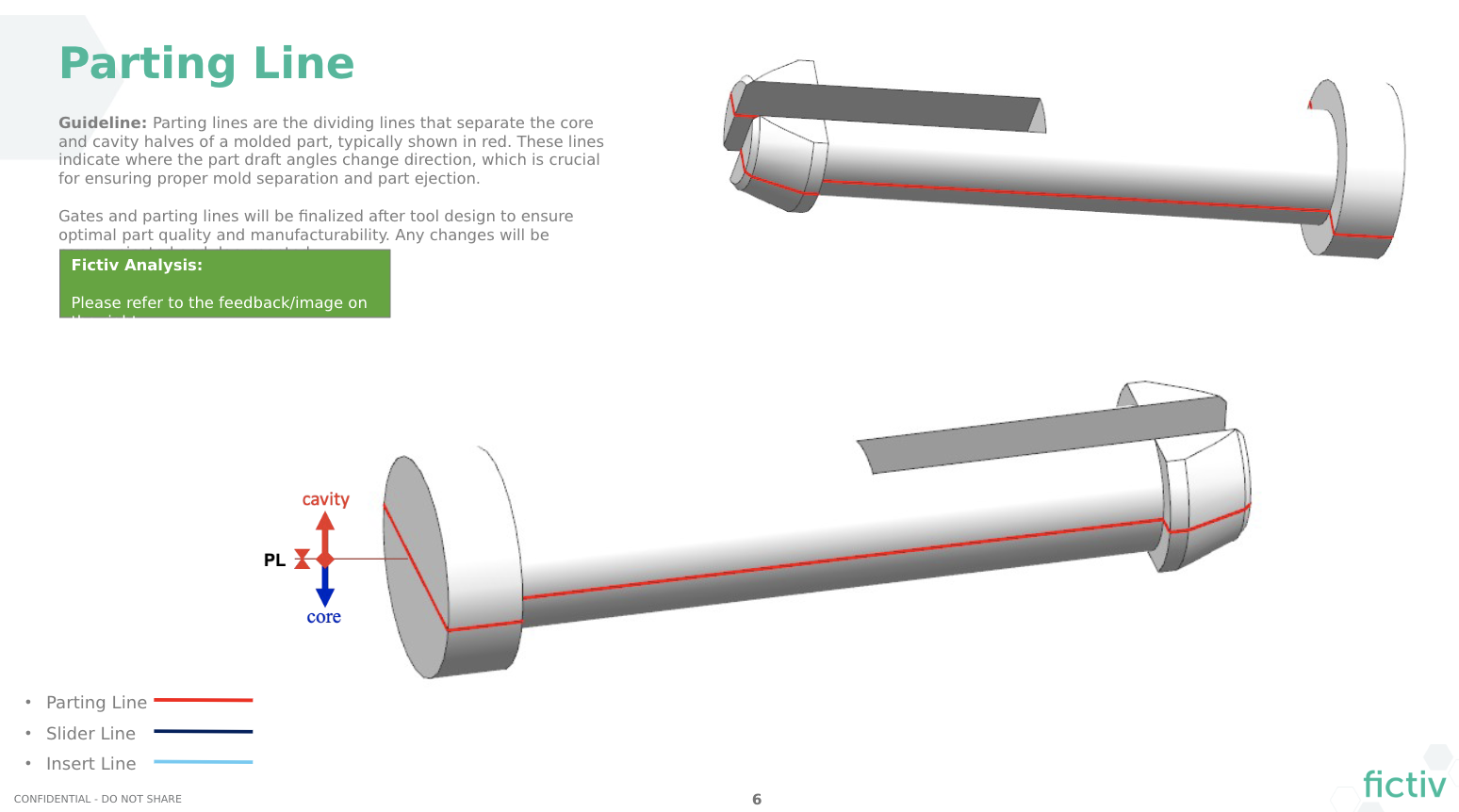

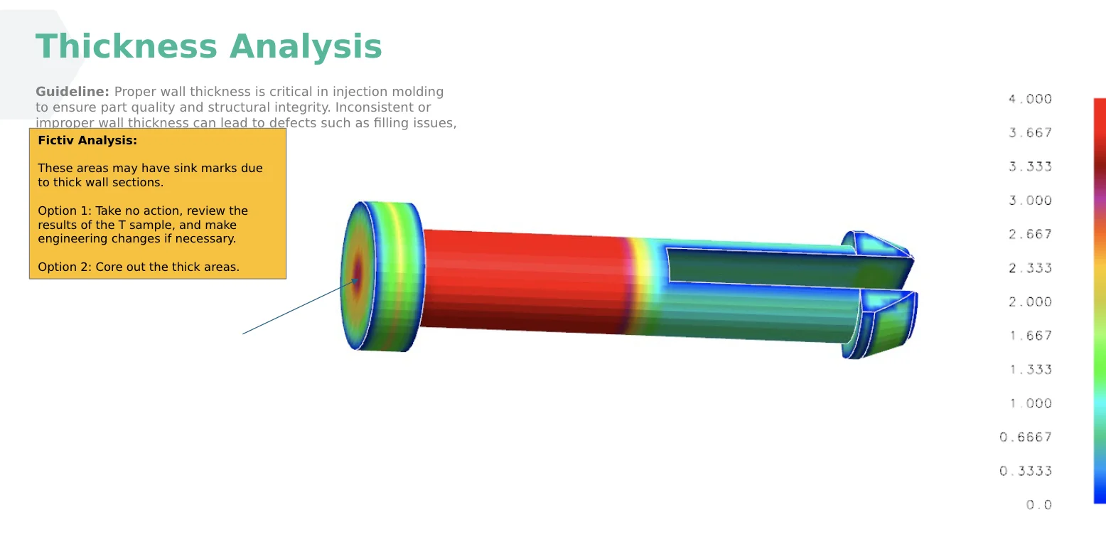

For the hinge pin, maintaining the nominal thickness proved more difficult. I had to add material to stiffen the pin snap, making it thicker in that area. I suggested adding a heavier texture to the outer head of the pin to hide the sink.
This fix became a challenge due to the way the draft was split, creating a parting line in the middle that was visible on the relatively flat outer surface. A heavier matte texture could hide the sink, but may cause drag marks if the draft wasn’t increased.
Thickness analysis of a snap-fit pin part.
Parting lines for a snap-fit pin part.

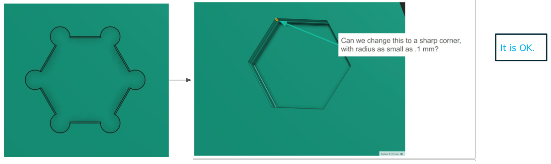

For the hex recess, I removed the corner core-outs for CNC machining and changed them to simple, sharper corners, while maintaining proper clearance for a hex bit. If 3D printing is used for the prototype, a detailed design review is helpful to make sure it is moldable.
Hex recess corner modification for production intent

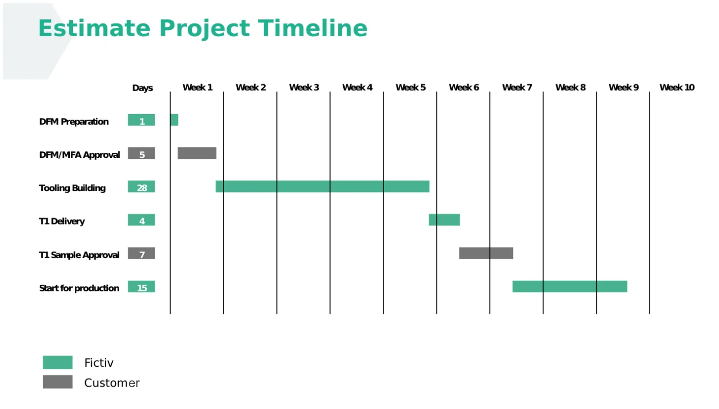

A simple Gantt chart in the DFM deck shows the mold and part production timeline. This can also be tracked closely in our Mold Library.
Project timeline for an insert-molding three-material part.
