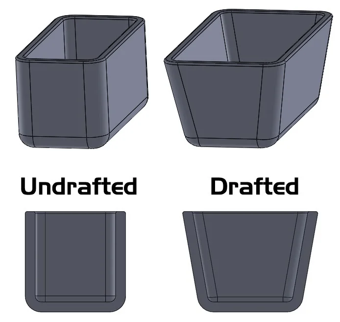

3D illustration of an undrafted and a drafted part
In injection molding, draft is the angle that you apply to the vertical walls of parts. Without adding draft to your design, parts won’t eject cleanly from the mold and are susceptible to damage. Draft can also decrease tool wear and reduce cooling times, both of which help to control costs.

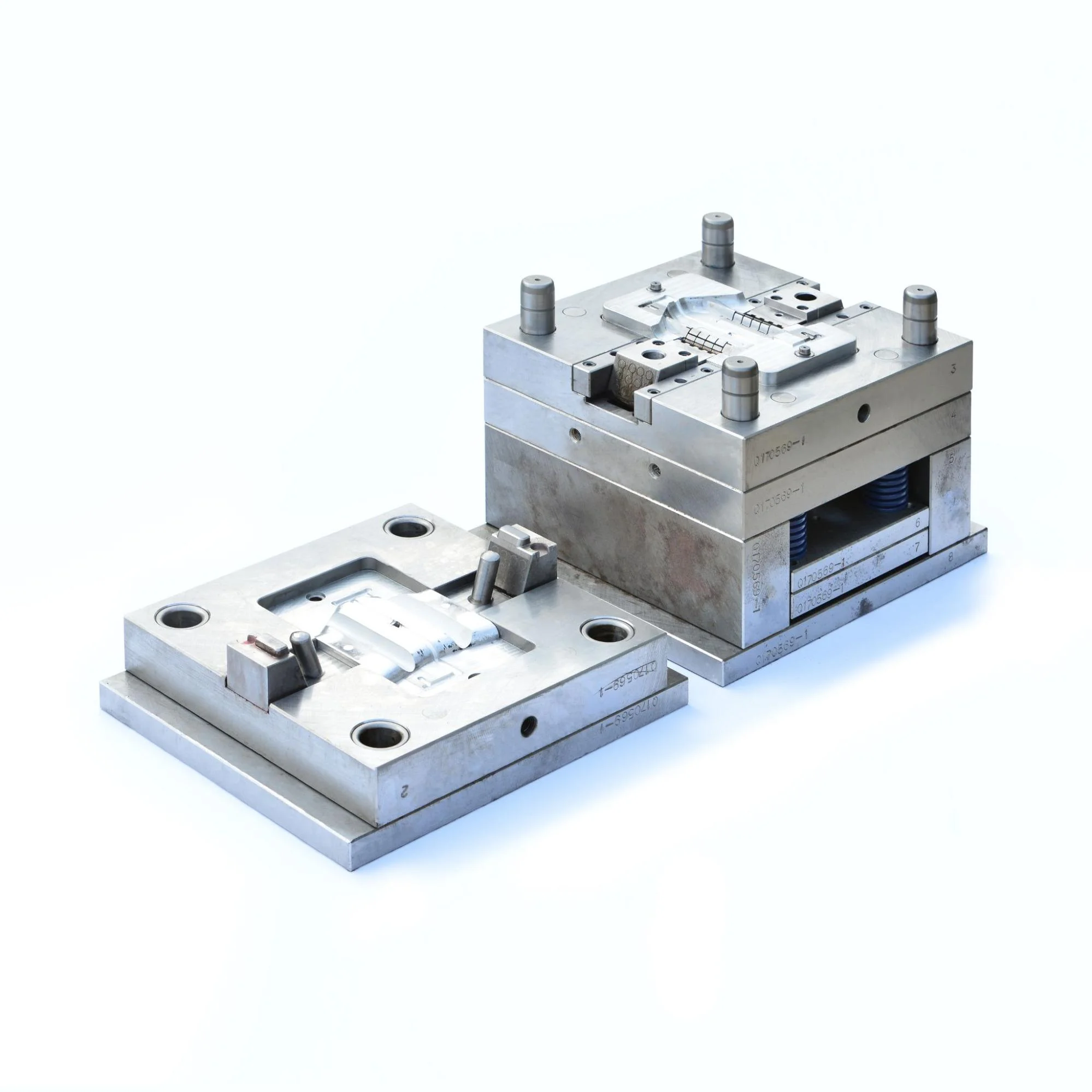

image of a steel injection mold
The proper placement of the mold’s core (A-side) and cavity (B-side) are also important to consider. Otherwise, the part may not stay in, or stick to, the half of the mold that contains the ejector system. For example, in the case of a rectangular part with four through-holes, drafting the holes toward the A-side could cause the parts to stick to the mold’s core rather than its cavity. A better approach would be to draft the holes toward the B-side so that the parts stick to the cavity, which is the half of the mold where the ejector system is located.
