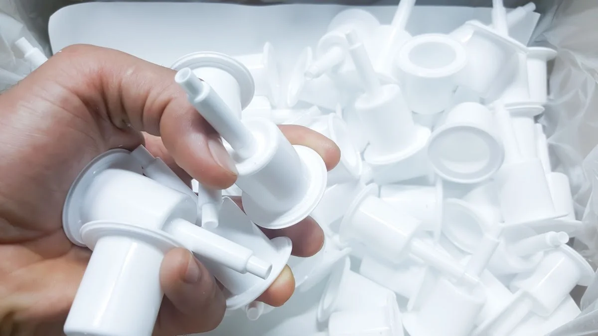

Plastic injection molding can apply a specific type of finish — described in terms of polish or texture — to molded parts, and many different polishes and textures can be achieved. The desired surface finish is applied toward the end of the mold-making process, and during plastic injection molding, the finish is transferred from the mold to the surface of the molded parts.
Injection molding surface finish
Injection molding can apply the desired surface finish to parts

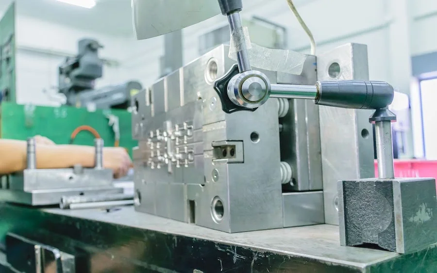

Polished Finishes

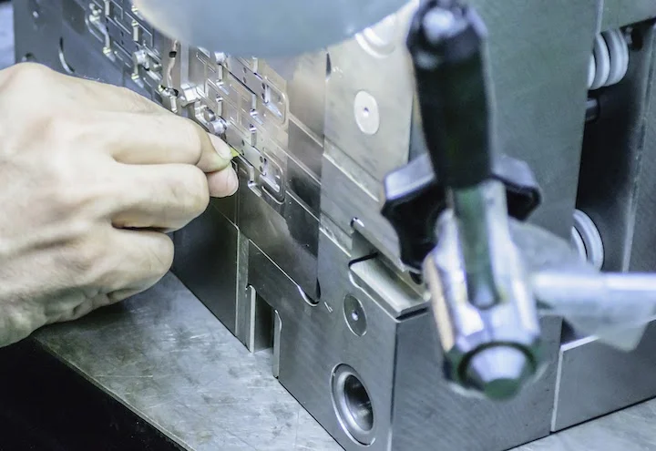

Injection molds are machined with CNC or EDM equipment, and when machining is complete, the mold core and cavity have milling marks or EDM marks. The two halves of the mold are then sanded and polished to remove these surface imperfections. Different finishing methods are used, but the industry standard for mold polishing comes from SPI. There are nine levels of standard polished finishes, and typically each type is done by hand by highly-skilled technicians.
SPI mold finish
Polished mold finishes require hand labor by skilled technicians

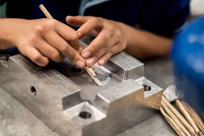

Semi-Glossy Finishes
SPI finishes B-1, B-2, and B-3 are the middle levels of polishing. They produce a semi-glossy finish using 600-grit, 400-grit, or 320-grit sandpaper, respectively. Surface finishing is achieved with various-sized filing tools and requires sanding back and forth across surfaces. Compared to the SPI A-level finishes, more lines are evident because of this sanding motion.
This surface finish chart below describes these SPI B-level standards, their finished methods, and surface roughness measurements.
SPI StandardDescriptionFinishing MethodSurface Roughness Ra (μm)
B-1Semi-Glossy – Fine600 Grit Paper0.05 to 0.10
B-2Semi-Glossy – Medium400 Grit Paper0.10 to 0.15
B-3Semi-Glossy – Coarse320 Grit Paper0.28 to 0.32
Some mold features, such as those that are designed to accommodate thin, deep ribs or small bosses, are more challenging to polish because they’re smaller than a file can reach. Typically, these features are on non-visual surfaces on the cavity side of the tool. There are ways to construct the tooling, such as by using sub-inserts, so that these features can be reached for polishing — for best results, you should discuss this during the DFM stage of mold construction.

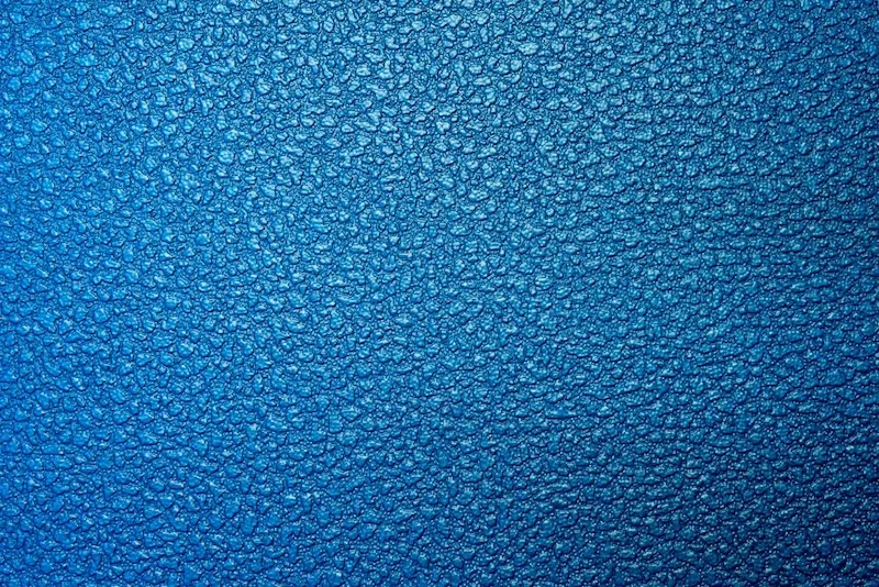

Textured Finishes
Injection molded parts can also have a textured finish instead of a polished finish. There are hundreds of texture options, but three main texture systems:
  • SPI and Mold Tech textures (United States)
  • VDI textures (European)
  • YS textures (Asian)
In addition to light, medium, and heavy textures, options include simulated wood or leather grain and checkerboards or diamond patterns. Fictiv typically uses blasting, chemical etching, or mirror EDM to produce mold textures; however, laser etching and standard sinker EDM are also used by the industry.
