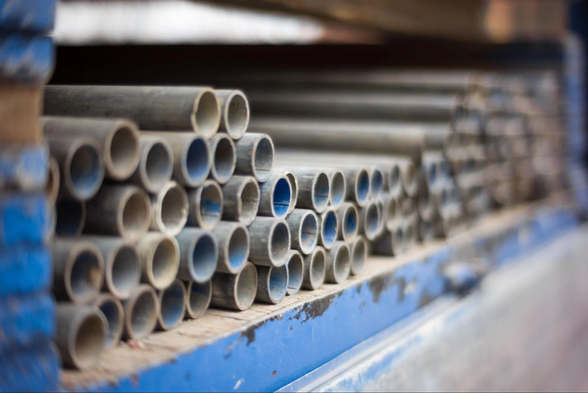

Steel comes in many forms: sheet metal, plates, bars and beams of various geometries, pipes, and of course, the solid stock material used when CNC machining steel. Steel is used for so many applications and by so many industries that it makes sense for there to be many different types of steel. But what’s the difference between stainless and low carbon steel? Free machining and tool steel? In this article, you’ll learn about the many machining steel grades, their properties, and how to CNC machine steel successfully.

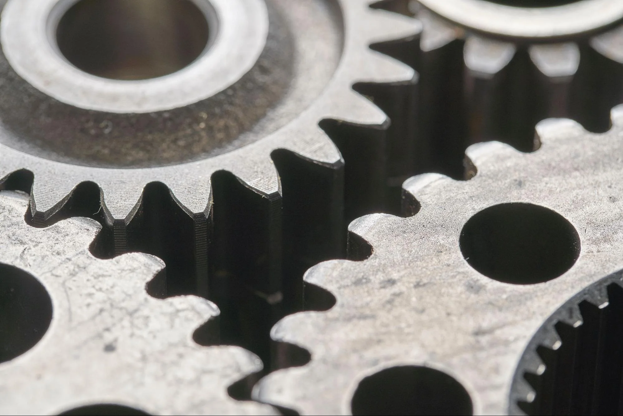

The main alloying element of the steel is referred to by the first digit in the four-digit grade. For example, any 1xxx steel, like 1018, is going to have carbon as the main alloying element. 1018 steel has 0.14 – 0.20% carbon and small amounts of phosphorus and sulfur, along with manganese. This general-purpose alloy is commonly used to machine spacers, shafts, gears, and pins.
![metal gears](https://www.fictiv.com/wp-content/uploads/2021/08/gears.jpg)
Free machining grades of carbon steel are resulfurized and rephosphorized, which causes the chips to break off into smaller pieces. This prevents long or large chips from becoming entangled with the tool as it cuts. Free machining steel can lead to faster machining times but may decrease ductility and impact resistance.

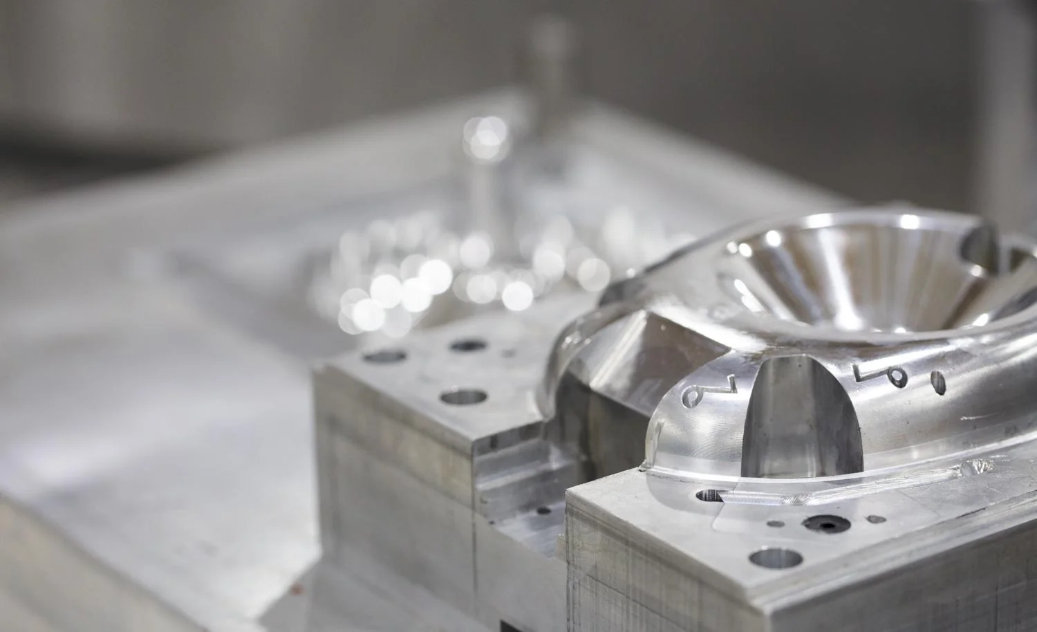

Tool steel is used to make tools for various manufacturing processes, including die-casting, injection molding, stamping, and cutting. There are many different alloys of tool steel tailored for different applications, but they’re all known for their hardness. Each can stand up to wear and tear over many uses (a steel mold for injection molding can stand up to a million shots of material or more) and have high-temperature resistance.
One prevalent application of tool steel is injection molding tooling, which is CNC machined from hardened steel to produce the highest quality production parts. H13 steel is often chosen for its good thermal fatigue properties — its strength and hardness can withstand long exposures to extreme temperatures. H13 tooling is well-suited for advanced injection molding materials with high melting temperatures because it provides a longer tooling life than other steels – 500,000 to 1 million shots. Meanwhile, S136 is stainless steel that has a tooling life of over one million shots. This material can be polished to the highest level and is used for specialty applications when parts require high optical clarity.

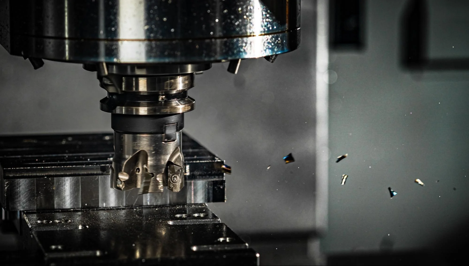

Due to the hardness of the material, machining steel takes longer than other, softer materials like aluminum or brass. You need to use the correct machine settings to optimize the quality of the machining and minimize the wear on the tools. Practically, that means slower spindle speeds and feed rates to protect your part and tooling.
![shell mill cutting chips from block of metal](https://www.fictiv.com/wp-content/uploads/2021/06/CNC-shell-mill.jpg)
Even if you’re not doing the machining itself, you should still evaluate the steel grades suited to your project not only for hardness and strength but also to account for differences in machinability. For example, stainless steel will take about twice as long to machine as carbon steel. When deciding between different grades, you also want to consider which properties are the highest priority, and which steel alloys are readily available. Commonly used grades, such as 304 or 316 stainless steel, are available in a wider range of stock sizes and take less time to find and source.
