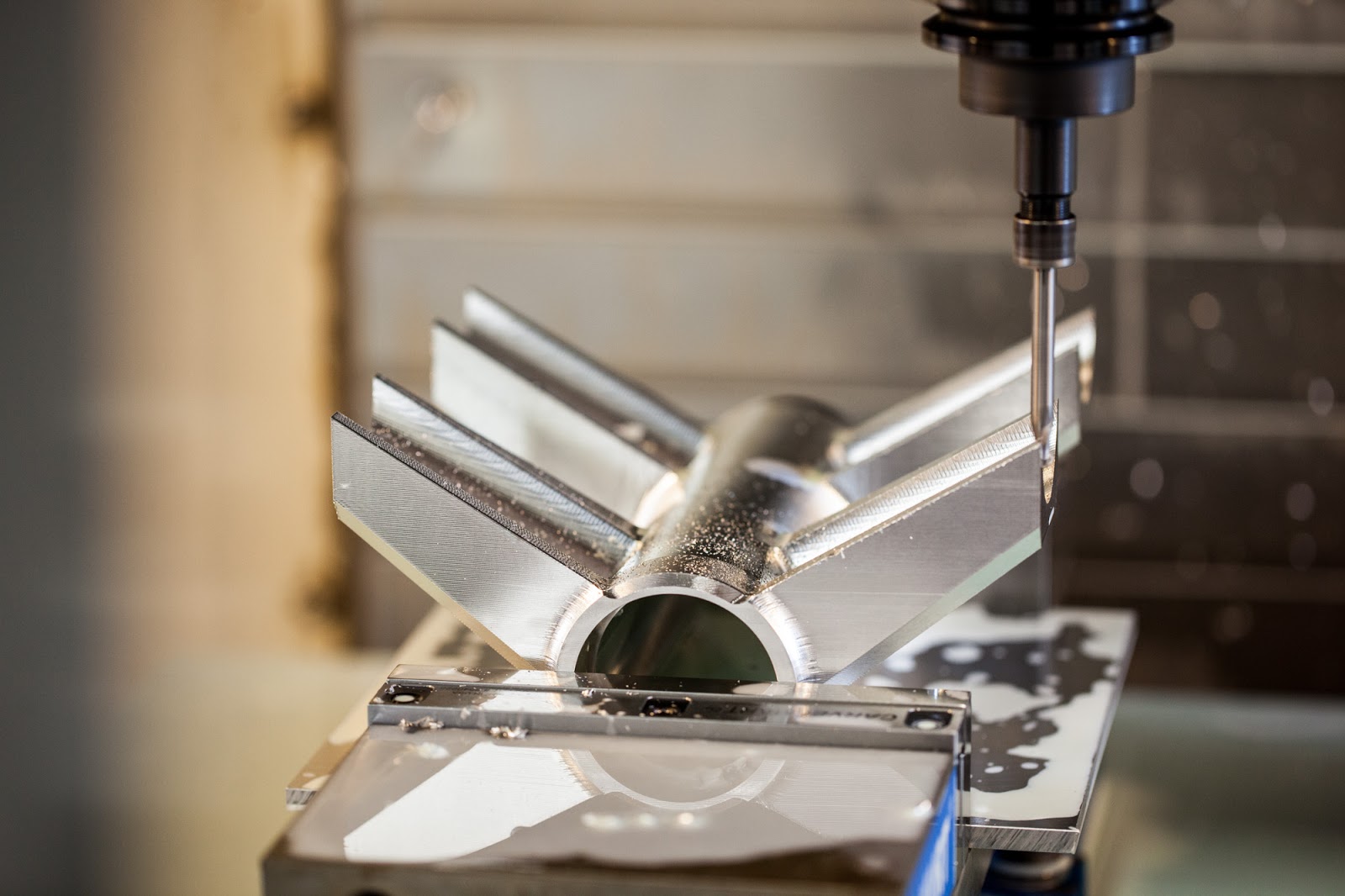

piece of metal being machined on CNC machine
A CNC mill can produce highly precise and complex parts
CNC milling involves the machine bed, where the workpiece is held securely in place. There is also a cutting tool that spins rapidly. The movement of this tool and machine bed depends on the number of axes of movement your machine has, but for a common 3-axis machine, the bed moves back and forth and left to right, while the tool moves up and down.

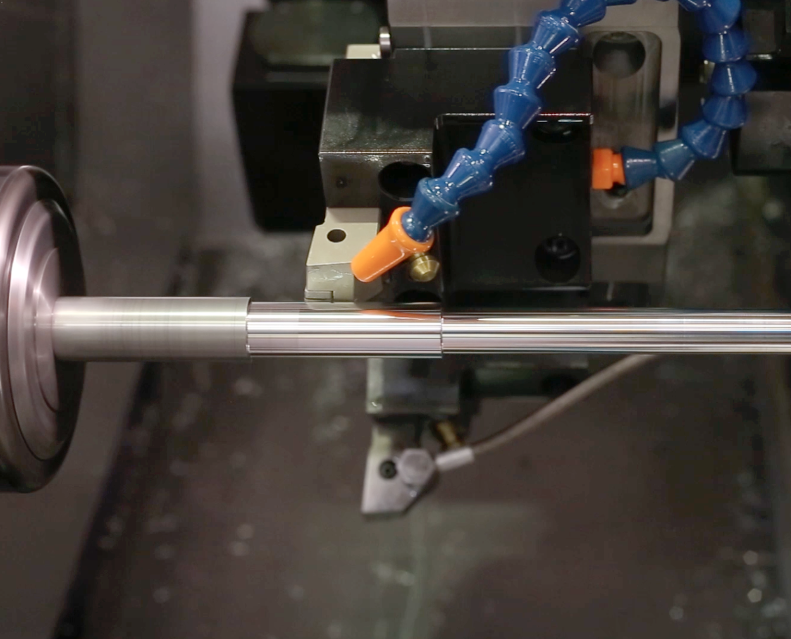

metal rod being turned on a lathe with air coolant feed
Turning is ideal for round or cylindrical parts that need to be highly precise
CNC turning is used mostly for parts that are axially symmetric. The workpiece spins rapidly while a cutting tool moves side to side and front to back in the machine. Machining parts using a lathe rather than a mill can be faster and have a lower cost per unit.
