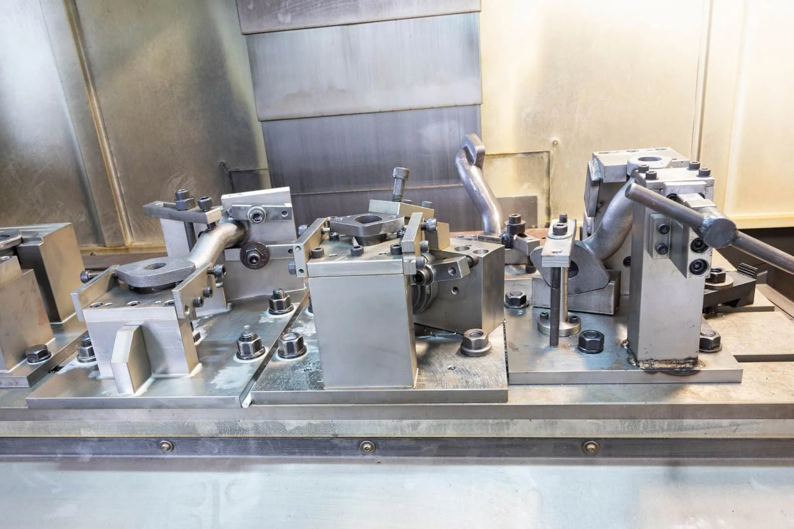

CNC machining fixturing can be simple or complex
A fixture is a device used to hold your workpiece in place while it’s machined. A fixture needs to be rigid, precise, and able to withstand the heat generated and coolant or oils used during machining. Rigid, accurate, and repeatable part holding is key to ensuring precision and accuracy of CNC machined parts. A fixture is also critical for positioning a part’s coordinate system prior to CNC machining. In addition, a fixture is used to reduce labor when loading and unloading a workpiece. Fixtures are especially important and useful for more complex machining processes like milling, turning, grinding, shaping, boring and planing.

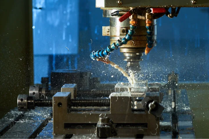

  1. Milling Vise
The tried and true milling vise, also known as a machinist vise, is arguably the most commonly utilized fixturing device used today. In use for over 70 years, Kurt vices are popular and reliable solutions for workpiece holding. This type of vise works by clamping the part with a relocatable (swivel, translational) jaw that applies pressure to firmly hold the part in place. A milling vise offers good precision, accuracy and repeatability.
