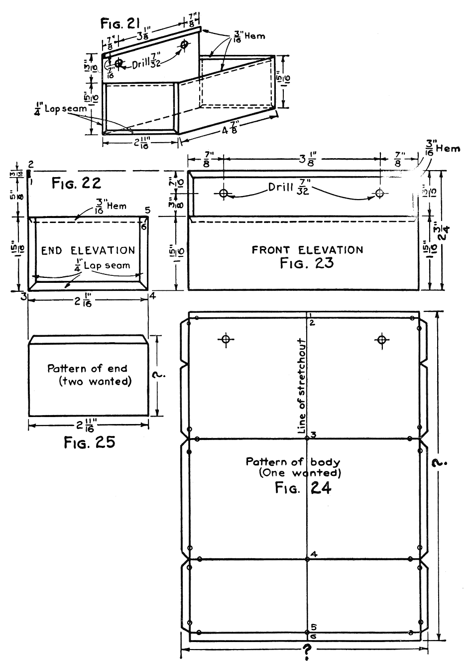

One of the easiest places to see this is in the design of the basic sheet metal box. With three sides typically formed from a single piece, the ends of the box could be difficult to align correctly with an open design. Instead, on the typical box, there will be tabs coming out from the main piece that are bent over (“braking”, in our parlance) to hold the end sheets in place. Whether the resulting assembly is spot-welded, riveted or screwed together, these tabs accurately locate the pieces during the operation, removing the necessity of additional fixtures or measurement during assembly. This doesn’t just make it easier to manufacture—these tabs increase accuracy in assembly, remove the added expense of tooling creation to make fixtures, and reduce assembly time.

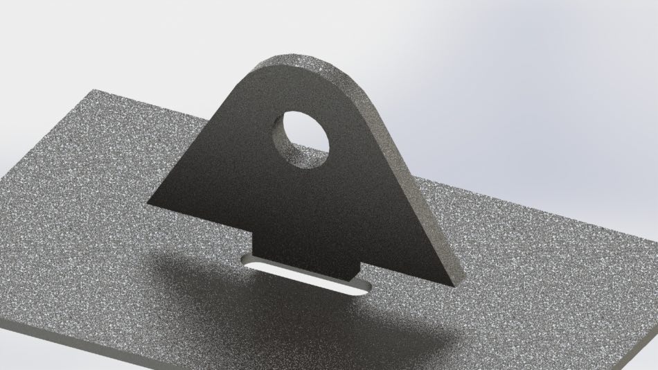

Self-Fixturing for Welding

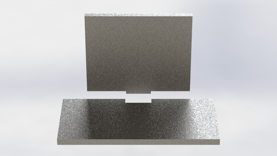

Similarly, with other types of welding, creating self-fixturing parts can lead to significant cost savings. For example, imagine the fairly common situation in which two pieces of steel plate are welded together into a bracket, with one piece of steel plate mounting at a right angle to the other in the center of the plate—a fairly common scenario for all types of industrial design, such as i-beam connections and cable mounts in cranes. With just these two pieces, the first plate can sit flat, but the second plate needs to be fixtured to the right location in x and y, as well as the correct angle. Is there an easier way?

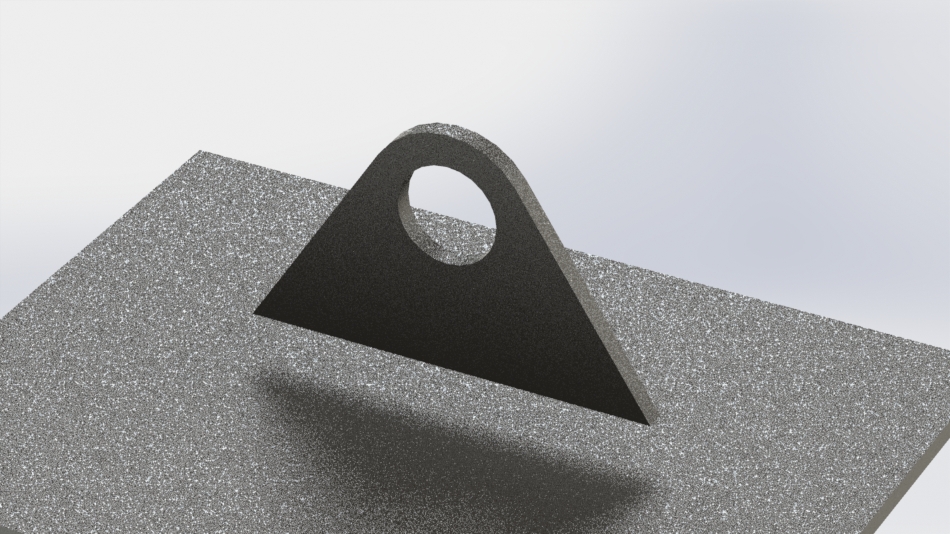

Of course! The simplest solution here is to create a small tab on the second piece that fits into a slot on the primary piece. This will locate it in both x and y, and then a right-angle magnet can hold the third axis.
And this same idea can hold true for even simpler assemblies, such as when two plates are welded together at a ninety along their edges. Though one direction (either x or y) is automatically located because of the edge, you can further reduce the remaining fixturing by again having a tab along the edge with a corresponding cut out on the other piece, so that both x and y are located, again requiring only that the angle be fixtured during the weld.

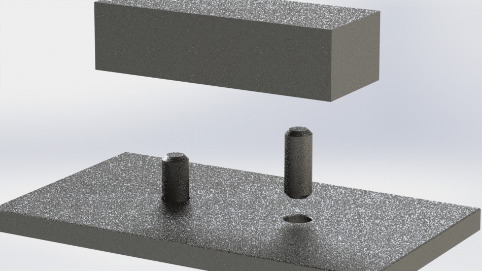

The benefits of self-location aren’t just for welded or sheet metal parts. A common method of self-locating parts in machine assemblies is to use dowel pins, which can then either be used strictly as a locating feature to hold parts in the correct place during assembly with screws or can be used on their own for press-fit assembly. Just remember: If the dowels are used strictly for locating, you’ll need the mating holes to be slightly oversized (as much as possible, given the tolerance for the location of the mating piece, but at least 0.001 inches); if the dowel will be used for press-fit assembly, then the holes will need to be undersized to ensure interference (typically 0.0005”, with more here).
While pins are great, it’s important to provide sufficient chamfer on both ends of the dowel, so that the parts come together easily—no one likes to have to align parts perfectly before being able to press the parts together, and chamfers provide allowable tolerance in alignment, reducing time spent in assembly.

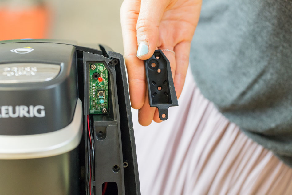

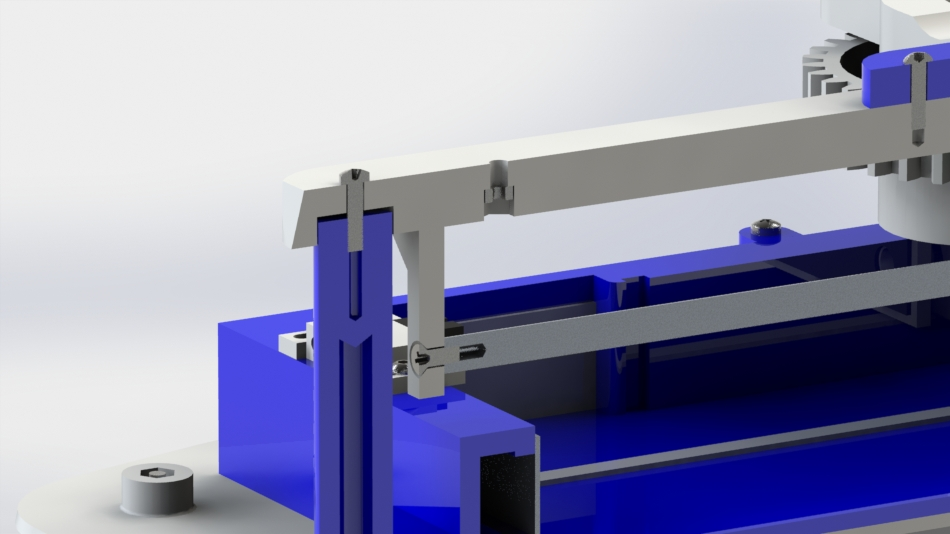

And speaking of screwing parts together, whenever there’s freedom in the design for it, always plan on having the parts self-fixture (hold themselves in the correct location) during the application of the screws. A simple way to do this is to have a back-side bore that allows the screw boss to act as a locating pin, so that all the assembler needs to do is set the piece onto the base, move it around till the bore and bosses fall into place, and then apply the screws. Simple, clean, and guaranteed to make you a hero on the manufacturing floor—and the cost savings will make you a hero with the bean counters upstairs.
