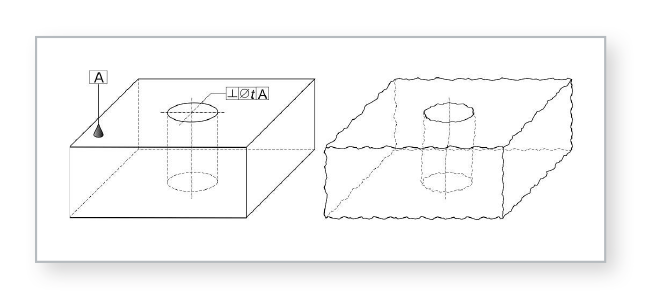

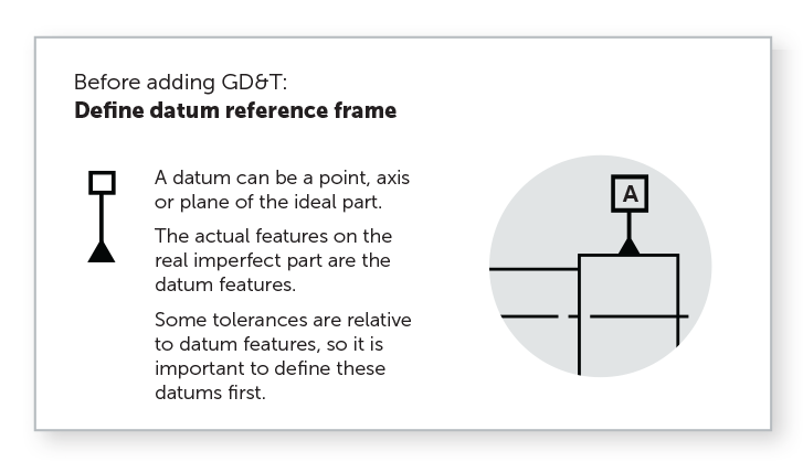

A datum is an ideally or theoretically exact point, axis, or plane used as a reference for measuring and manufacturing part features.
In design engineering, the Datum Reference Frame (DRF) is a three-dimensional Cartesian coordinate system used to define the part’s tolerances, tolerance symbols, and geometric features. It’s arguably the most important concept in GD&T and has a significant impact on the part manufacturability and inspectability.
The DRF acts as the “skeleton” of the geometric system: it’s the foundational framework upon which all geometric specifications are built. It serves as the reference from which all dimensions and tolerances are defined. Ideally, the DRF should reflect how the part is assembled in the real world.
Example of a datum notation on a 2D drawing.
A DRF establishes a part’s Six Degrees of Freedom (6DoF or DOF): the freedom of movement a rigid object has in 3D space, including three linear translations (forward/backward, up/down, left/right) and three rotations (about the X, Y, and Z axes). To accurately design, manufacture, and verify parts, these degrees of freedom must be constrained.
By mating parts to the Datum Reference Frame, consistent DOF measurements, processing, and calculations can be performed.
There’s an important distinction between datums and datum features:
Datum vs. Datum Feature
TermDefinitionKey Point
DatumAn ideal point, axis, or plane used to establish the Datum Reference Frame (DRF).Ideal and flawless; used as the reference for geometric control.
Datum FeatureThe actual, physical feature on the part (e.g., hole, face, slot) selected to establish a datum.Real-world features with inherent variation and imperfections.
Datums (left) vs. datum features (right). Datums are theoretical and perfect, while datum features are real and thus imperfect.
Datums left vs datum features right Datums are theoretical and perfect while datum features are real and thus imperfect

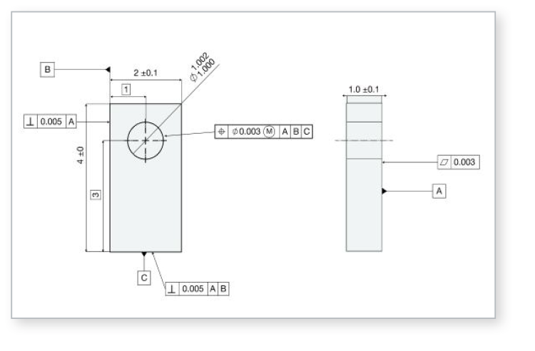

When defining a part, an engineer will identify the datum features that are most important to the functional requirements of the design—usually, the features that interface with other components in an assembly. Datum features referenced in a Feature Control Frame (a frame defining the conditions and tolerances of a specified feature) will, in order of precedence, orient the part to the Datum Reference Frame.
How to read a feature control frame with datums for GD&T.

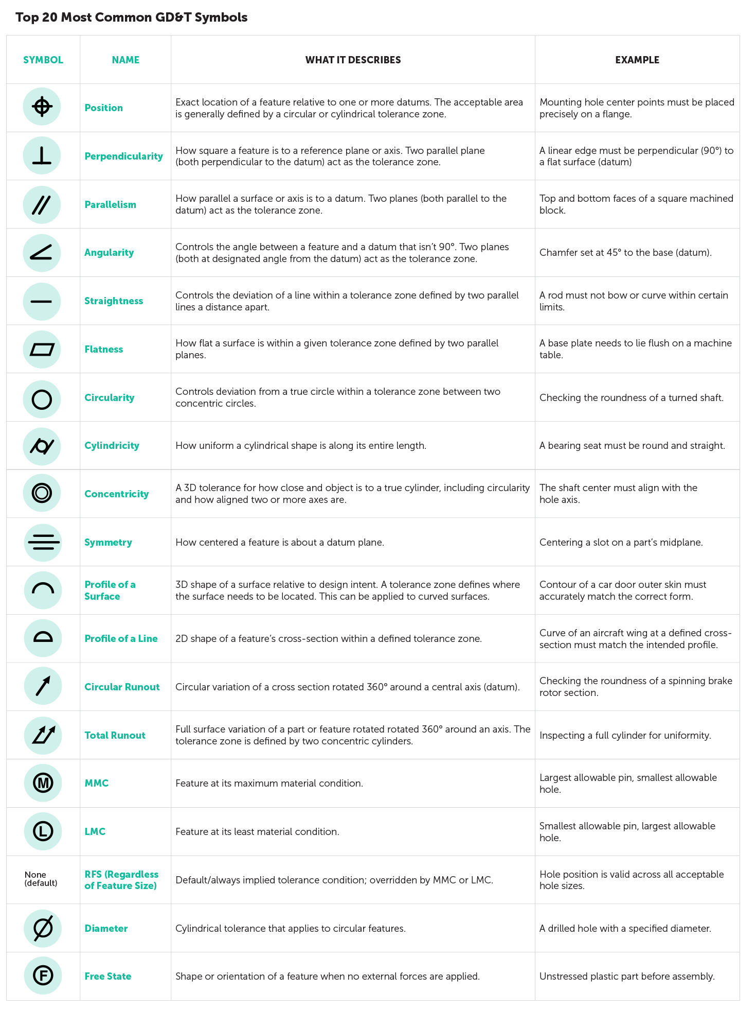

Here’s a quick cheat sheet for some of the most common GD&T symbols, their meanings, and a practical example of each:
Top 20 Most Common GD&T Symbols
GD&T symbols chart showing meanings with examples

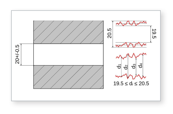

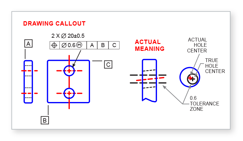

In the illustration below, the MMC (Ⓜ) of the hole is 19.5 mm, and the LMC (Ⓛ) is 20.5 mm.
Allowable deviation of a 20 mm hole with MMC 19.5 mm and LMC 20.5 mm.
Allowable deviation of a 20 mm hole with MMC 195 mm and LMC 205 mm
Consider a hole specified at diameter (⌀) 20 ±0.5 mm with a position tolerance of 0.6 mm at MMC. This means the tightest positional tolerance (0.6 mm) applies when the hole is at its MMC size of 19.5 mm. As the hole increases in size (moving away from MMC), it gains bonus tolerance equal to the amount it departs from 19.5 mm.
If a hole measures 20.0 mm, it is 0.5 mm larger than the MMC, so the allowable position tolerance increases to 1.1 mm (0.6 mm + 0.5 mm). This is how bonus tolerance allows greater flexibility without compromising function.
GD&T example showing a 2D drawing with a 20 mm hole with 0.6 mm positional tolerance.
2D drawing showing a 20 mm hole with 06 mm positional tolerance

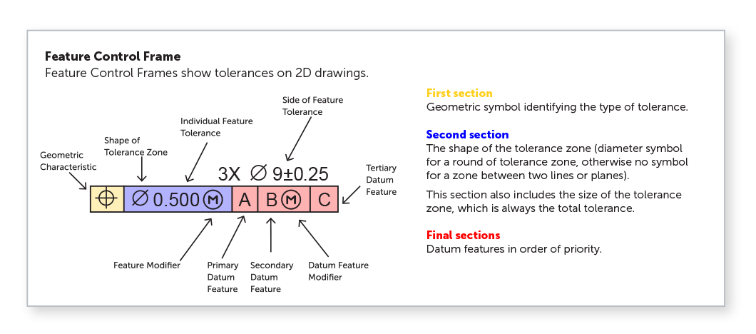

GD&T Feature Control Frames
A feature control frame is a callout box that states the requirements or instructions for a specified feature.
(In other words, the feature control frame is a frame that controls features. It’s nice when things are easy.)
Each feature control frame contains only one message, so if a feature requires two messages, it requires two feature control frames.
Feature control frame GD&T example.
Feature control frame example

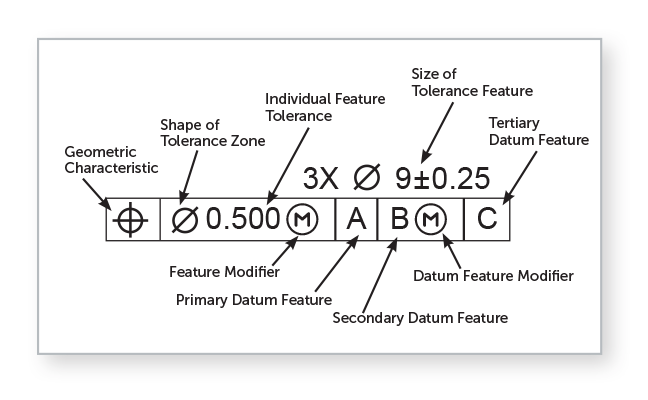

GD&T Feature Control Frame: First Compartment
The first compartment of a feature control frame contains a geometric characteristic symbol, which defines the type of control being applied to the feature. Only one symbol can be placed in a feature control frame. If a feature has multiple requirements, they must be specified using separate feature control frames or a composite tolerance.
GD&T Feature Control Frame: Second Compartment
The second compartment of a feature control frame contains the feature’s total geometric tolerance. This tolerance is expressed as a single value—never as a plus/minus range.
If the feature tolerance is preceded by the diameter symbol (⌀), the tolerance zone is understood to be cylindrical. This is commonly used for controlling the position of holes. If there is no symbol preceding the tolerance value, the default tolerance zone is defined by two parallel planes. This type of zone is typically used for features like slots or the profile of a surface.
After the feature tolerance in a feature control frame, a material condition modifier—such as Maximum Material Condition (MMC) or Least Material Condition (LMC)—may be specified for a feature of size, like a hole. If no modifier is shown, the default is RFS (Regardless of Feature Size), but this is not included in the feature control frame. For features that are not features of size, such as a plane surface, material condition modifiers cannot be used.
GD&T Feature Control Frame: Final Compartments
The final compartments in the feature control frame contain the datum feature references, if needed. For example, form controls like flatness or straightness do not use datums, while location controls such as position typically require datum references.
While the letters used to identify datums (e.g., A, B, C) may suggest order, what matters is the sequence in the frame, which defines their order of precedence: primary, secondary, and tertiary, read left to right. Often, however, Datum A will be the primary datum, followed by B and C.

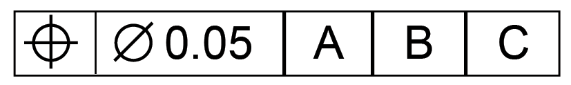

Feature Control Frame (FCF) showing 0.05 positional tolerance.
Feature Control Frame FCF showing 005 positional tolerance

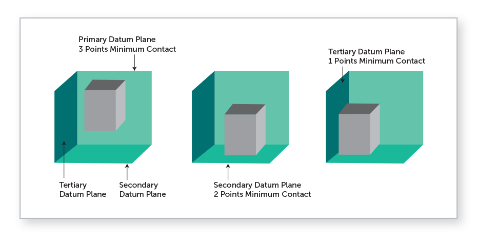

The primary datum is the first reference used to establish a part’s position and orientation. It’s the first feature contacted (meaning, the first surface of the part that physically touches and is constrained by a datum simulator), requiring a minimum of three points of contact. The secondary datum is the second feature contacted, with at least two points of contact, and the tertiary is the third feature contacted, with a minimum of one point.
Datum planes diagram (primary, secondary, and tertiary).
Datum planes primary secondary and tertiary
When all three datum features are contacted simultaneously, they establish three mutually perpendicular planes, forming the Datum Reference Frame (DRF). The DRF is not abstract—it is realized through datum simulators, physical tools and equipment used in manufacturing, inspection, and processing. These include devices like surface plates, collets, three-jaw chucks, and gage pins, which physically simulate the datum features of the part.
