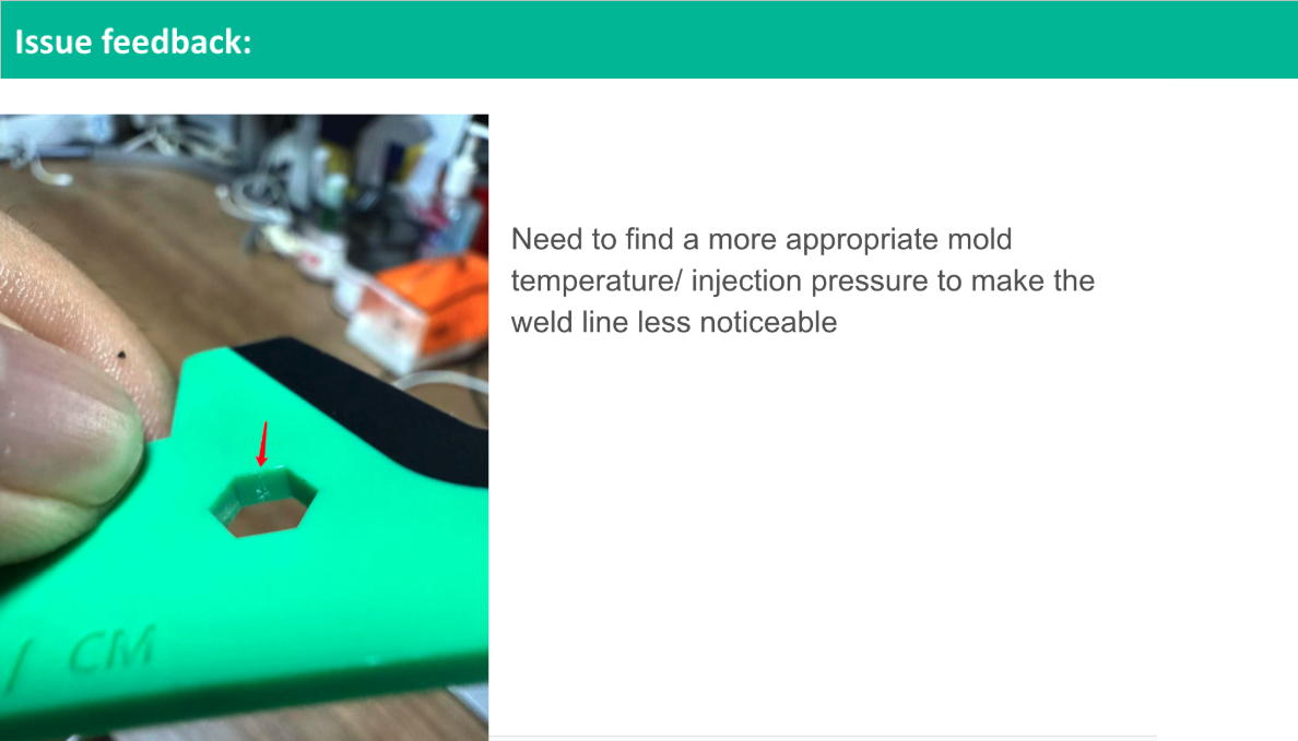

1. Weld Lines
Visible lines were found in the hex recess area, as the DFM warned. These were caused by the steel that formed this feature, which blocked the flow path of the material and caused the divided path to meet on the other side. While they were mostly cosmetic, we adjusted the injection temperature and pressure to reduce visibility of the weld lines.
Weld lines in the hex recess of multi-tool phone stand.
Quality inspection note and image showing weld lines

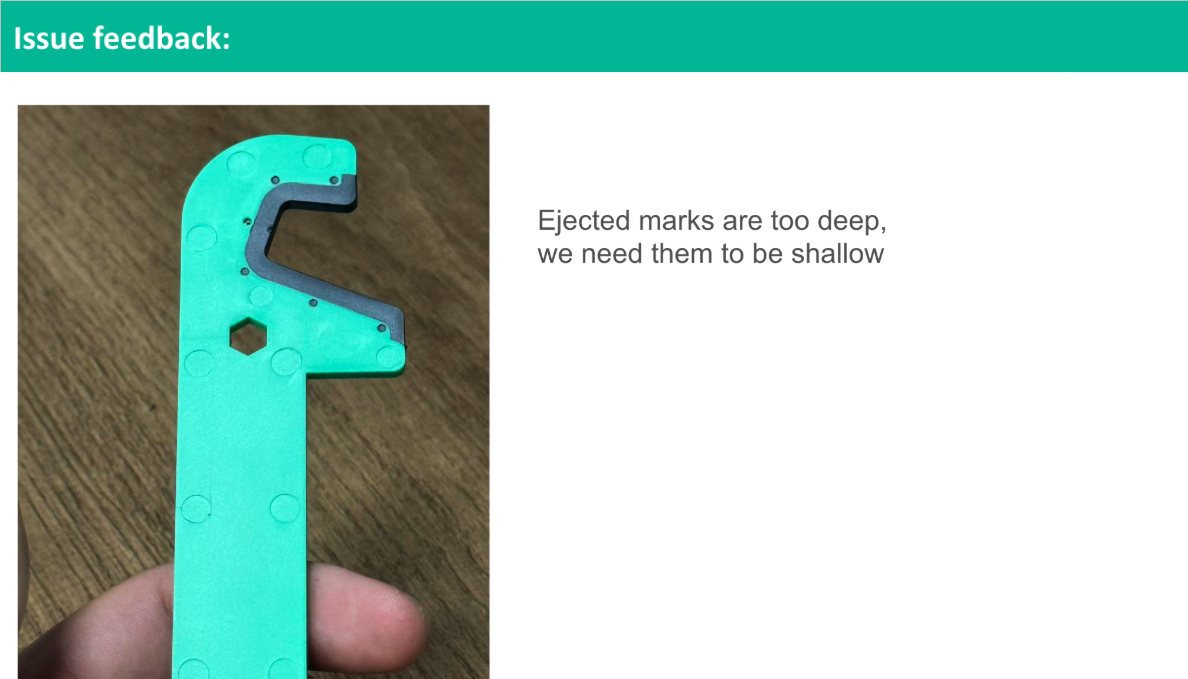

2. Ejector Pin Marks
Several ejector pins left noticeable witness marks on cosmetic surfaces, as expected from the DFM. However, the marks were too deep and noticeable, which required adjustment.
Ejector marks too deep

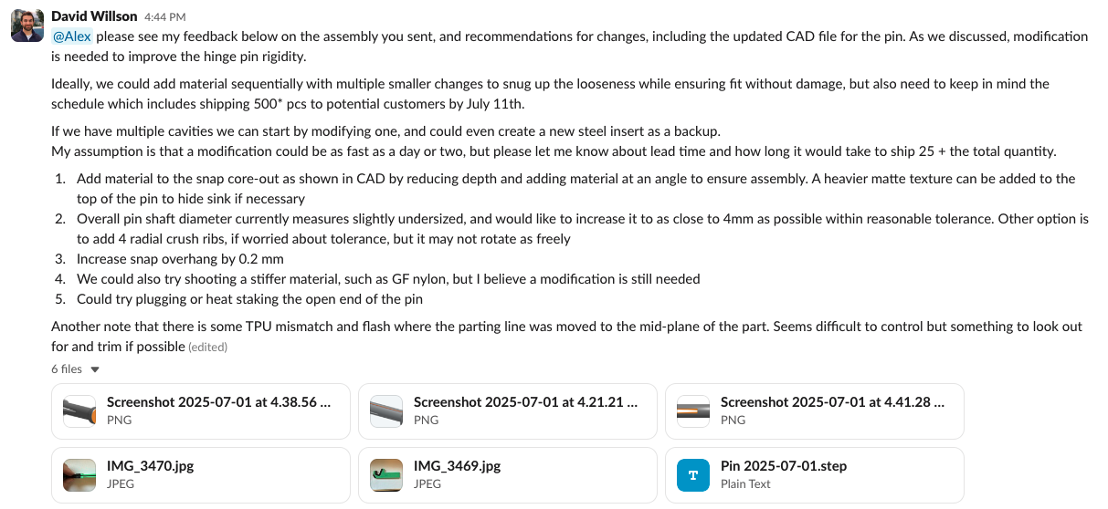

5. Hinge Looseness
The hinge rotated freely, but fit too loosely, which reduced product functionality and perceived quality. This was due to slight oversizing of the hinge bore and the intent of the design to allow for a steel-safe modification if necessary to tighten the fit.
I designed the hinge with clearance, in consideration of tolerances, to ensure that the parts would fit together across any variation outside of the nominal dimensions. This is usually a safer approach to tight-fitting components, because it’s easier and more cost-effective to add plastic by removing steel than the other way around.
Hinge looseness on T1 samples
Assembled product showing alignment shift due to hinge looseness
However, when the parts arrived, the fit was too loose. The hinge could be flexed open, and the pin could be disassembled too easily. It was a significant functional issue, but I had planned some ideas in advance about how to resolve it.
These issues were relayed to me by Alex Fu, TPM at our manufacturing partner in China, with whom I worked closely to resolve issues and coordinate the shipping of samples.
Initial pin snap flexibility
Image showing the flexibility and cored-out area of the original pin snap design

Slack feedback from Fictiv Manufacturing Engineer
T1 Feedback from Cameron Moore, General Manager of Fictiv China

  • Running the tool hotter to reduce weld lines.
  • Adjusting ejector pin heights to minimize marks.

Using tolerance analysis and snap fit design best practices, I modified the pin and hinge section to be stiffer and tighter.
One part of the solution was increasing the diameter of the pin shaft to snug up the fit, but I also needed to make it hold in place more securely. I increased the snap overhang slightly, and added material to the cored-out inner area to stiffen the flanges. As you see in the image below, I added material at an angle so that the flanges could still flex with enough displacement to clear the through-hole during assembly. These changes would also make it slightly harder to assemble, which I had to be conscious of.
Steel-safe pin revision to add material for a stronger snap
We also closed the gap between the “front” and “back” main parts by adding a slight amount of material with EDM, so that there would be less movement between them.

  • Weld lines were significantly less visible.
  • Ejector marks were minimal and acceptable.

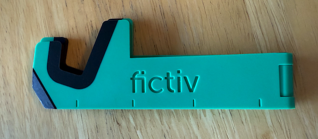

  • Tick marks were added with laser engraving upon a recommendation from our General Manager of Fictiv China, Cameron.
