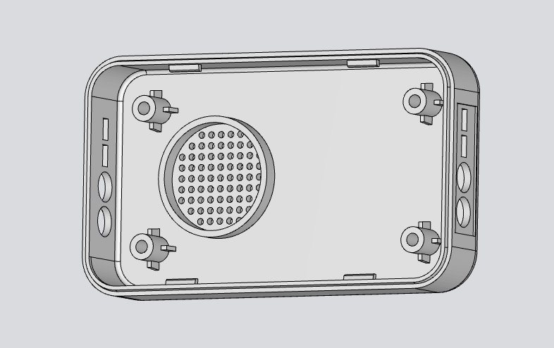

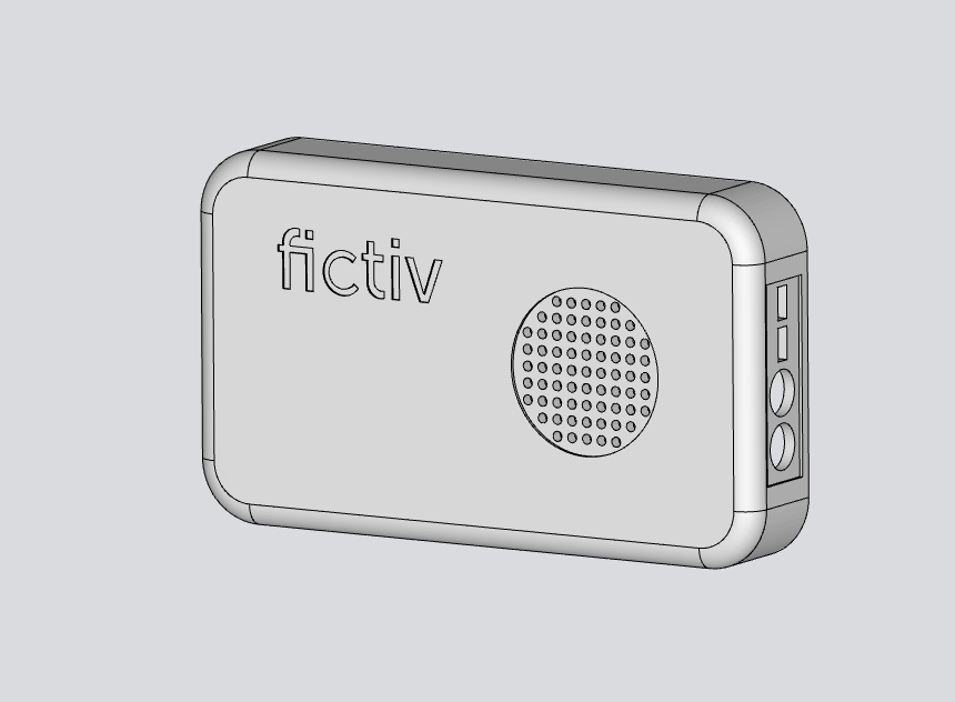

The example timeline in the gantt chart is based on the sample part shown below using a single cavity mold. The overall part size is 95.520 x 55.541 x 16.500 mm, made of a general-purpose PC/ABS plastic that’s black and has a matte SPI-B1 finish. The tooling will be made from P20 steel, with a cold runner and automatic side action.
With Fictiv, you can get T1 samples for an injection molded part like this in 12 business days, which is the timeline we’ll anchor around for the purposes of this article.

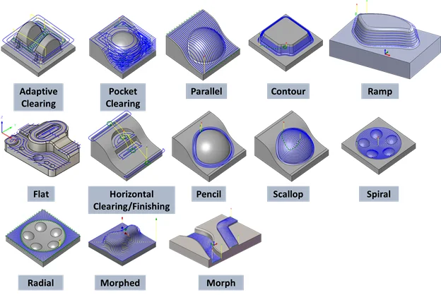

Finally, once the part design is confirmed, CNC programming begins, while the cooling lines and ejector pin holes are drilled. A CAM (computer-aided manufacturing) program is used to develop the G-code that will run the machine to make the mold parts. This milling process takes about two days and can begin once the DFM is approved and 3D CAD modeling starts.

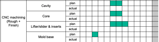

Once the material arrives, it’s time to start machining the mold. The core and cavity are machined from the prepared steel blocks, and the process starts with rough CNC machining using larger cutting tools to cut a rough outline.
Some manufacturers use less accurate (and therefore less expensive) machines to do this rough machining before moving the inserts to a high-precision machine. However, in recent years CNC machines have become more precise and less expensive, so the cost savings from using different machines to do rough and finishing cuts are now minimal.
Our manufacturing partners combine the rough and finish machining into one step and do both on the same machine, so they can make the cavity, core, and lifter/sliders in only a few days.
Machining itself for the Gantt chart sample part doesn’t take too long, less than one day. This method, combined with our program managers overseeing the schedule, also avoids time lost from the steel sitting in a queue waiting to be machined.
The copper blocks are also machined at the same time as the steel to ensure the EDM electrodes are available immediately to complete the mold.

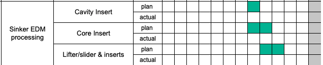

After CNC machining the finer details into the mold components, the final touches are made to the geometry. This requires electrical discharge machining (EDM) to achieve certain geometries that cannot be created with a CNC mill. For example, wire EDM is used to cut gear teeth with sharp internal corners and square holes.
Injection molding process gantt chart
Then the cavity, core, lifters, sliders, and inserts go through the sinker EDM process using the machined copper electrodes.
Sinker EDM creates super fine details like text or internal features that are difficult or impossible to make with a CNC machine.
For this sample part, the cavity does not require as much EDM as the core side, so once finished, the cavity side can move directly to polishing to save time while the core machining continues.

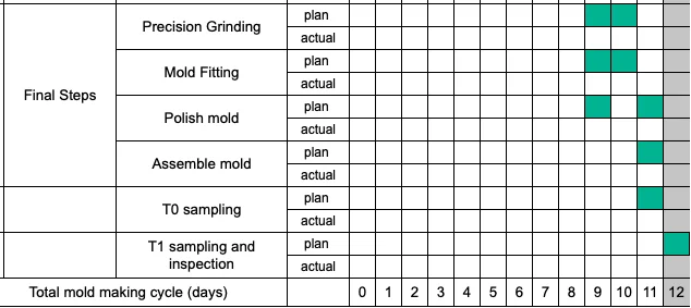

Step 5: Final Steps
Once the mold cavity, core, and other parts have been machined, it’s time to move onto the finishing touches, so we can actually manufacture some parts!
First, a fit check is in order. The two halves of the mold, the core, and cavity, are brought together to make sure they line up perfectly because any misalignment could result in flash or parting line mismatch. At the same time, some precision grinding is done on the mold parts to ensure that everything fits and meets the tight tolerances required.
After confirming that all the pieces fit well, the next step is to give the mold the right finish. This often means polishing it to a specified level of smoothness, or adding different textures when required. Whether or not the end goal is a polished surface finish, some polishing is always required to remove machining marks and provide a smooth surface upon which to add textures.
Finally, it’s time to assemble the mold and bring together the mold core and cavity, any sliders, lifters, or inserts, and the nuts and bolts that connect it all.
Assembly is usually done in the same 24 hours as the precision grinding, mold fitting, and polishing. Typically, Fictiv’s partners complete fitting by day and polishing by night.
Now, it’s time to shoot some plastic!
injection molding process gif
Source: pcbway

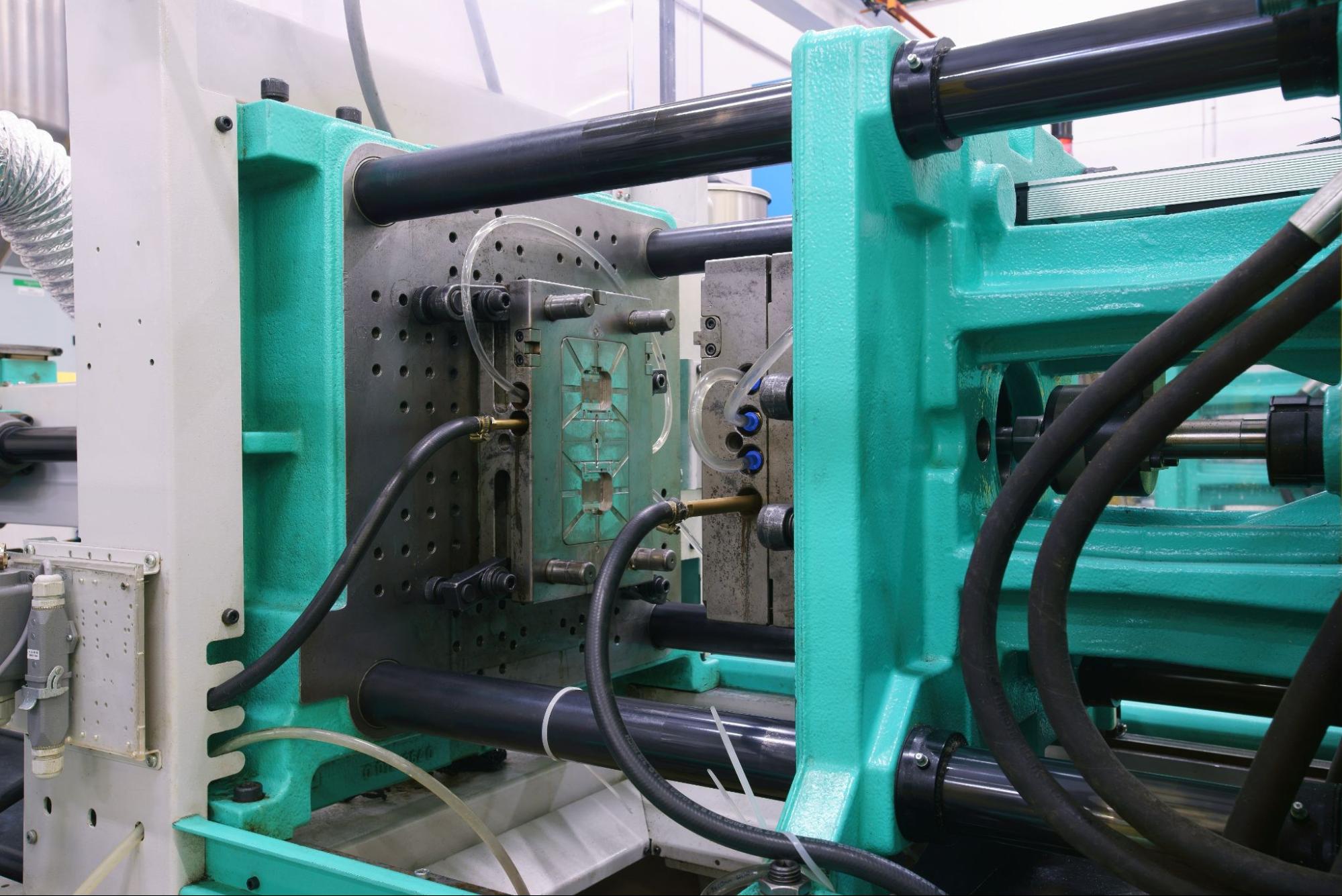

T0 Sampling
The first parts made with a mold are called T0 parts, and they show how the mold and all of the press parameters are working.
T0 parts are inspected for quality and indicate if any final adjustments to the mold or modifications in the press parameters are needed. For a small part, these tooling adjustments can be done in one day, while dialing in the mold for medium or larger parts takes two days.
Plastic parts produced by an injection molding machine
T1 Sampling
The next parts to be shot are the T1 parts, which are usually the first parts to be shared with the customer.
Once the mold is loaded in the press, Fictiv’s supplier quality engineers and manufacturing partners continually monitor the process to ensure it’s delivering the quality you need.
