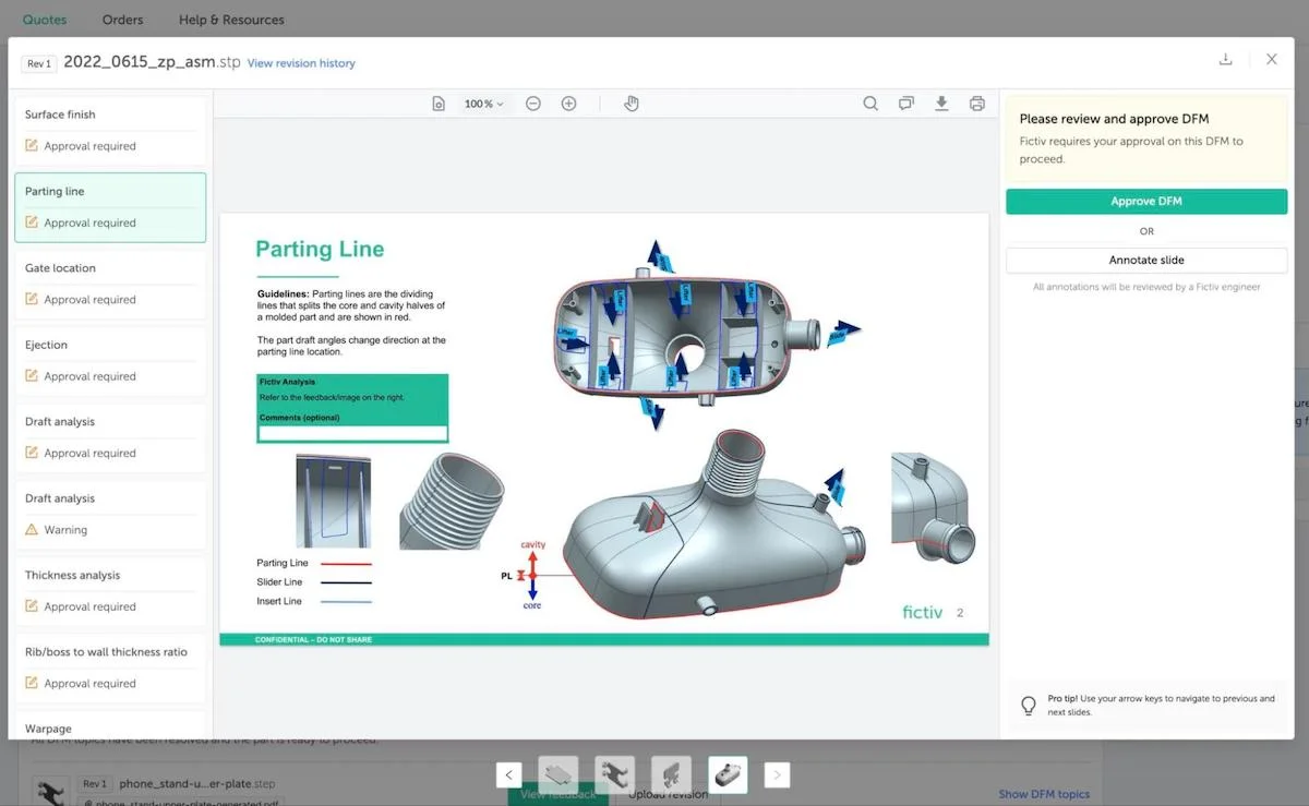

Injection Molding DFM
Fictiv provides expert DFM assistance for your injection molded parts

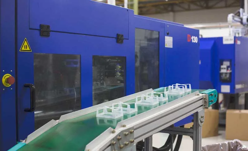

Injection molded parts can often be packaged and shipped straight to the customer, but in some cases, secondary operations are needed to remove excess material through trimming. Parts also can be painted, pad printed, or screen printed for decoration, or may require the manual insertion of metal inserts for screw bosses or compression limiters. In cases where tighter tolerances or unusual features are required, parts may need to be machined or sonically welded before they are shipped.
Injection molded parts can travel along a conveyor for packaging and subsequent shipment

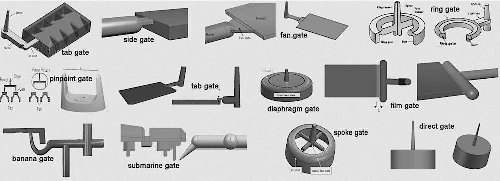

Gates
Finally, designers need to consider how the plastic material will flow into the part. This is known as the part’s gating plan. Because gates leave a small vestige of material, gating must be considered during part design. It’s best to gate the part where this leftover material will be the least obvious, while still providing proper filling during the molding cycle.
Injection molding gates
Injection molds can use different types of gates and more than one gate
