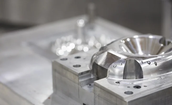

Proper maintenance can help to extend injection molding tooling life.

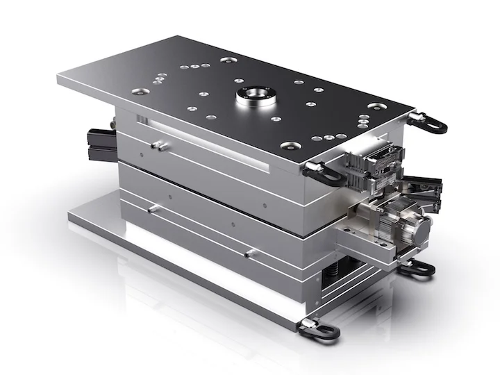

Predicting the life of a plastic injection mold depends on a number of factors.

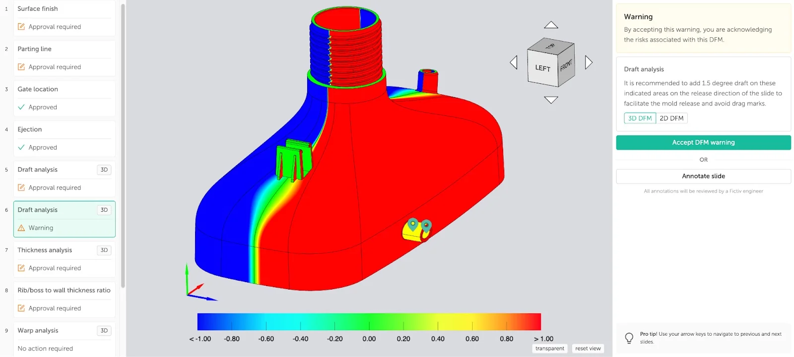

Fictiv’s enhanced DFM system helps designers to avoid injection molding defects

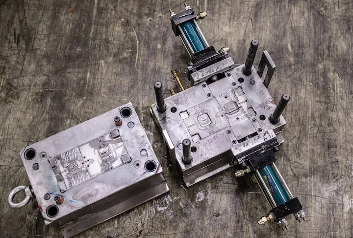

Fictiv provides quality plastic injection mold tooling and expert design assistance
