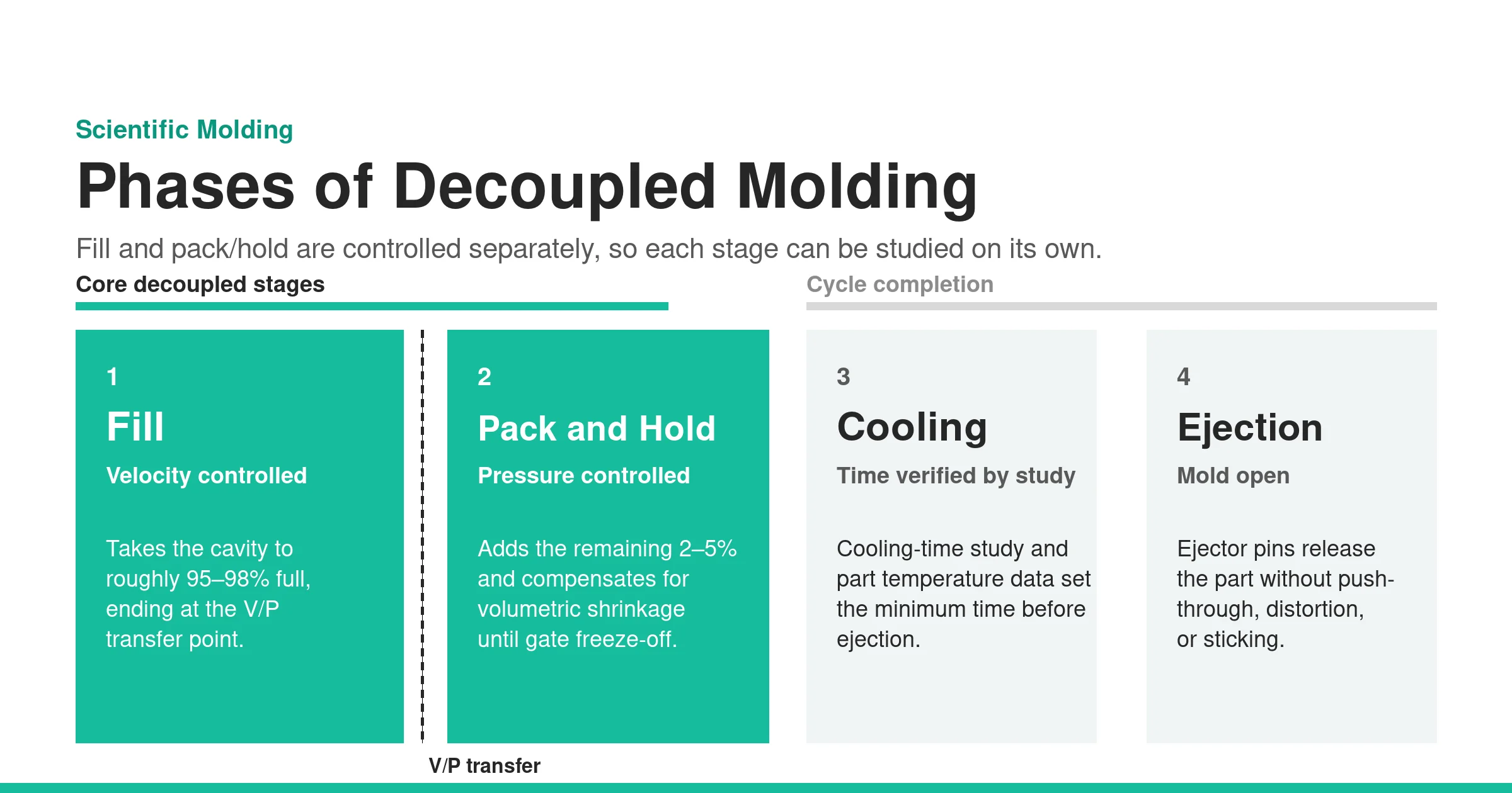

The Phases of Decoupled Molding
Conventional molding often blends fill and pack into a single pressure-limited stage or transfers late. Decoupled molding isolates the fill, pack, and hold stages so changes in one stage do not mask or distort behavior in the others. The core decoupled stages focus on polymer delivery, and cooling and part ejection complete the overall machine cycle:
  1. Fill Phase
Velocity-controlled and takes the cavity to roughly 95 to 98 percent full, ending at the velocity-to-pressure transfer point.
  1. Pack and Hold Phase
Pressure-controlled. It fills the remaining 2 to 5 percent of the mold and adds material to compensate for volumetric shrinkage as the material solidifies. Pack pressure, time, and profile are set and studied separately from filling.
  1. Cooling Stage
The part solidifies in the mold until it reaches sufficient structural rigidity for ejection. In scientific molding, technicians establish optimal cooling duration through a cooling-time study and direct part temperature measurements, validating thermal stability rather than relying strictly on unverified estimates.
  1. Mold Open and Ejection
The tool opens, and ejector pins release the finished component smoothly without pin push-through, distortion, or sticking.

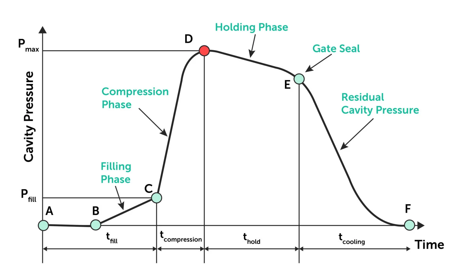

In-Mold Cavity Pressure Sensing
Distinguishable from pre-production setup studies, cavity pressure sensing is an active in-process monitoring and control technology. Piezoelectric transducers placed behind ejector pins or inside the cavity measure dynamic plastic pressure in real time. Rather than inferring fill dynamics from machine-side parameters, it verifies true cavity conditions and enables automated part sorting to reject out-of-spec shots immediately.
