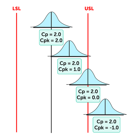

FAI confirms that the same setup can repeatedly produce parts within tolerance limits, establishing process capability metrics such as Cp and Cpk for lean or six sigma processes.
4. Customer Confidence
An approved FAI report demonstrates control, consistency, and compliance—boosting trust between OEMs and suppliers.
Chart showing Cp and Cpk ranges within specified process limits

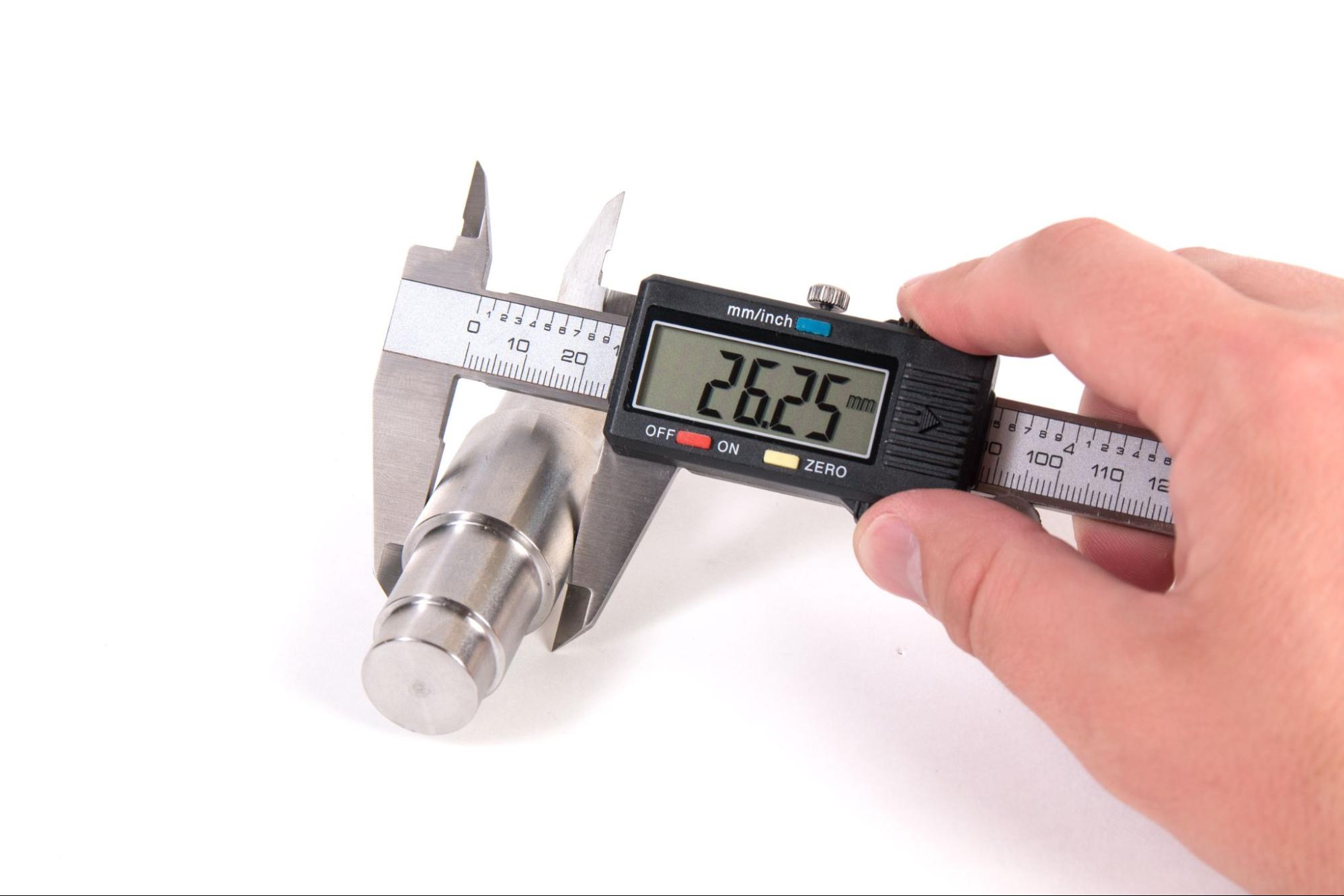

Calipers & MicrometersLinear and diameter checks for machined or molded parts

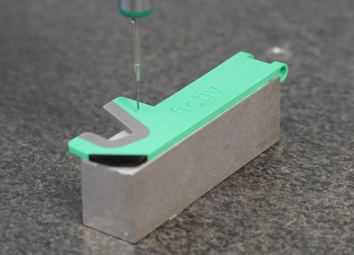

4. FAI Report (FAIR)
The FAI report is documentation that captures all measurements, inspection results, and material certifications, and is typically formatted in accordance with AS9102.
A CMM measuring Fictivmade parts for FAI

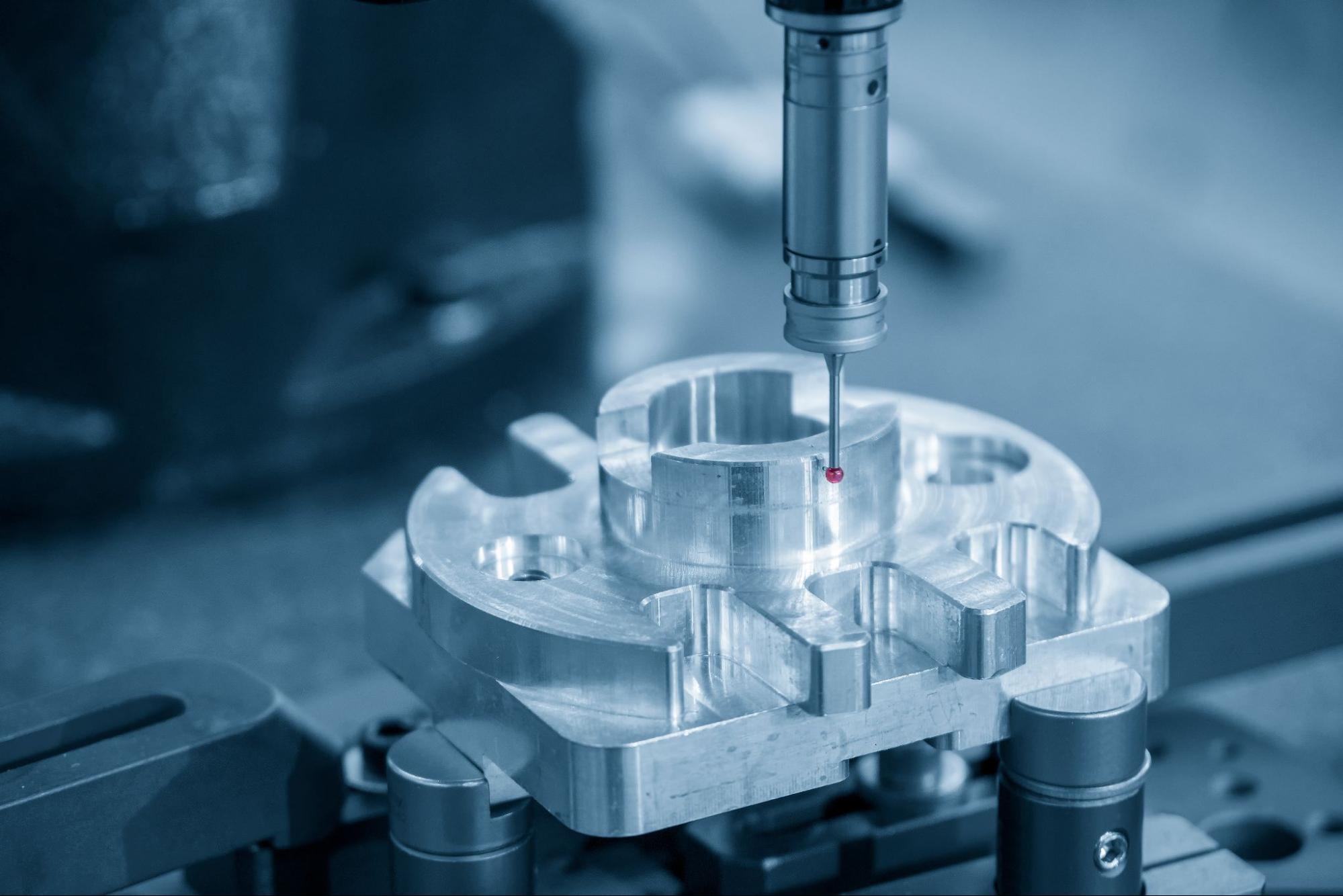

Step 3: Inspect and Measure
Perform dimensional inspection using calibrated tools. Record each value against the nominal dimension and tolerance. For complex parts, generate CMM reports and include screenshots or dimensional maps.

Calipers being used to measure a tight tolerance shaft diameter

A coordinate measuring machine (CMM) being used for first article inspection (FAI)
