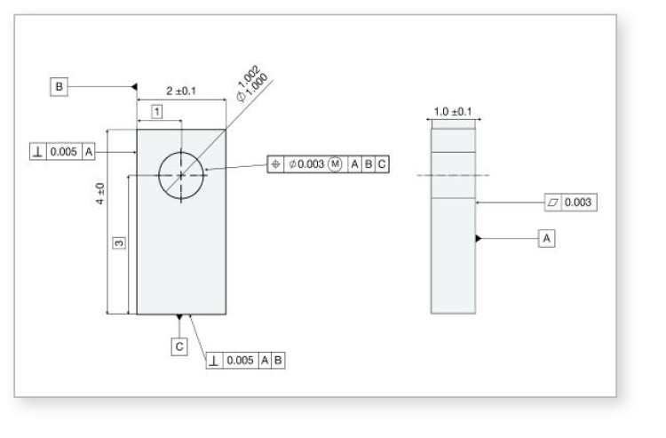

Geometric tolerances (GD&T) control the shape, orientation, and location of a part’s features. They may refer to specific characteristics of parts such as flatness, perpendicularity, position, and concentricity. Rather than controlling a single dimension, geometric tolerances define how features functionally relate to each other.
By focusing your control on what really matters for assembly and performance, you can often loosen size tolerances of other features. This results in savings where it counts, while allowing for tighter control of the functions you need.

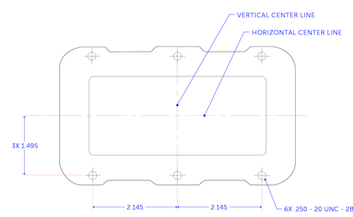

An engineering drawing showing dimensional and geometric tolerances

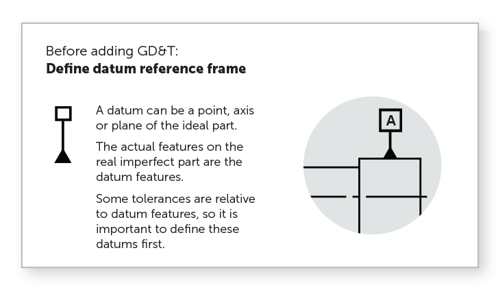

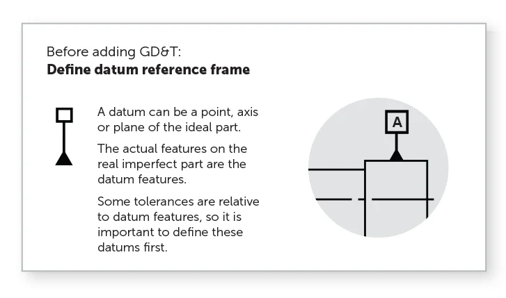

3. Poor Datum Selection
Datum choices ripple far beyond the drawing board. They dictate how a part is fixtured, how it’s measured, and whether two mating parts agree on what “aligned” means. A poorly chosen datum invites ambiguity, rework, and scrap.
A better approach:
  • Pick datums that mirror assembly interfaces—surfaces the part touches or locates from.
  • Sketch a datum reference frame on the drawing and label primary, secondary, and tertiary.
  • Run a quick mental tolerance stack to verify the datum scheme holds up in real‑world assembly.
Define datums when using GD&T.

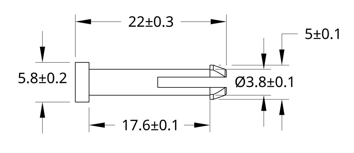

One standard tolerance doesn’t fit all processes. What’s routine for CNC machining may be impractical for sheet metal fabrication or injection molding. Applying the same ±0.1 mm across the board signals that process capability hasn’t been considered.
A better approach:
  • Annotate process‑specific expectations: “For molded parts, use ±0.25 mm unless otherwise noted.”
  • Flag features with the intended process so suppliers can quote appropriately.
  • Use standard tolerance tables per process rather than a single global default.
6. Over‑Tolerancing Nonfunctional Surfaces
It’s easy to carry tight tolerances across the whole model, even on faces that never see a mating part or affect performance. That stringency costs time and money at every machining and inspection step.
A better approach:
  • Mark nonfunctional surfaces as “reference” or “no tolerance required.”
  • Apply broader, standard tolerances to secondary faces.
  • If a cosmetic surface genuinely needs tight control, add a short justification line so it doesn’t read as an oversight.
  • Talk with your manufacturing partner about functionality early.
2D drawing of a snap-fit pin with tighter tolerances for critical dimensions
2D drawing of a snap fit pin with tighter tolerances for critical dimensions
