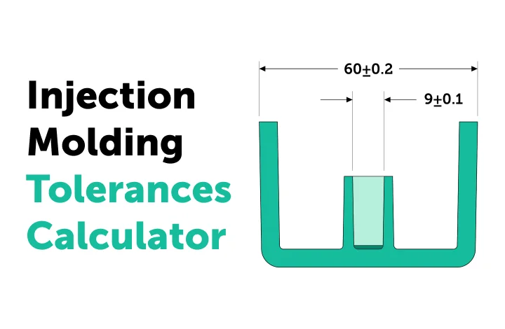

Mold Tolerances by Feature Size and Material
Part tolerances are a function of mold tolerances. Yet mold tolerances must account for the desired feature sizes and the injection molding material.
Try our Injection Molding Tolerances Calculator for the exact commercial or fine tolerance for your material and feature size in seconds.
Tables 1, 2, and 3 below contain commercial and fine tolerances for common injection molding materials and specialty plastics and polymer blends. If you’re unfamiliar with the acronyms for these materials, the list below explains what they mean.
