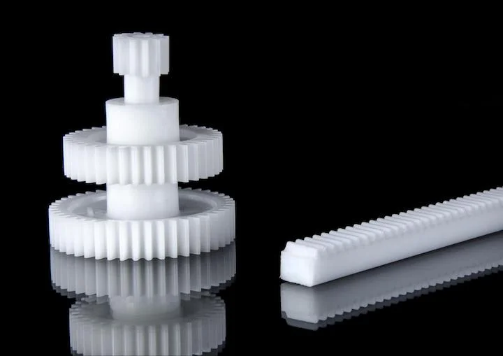

Glass-filled nylon gears
Glass filled nylon is used in gears because of its strength and dimensional stability

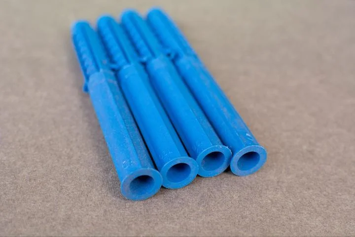

Glass-filled nylon
Glass filled nylon is used in drywall anchors because of its strength and impact resistance
