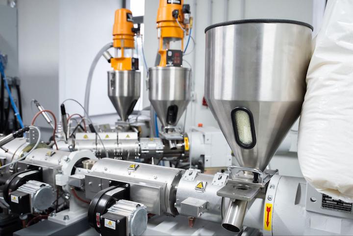

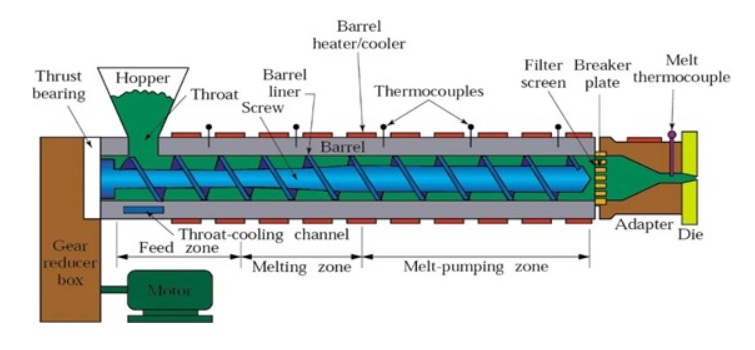

Plastic Extruder Components
The key components of a plastic extruder are the hopper, feed throat, breaker plate, barrel, feed pipe/adapter, die, and cooling system (see below). These components work together to facilitate the efficient melting, shaping, and solidification of the plastic material.
Plastic Extruder Components (Credit: Wayken Rapid Manufacturing)
The functions of the different components within a plastic extruder are as follows:
  1. Hopper: The first stage of the extruder, where plastic granules are stored and prepared for processing.
  2. Feed Throat: Transfers the plastic from the hopper to the barrel.
  3. Breaker Plate: Acts as a filter and maintains pressure within the barrel.
  4. Barrel: Heats and softens the plastic while a rotating screw conveys the molten material toward the feed pipe.
  5. Feed Pipe/Adapter: Conveys the molten plastic toward the die.
  6. Die: A metal tool that determines the shape of the extruded profile.
  7. Cooling System: Rapidly cools and solidifies the extruded profile.
