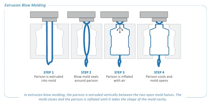

There are three main blow molding processes: extrusion, injection, and stretch. Extrusion blow molding (EBM) is the most common type and can be continuous or intermittent. During EBM, plastic resin pellets are melted and extruded into a hollow molten tube called a parison, which is then clamped into a mold. Compressed air is injected into the parison, causing it to expand and take the mold’s shape. After the mold is cooled and the plastic solidifies, the mold is opened and the plastic part is released.

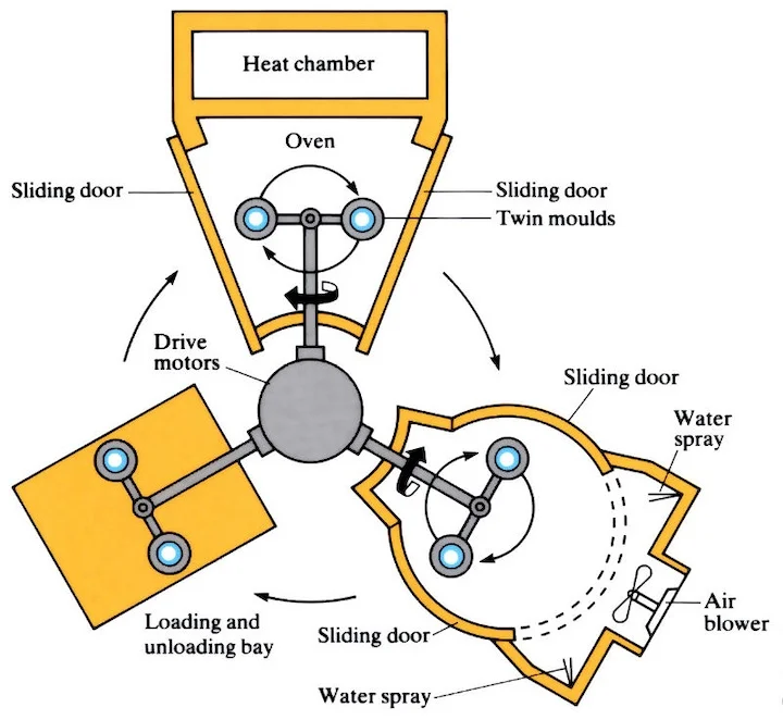

Rotational molding begins when a pre-measured amount of powdered resin is loaded into a mold that is then closed and held shut with bolts or clamps. The mold is put in an oven where it rotates about two axes simultaneously. As heat is transferred throughout the mold, the powder melts and adheres to the mold’s surface, building up layers of plastic. Pressure builds as the mold’s temperature rises to several hundred degrees, but air escapes through a vent tube.
When all of the powdered resin is melted and distributed, the mold is transferred to a cooling chamber. As the biaxial rotation continues, the mold is cooled with air, water mist, or a combination of both. As the temperature gradually decreases, the plastic part solidifies into its final shape, the mold is opened, and the part is removed. Like blow molding, secondary processes such as trimming may be required.

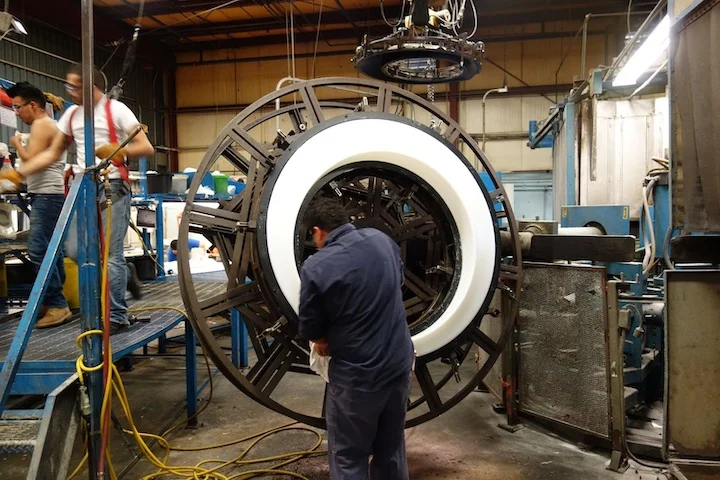

Blow molding requires more expensive tooling because it occurs at higher pressures. Aluminum is often used because of its high thermal conductivity and excellent machinability. Although steel is seldom used for extrusion blow molds, injection blow molds sometimes use pre-hardened or stainless steel. Most rotational molds are made of aluminum castings, but some are fabricated from steel or aluminum sheet metal instead. Rotational molds cost less but blow molds last longer.
Compared to rotational molding, blow molding has significantly shorter cycle times. Rotational molding can take more than 30 minutes, but blow molding can produce parts in a minute or less. Despite its higher tooling costs, blow molding is more cost-effective for production volumes that exceed 3,000 parts per year. Although blow molding is not cost-effective at low volumes, it tends to have lower per-piece costs. Both blow molding and rotational molding processes support the use of inserts and molded-in graphics.
