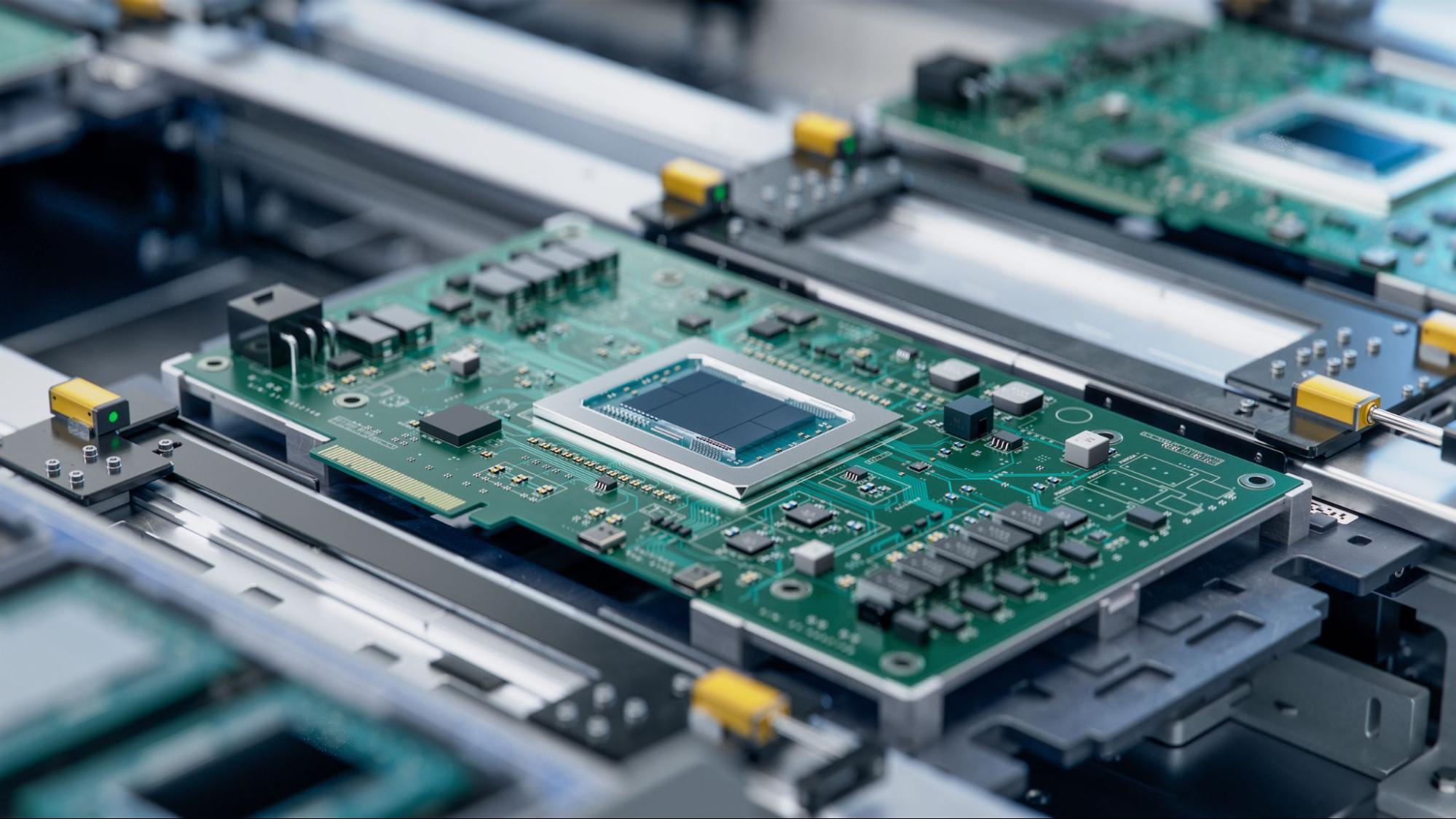

Printed circuit boards (PCB), seen in the figure below, are one of many products that are regularly developed with DFMA practices in mind.
PCBs are an example of a product that incorporates DFA.

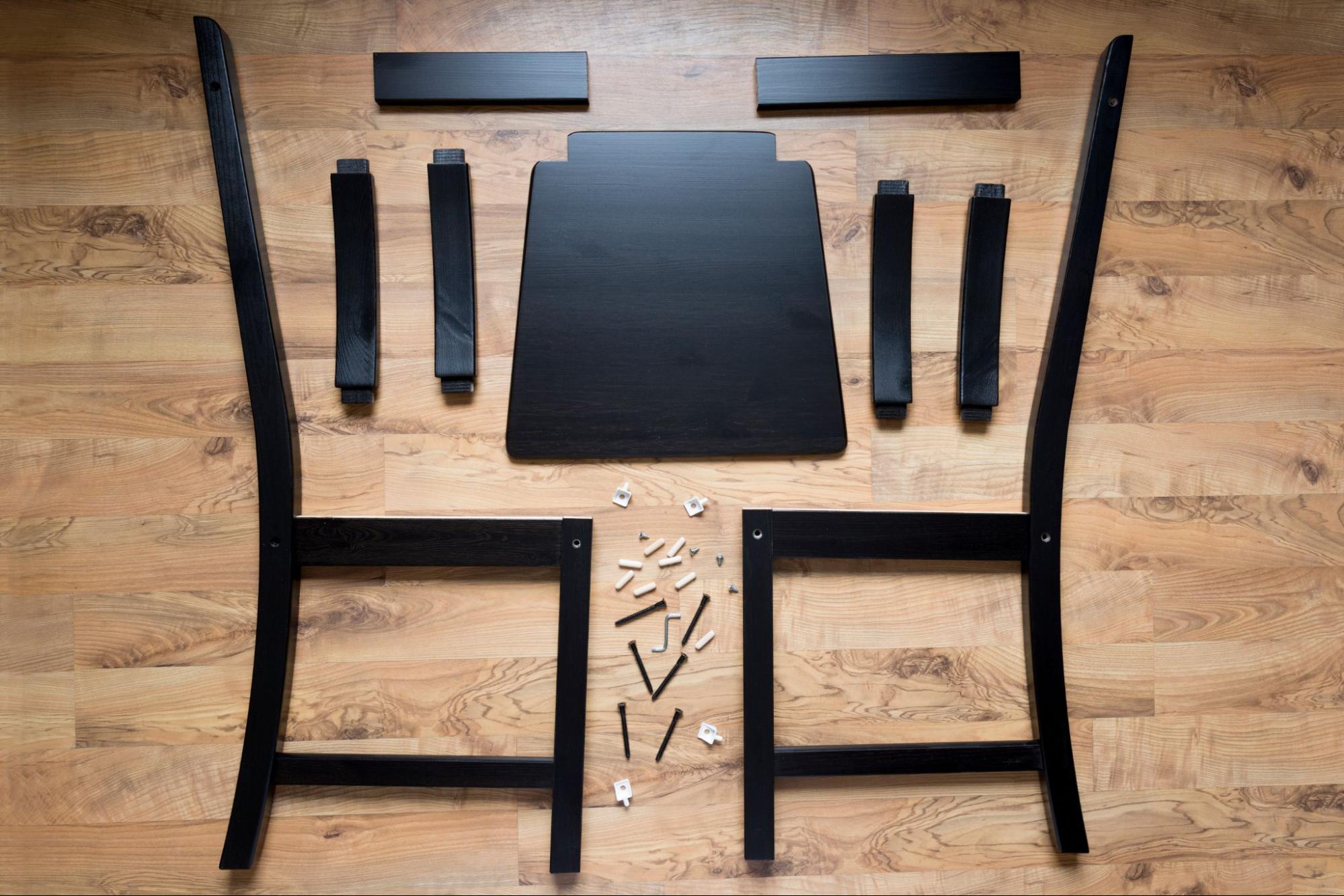

  • Optimize for Ease of Assembly: Parts should be self-locating and self-fixturing where possible. These features reduce assembly time and lower the risk of human error.

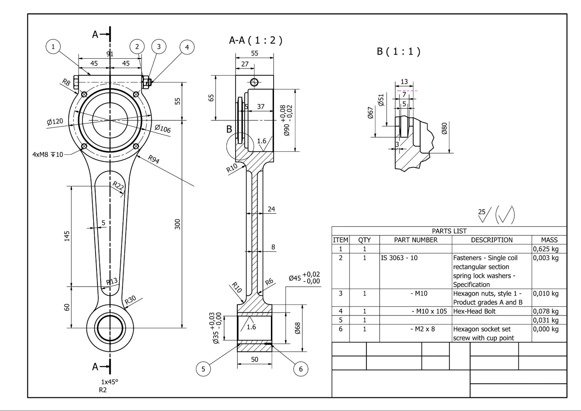

Example of a mechanical assembly drawing using DFMA principles.
