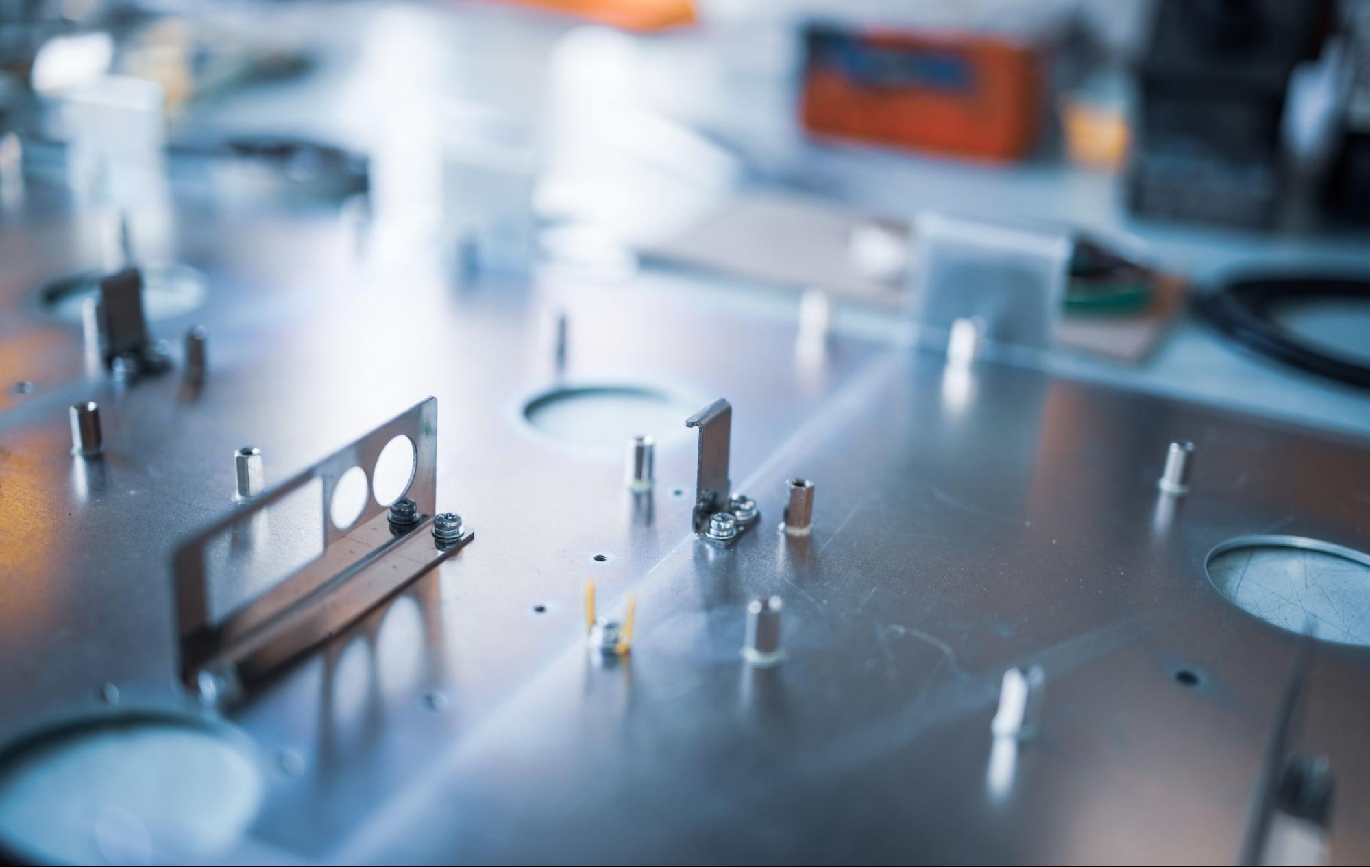

For sheet metal components, self-clinching hardware helps join thin metal components that can’t support traditional threading. These fasteners are pressed into the sheet to create strong, load-bearing threads without additional welding or machining. Because they lock permanently into place, self-clinching nuts, studs, and standoffs ensure consistent alignment, reduce the risk of spin-out or pull-through, and streamline downstream assembly. They also enable fast, repeatable fastening in tight or blind locations where conventional hardware would be difficult or impossible to install.
self-clinching fasteners simplify sheet metal assembly
Learn more about how to optimize metal assemblies in our Metal Assembly Guide and check out our Metal Assembly Services.

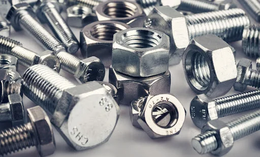

Being a product designer these days is great… so many of our design problems are already solved! Our Victorian ancestors had to meticulously design each screw thread, but now we have hundreds of standard diameters and pitches to choose from. While I know engineers love a good fastener design problem, it’s far simpler to choose something pre-fabricated.
And the range of options extends beyond basic fasteners like nuts and bolts. Commercial off-the-shelf (COTS) parts cover springs, pins, motors, microcontrollers, sensors, gears—most of the functional aspects of a design. This not only frees you to focus on unique design challenges, but also makes the manufacturing team happy since they already have the tools and skills to assemble your design. Also, with COTS parts, you often don’t have to test each part individually.
using the same, commercial off the shelf fasteners improves DFA and DFM

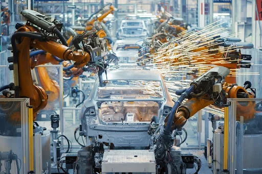

…Because assembly these days is increasingly handled by robots. Automation costs are decreasing rapidly, and robots and cobots are appearing on more assembly lines. So, it’s a good idea to design your components for easy grasping by robotic end-of-arm tooling (EOAT), and to avoid very small or flexible parts when possible. Of course,  humans on the assembly line will appreciate such designs, too—no one likes using a microscope to insert a screw.
