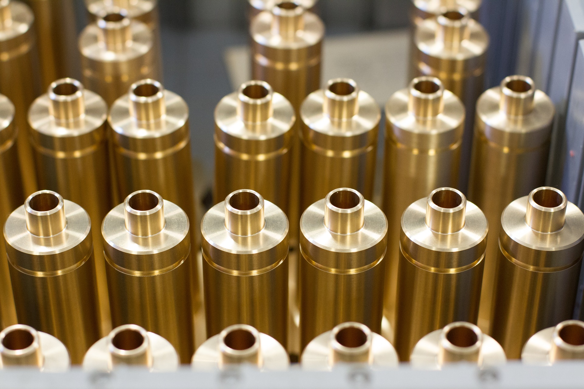

Precision is the ability to replicate consistent attributes across a large number of produced units (for example hitting the same dimension when machining 200 parts).
The graphic above is a good representation of the difference between accuracy and precision. If you are shooting darts at a dartboard, you may be able to hit the same area on the target, but it may not be in the center. This would be precise, but not accurate. This is an important point because it is also possible in machining to make many parts the same, but not within your target tolerances! It is necessary to check for both accuracy and precision.
Precision machining is applicable to the machining of a large number of produced units. You can have one accurate part, but you must have many parts to measure and compare in order to call them precise. If someone asks for a single part to be created using precision CNC machining, this is counterintuitive since “precision” in machining would involve multiple parts.
Now let’s talk about precision as it relates specifically to CNC machining. If you order some precision CNC machined components, what should you expect? Suppliers and machine shops should have processes in place to inspect your parts and make sure they meet certain quality standards. They will measure and compare a representative sample of the parts they produce to ensure they complete these quality checks. The next section will go into more detail about some of these quality processes.
