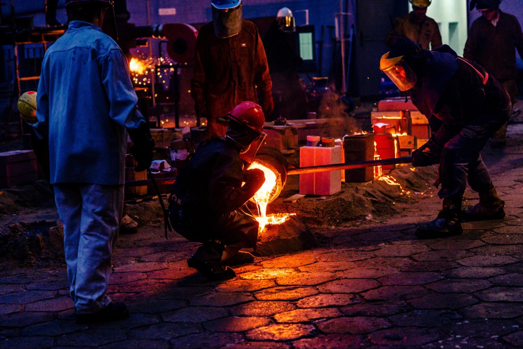

Casting is an ancient process that is still used in many forms today.
Casting is considered a formative manufacturing process that uses molds to make parts. While multiple metal casting methods exist—including sand casting, investment casting, and permanent mold casting—this article focuses primarily on die casting versus CNC machining, since die casting is typically the preferred casting method for high-volume production.
Other casting processes may be mentioned for context, but the economic and lead time comparisons throughout this article center on die casting.
Die Casting
In metal casting, molten metal is poured or injected into a pre-made mold. Cores or inserts may be added when complex internal geometries and cavities are required. Die casting is a specific type of casting that uses pressure to force the molten metal into the mold. The pressures used in high-pressure die casting are significantly higher than those in low-pressure die casting.
Once the part cools and solidifies, it’s cleaned and processed to achieve the desired surface finish. Secondary operations may include CNC machining to hit even tighter tolerances, or removing other undesirable features from the die casting process, such as flash. Other deflashing methods include grinding, cryogenic freezing, and tumbling.

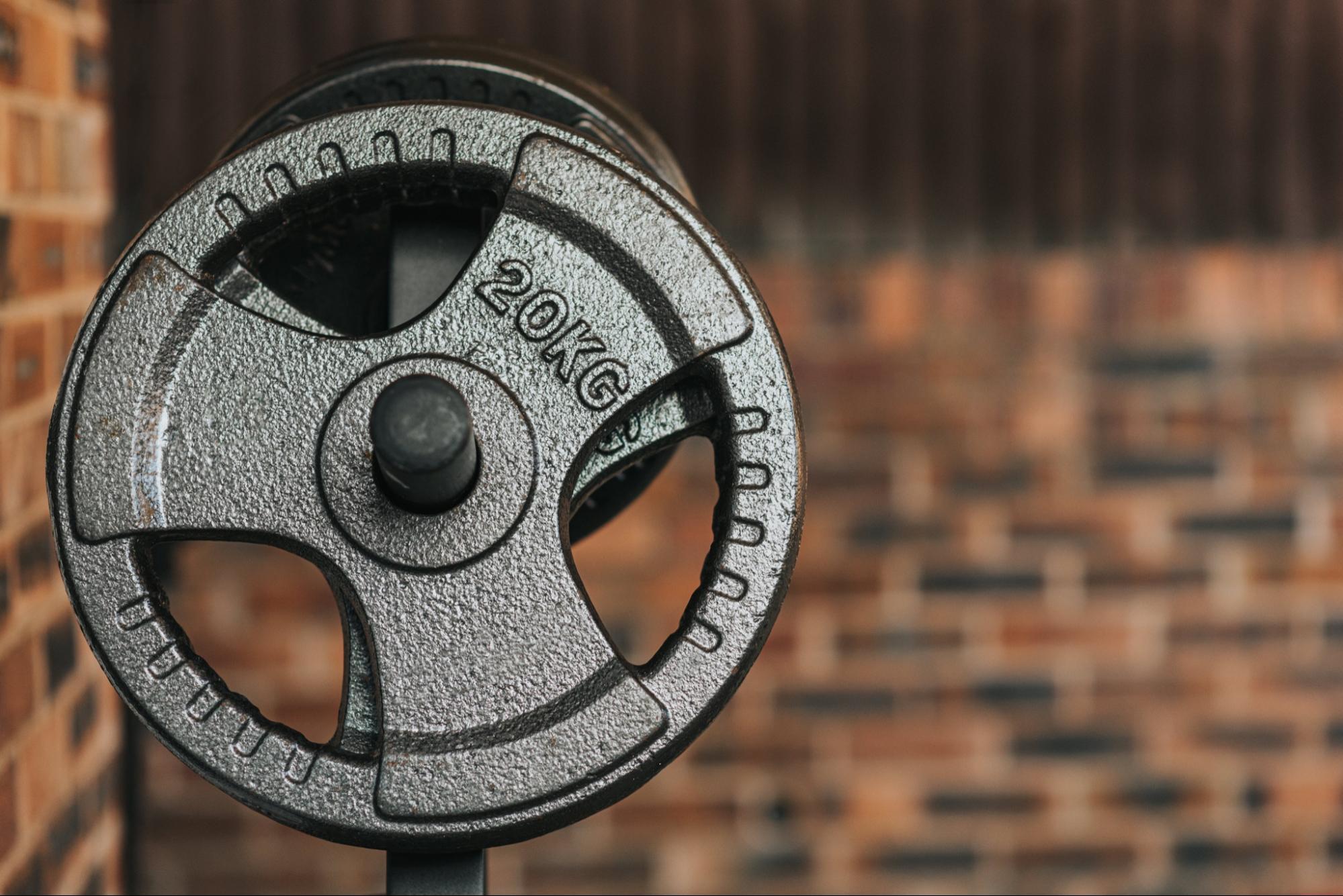

This gym weight is an example of a cast metal part
Train wheels, bus pedals, turbine blades, and engine blocks are common examples of die-cast parts. Cast parts are used in almost every industry, including automotive, aerospace, consumer products, and medical devices.

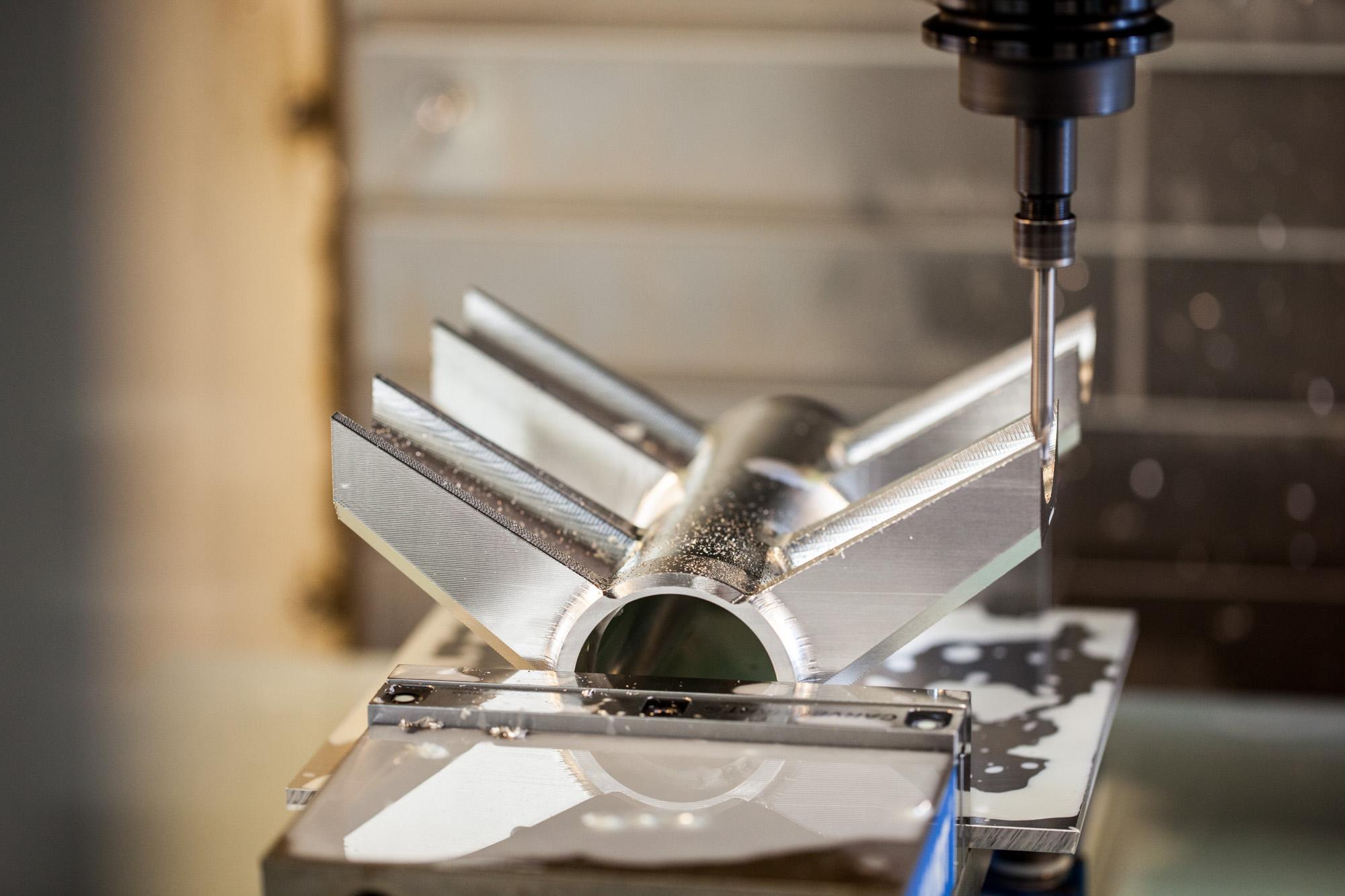

CNC machining is a subtractive manufacturing method that uses a cutting tool to remove material and achieve the desired geometry. A computer program using G-code tells the machine where to move and how to cut.
CNC machining produces extremely high-precision parts with tight tolerances.
CNC-machined parts are everywhere. Metal laptop enclosures, small components inside cell phones, aerospace, and automotive parts, fixtures, and jigs—even casting molds are manufactured using CNC machining.

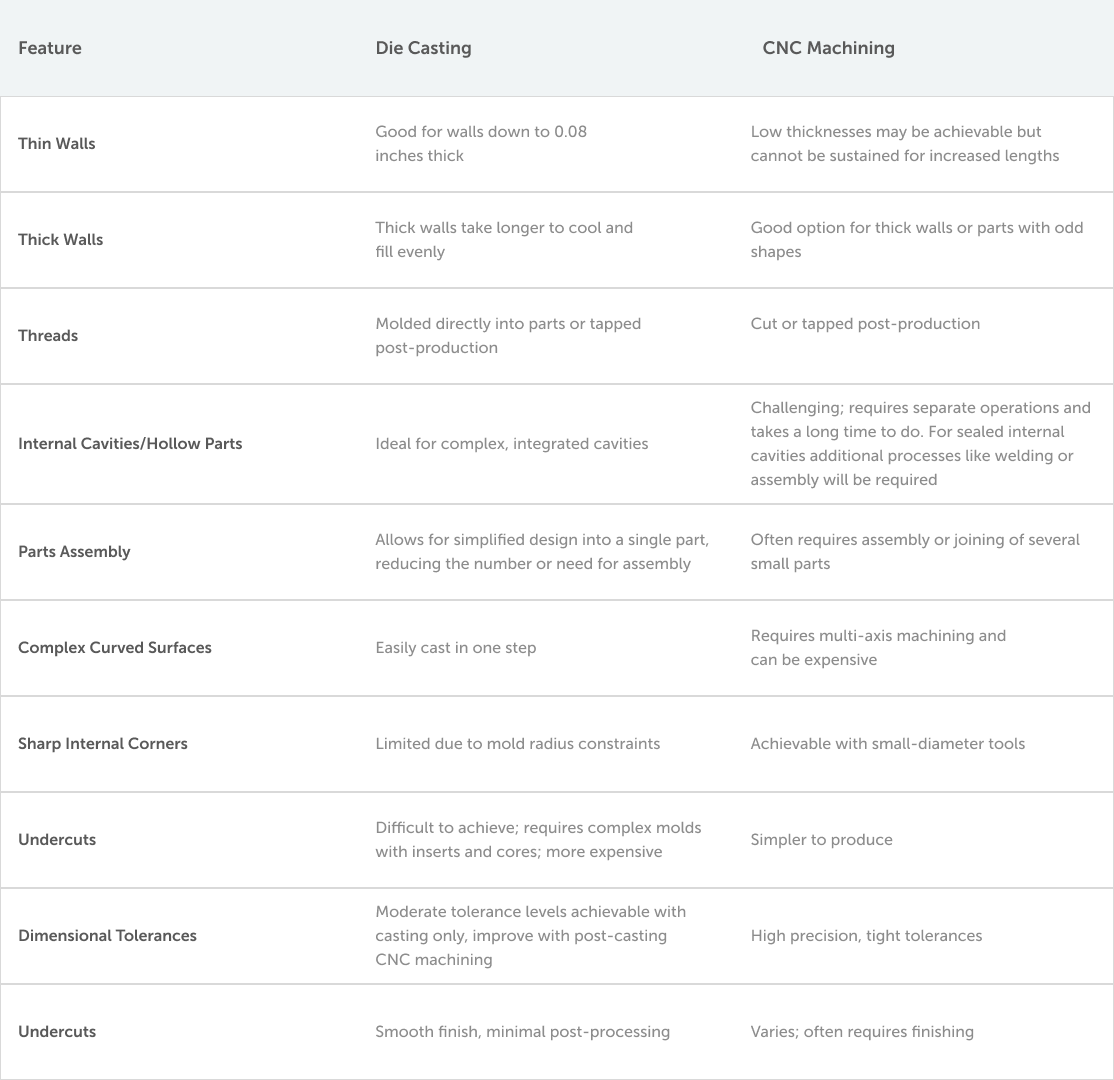

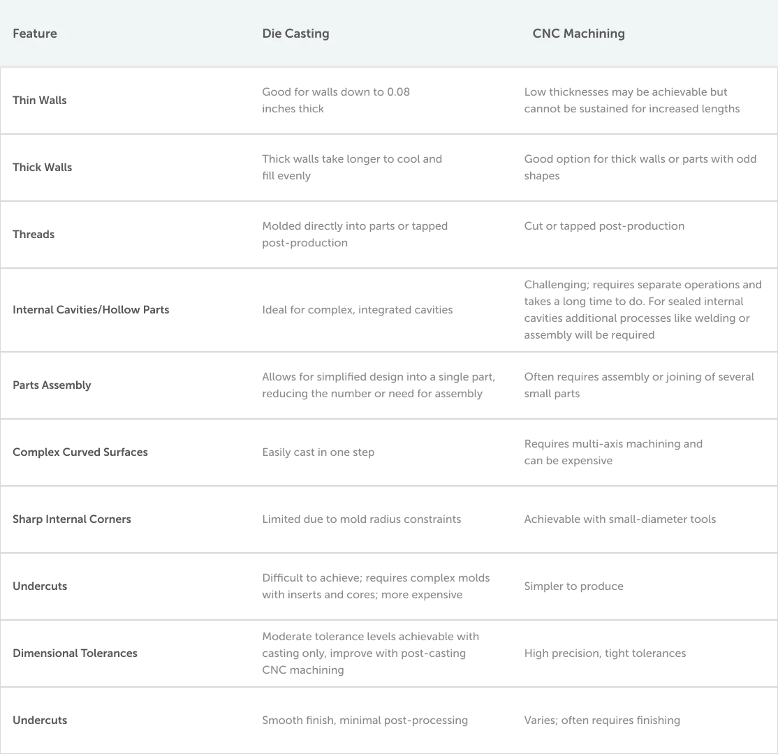

Table 1 Comparison of Best Suited Geometries for Die Casting and CNC Machining
Casting vs CNC Machining: Choosing Based On Part Geometry

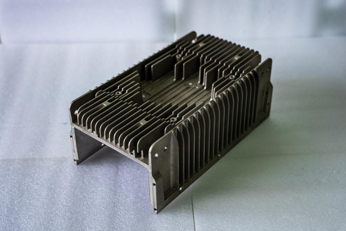

Choosing the correct manufacturing technique starts with considering the part geometry. Designs that require a large amount of material removal—for example, hollow parts with thin walls and large cavities—can be time-consuming and create excessive waste, making them strong candidates for casting. Complex geometries, which take a long time to machine, are also well-suited for casting.
Internal cavities are often ideal for casting, as forming them with CNC machining can be costly and difficult. This is especially true for sealed internal cavities, which may require assembly or metal-joining processes in addition to CNC machining. Casting simplifies this. Instead of machining multiple small parts and assembling them, you can cast the entire part and eliminate assembly steps altogether.
CNC machining is great for thick parts that require high precision.
However, certain features are more difficult to achieve with casting. Undercuts or internal features require more complex molds with cores and inserts. Sharp edges or corners are not ideal for casting either, and cast parts require a draft angle on all features. Large or oddly shaped parts with thick walls are also better suited to CNC machining, as those geometries are difficult to fill and cool evenly during casting.

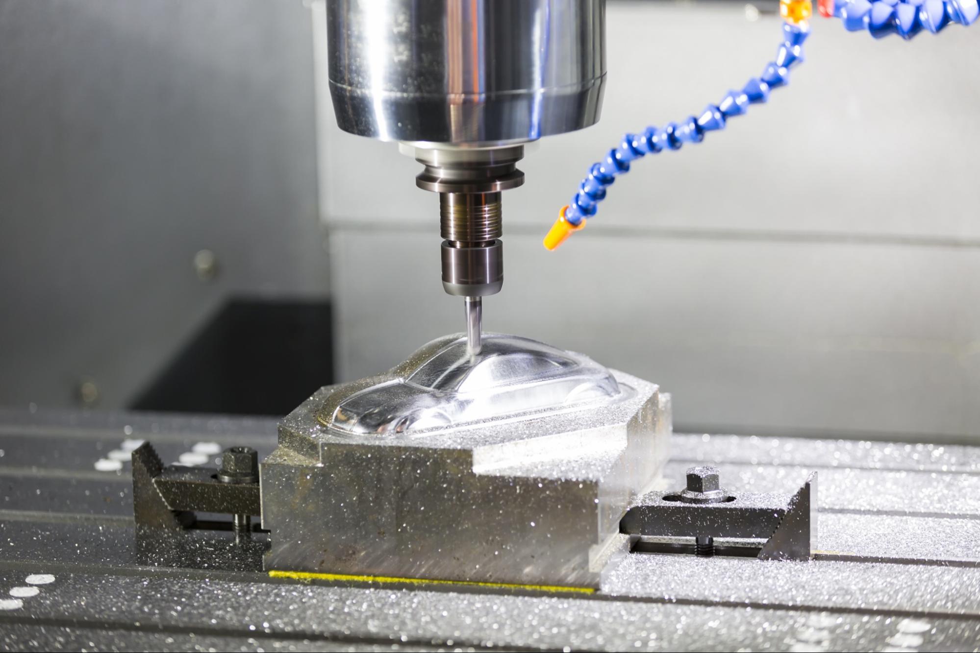

Although casting has its advantages, it’s not ideal during the prototyping phase of the development process. Every design change increases lead times and cost, as expensive molds are re-created or adjusted. A prototype die cast can cost thousands, if not hundreds of thousands of dollars. And, while sand casting is typically cheaper, it cannot match the dimensional accuracy or surface finish of machining or die casting.
CNC machining is the better choice for prototyping, due to its relative agility. When the design is still in flux, all you need to do is update the model and revise the CAM program, rather than remaking or modifying an existing mold.

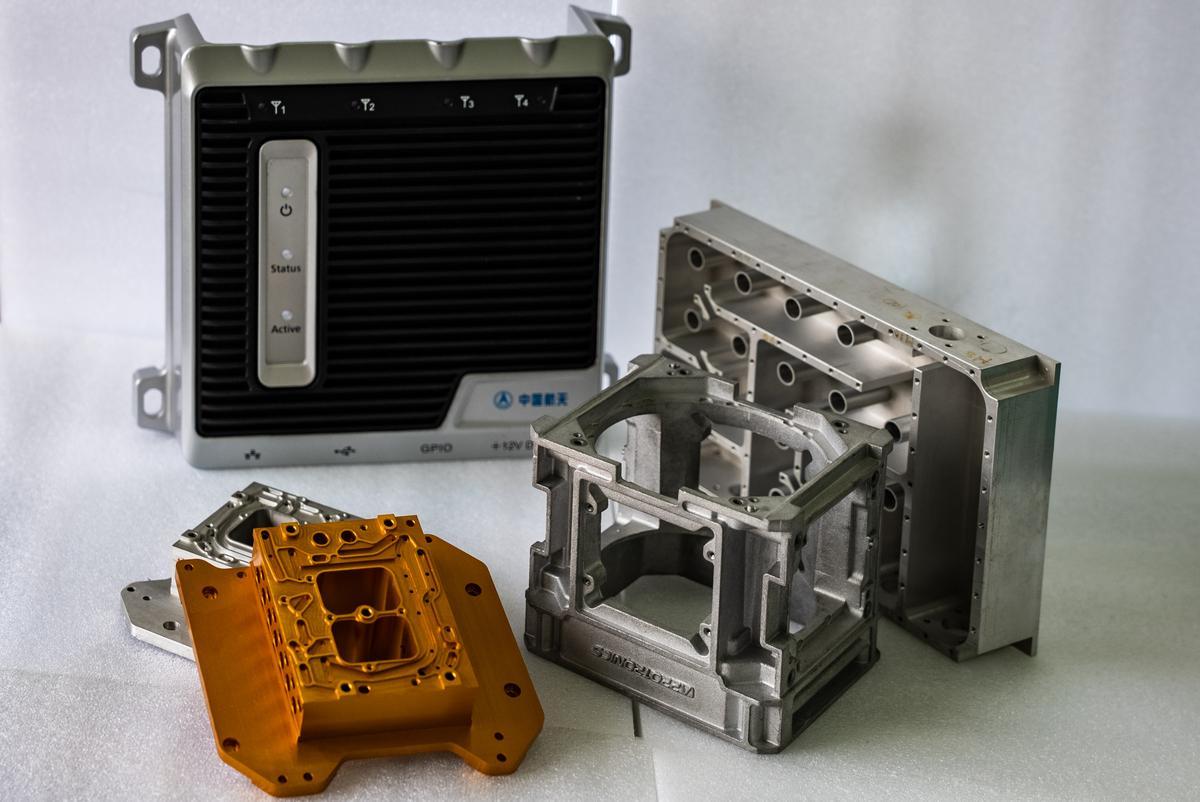

cnc machined metal part for low volume production
CNC machining is typically a better option for prototype parts than casting

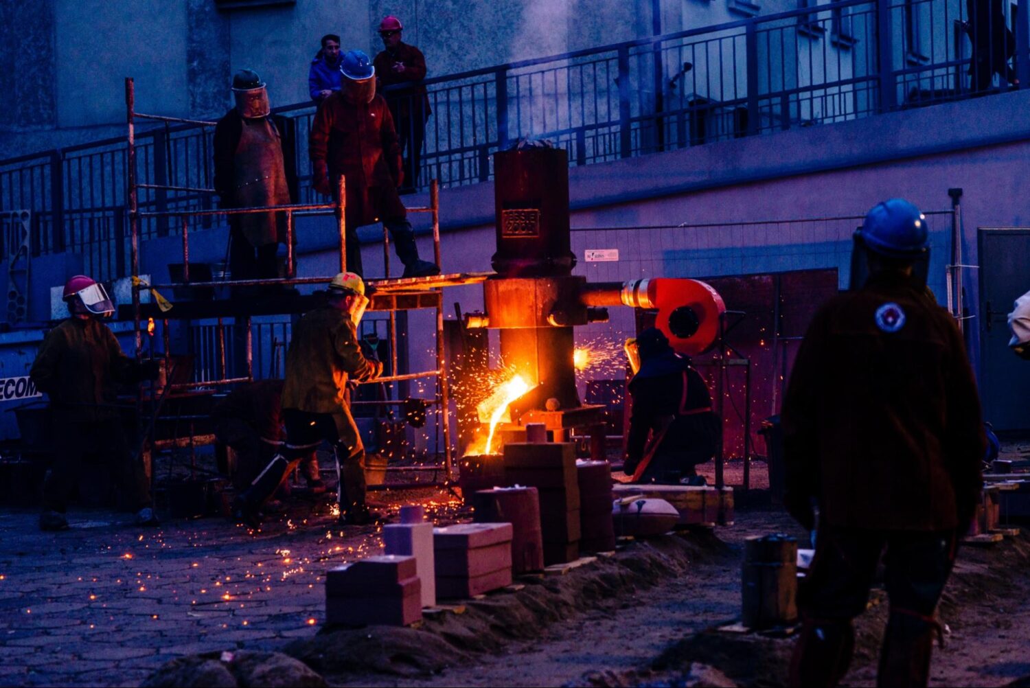

Die casting is an excellent option for higher-volume production of metal parts.
Die casting is an excellent option for higher volume production of metal parts

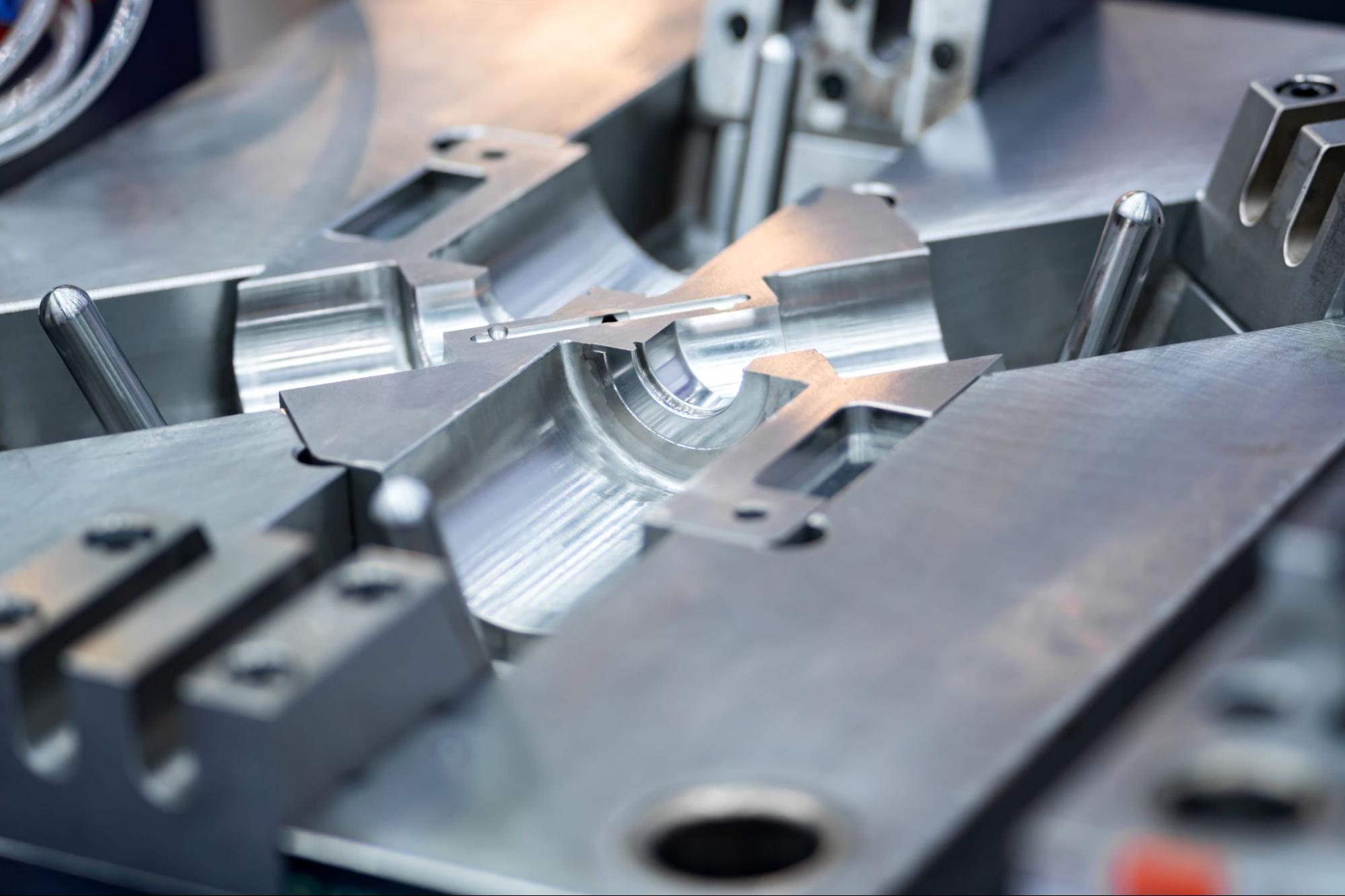

A machined die casting mold for aluminum parts
