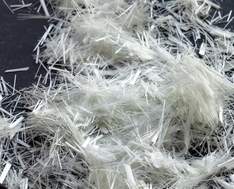

Glass-Filled Plastics
Glass fibers are among the most commonly used reinforcement fillers in engineering thermoplastics, especially in resins like nylon (PA), PBT, PEI, and PPS. These fibers, typically added as short or long strands, significantly improve mechanical properties. In fact, long-strand glass-filled polypropylene has been shown to triple tensile strength and quadruple stiffness at room temperature compared to its unfilled counterpart.
The fibers act as load-bearing elements within the matrix, making the plastic more rigid and dimensionally stable. These qualities are essential for parts that experience mechanical stress, such as automotive brackets, pump housings, gears, and industrial structural components. However, the orientation of the fibers during molding plays a crucial role in determining final part strength. That’s why part design and (mold) gate placement must be optimized to maximize fiber alignment in the direction of stress.
Most glass fillers are short-chopped strands, but the use of long-strand fiber technology is growing. These provide better load transfer and more uniform reinforcement but require careful processing, as longer fibers are more likely to shear during molding. The addition of coupling agents, such as silanes, improves adhesion between the fibers and resin, enhancing mechanical strength and especially impact resistance, which is a known drawback in highly rigid, glass-filled composites.
Glass fiber used for filling plastic.

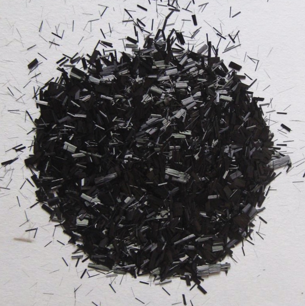

Carbon Fiber-Filled Plastics
Carbon fiber fillers are reserved for high-performance applications where lightweight strength, stiffness, and electrical conductivity are crucial. Unlike glass, which adds bulk and weight, carbon fibers drastically increase elastic modulus without adversely affecting density. This makes them ideal for aerospace, electronics, drones, and high-end automotive parts.
When incorporated into thermoplastics such as PEI, PEEK, or PPS, they form a composite with a superior modulus-to-weight ratio, enhanced fatigue resistance, and excellent dimensional stability under thermal and mechanical stress. Their electrical conductivity also makes them ideal for EMI shielding enclosures, static-dissipative components, and electronic housings.
Carbon-filled plastics, however, tend to be brittle, with lower impact strength unless carefully modified. The cost is also significantly higher than traditional fillers, and processing challenges include abrasion of tooling and a tendency for fibers to align during flow, creating anisotropic (direction-dependent) properties. Despite this, their performance in weight-sensitive structural applications, like UAV fuselages or automotive body panels, often outweighs the drawbacks.
Carbon fiber used for filling plastic.

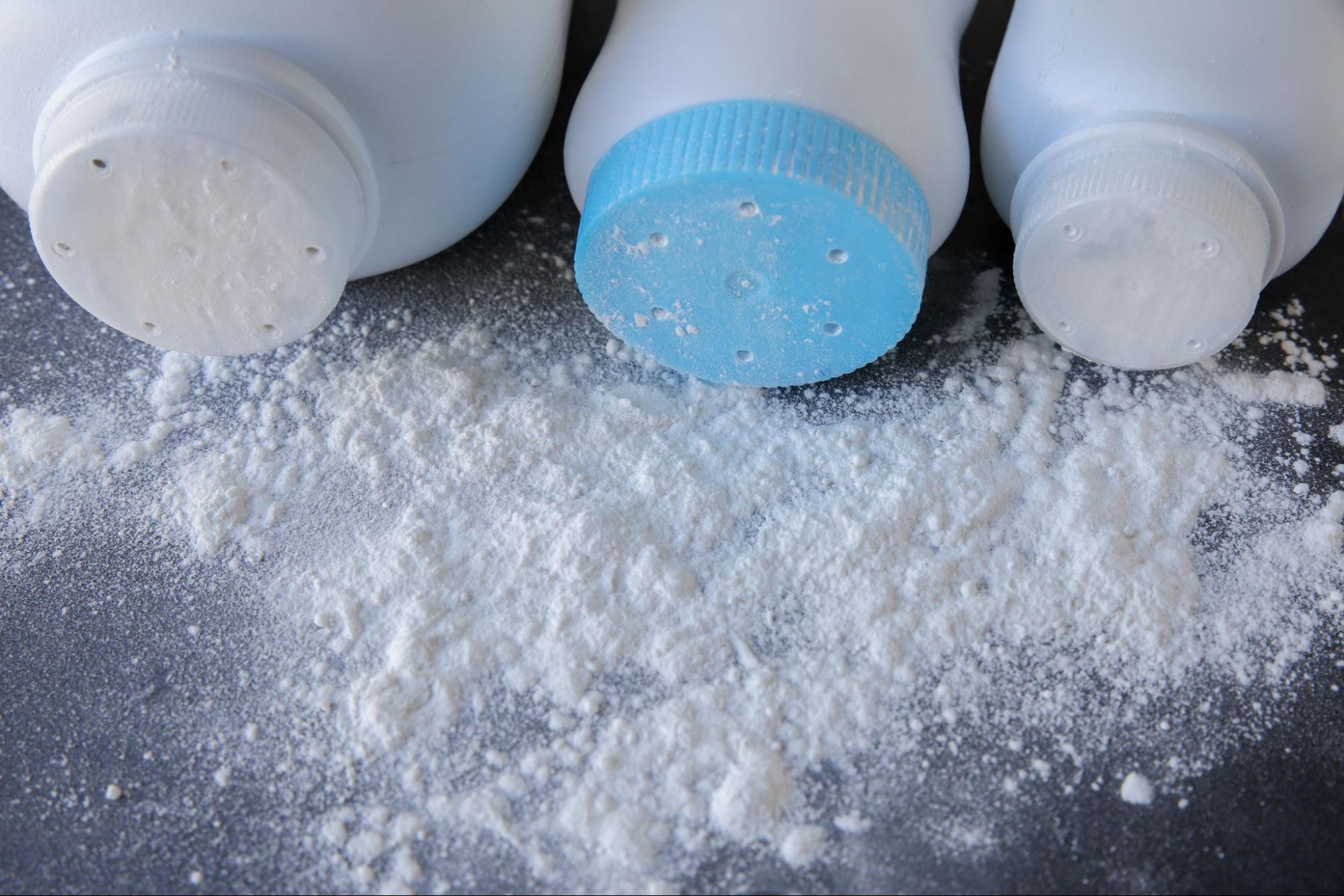

  • Mica: Enhances dimensional stability, chemical resistance, barrier properties, electrical insulation, and thermal resistance. It significantly reduces mold shrinkage by up to 85% in nylon and is commonly used with silane-based coupling agents to improve bonding with the polymer matrix.
Talc (also used in talcum powder) is a common mineral filler in plastic

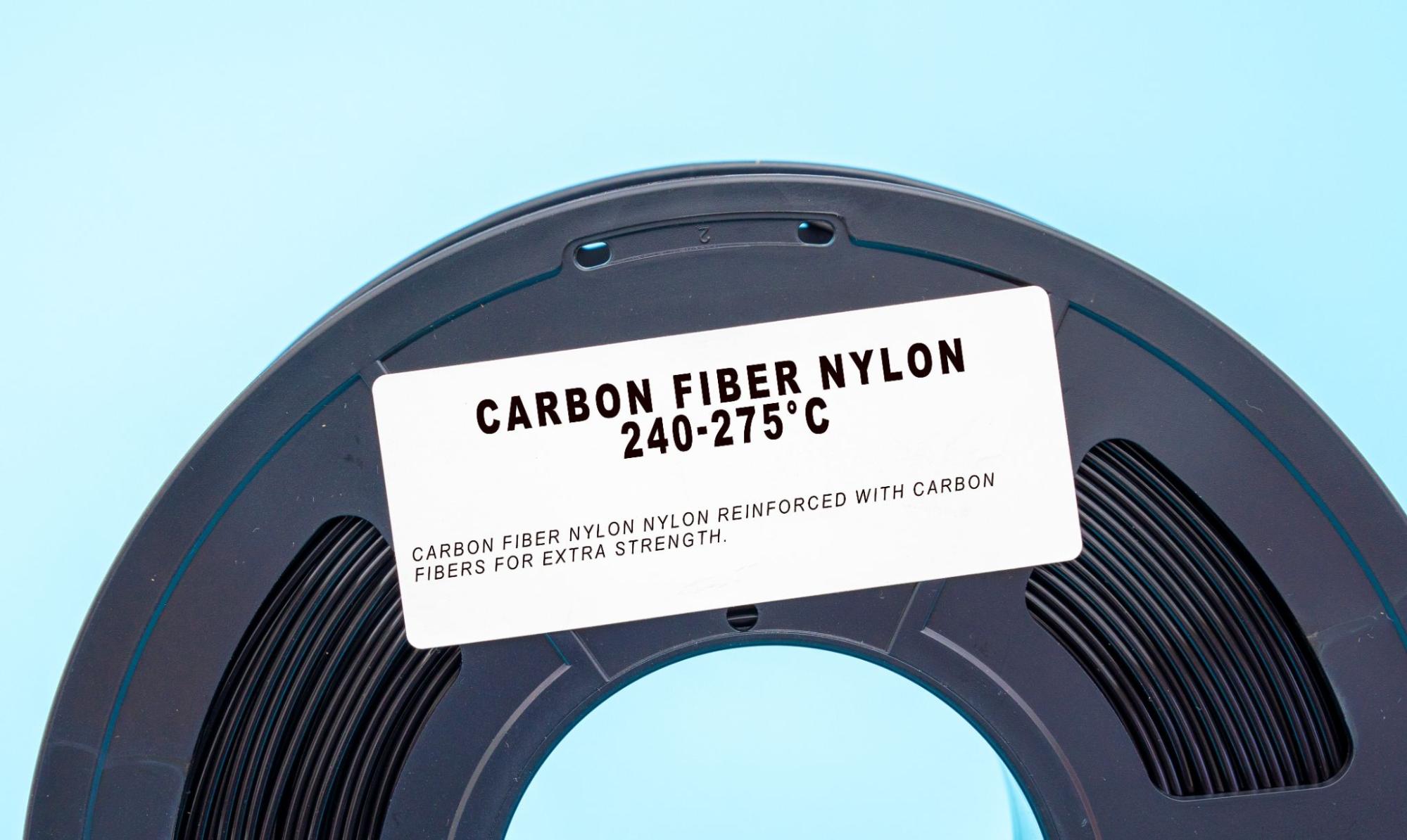

Carbon-filled nylon material for 3D printing
FDM (Fused Deposition Modeling)
FDM is currently the most accessible 3D printing method for working with filled plastics. Glass- and carbon-filled filaments are commercially available and provide improved stiffness, strength, and heat resistance compared to unfilled filaments.
However, these benefits come with drawbacks. The abrasive nature of reinforcing fibers leads to rapid nozzle wear, requiring the use of hardened steel or ruby-tipped nozzles. Additionally, filled filaments often result in poor interlayer adhesion and increased stringing during printing, which can compromise both the mechanical performance and the surface finish of printed parts.
