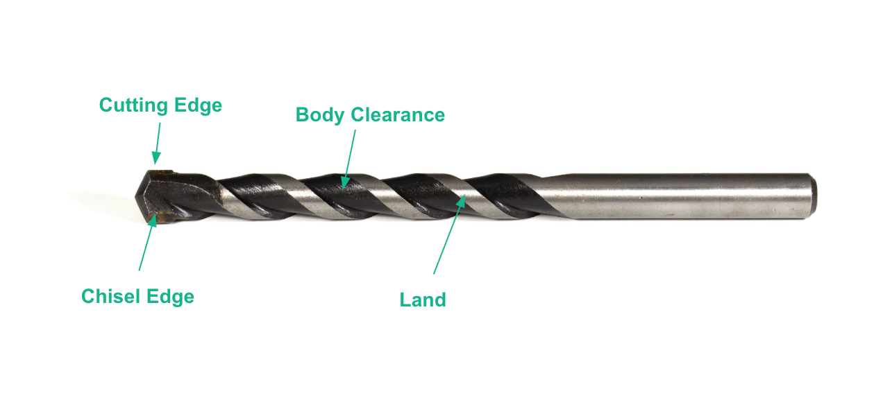

Most people have operated a drill for simple tasks around their homes or for repairs, but may not know how drilling works in CNC machining. Drilling is the most basic internal machining operation, used to create an initial cylindrical hole in a solid workpiece. Typically, such a hole is made with a twist drill bit, where the cutting action occurs primarily at the tip. Helical grooves, called “flutes,” form a spiral channel that facilitates the movement of metal or plastic chips up and out of the hole. The figure below shows the main components of a typical twist drill bit.
A twist drill bit with labelled components.
Drilling utilizes a combination of rotational force and axial feed to drive the drill bit into the material, both of which need to be tailored to the material’s conductivity and hardness. The process begins by aligning the drill at the desired angle to the surface, typically perpendicular for straight holes, although angled drilling is possible depending on the design needs.
Once the bit has penetrated the surface of the workpiece, the bit cuts into the material, forming a cylindrical path as chips are cleared through the flutes. For deeper holes, peck drilling cycles (intermittent withdrawals to clear chips and reduce heat) or through-spindle coolant can help prevent overheating.

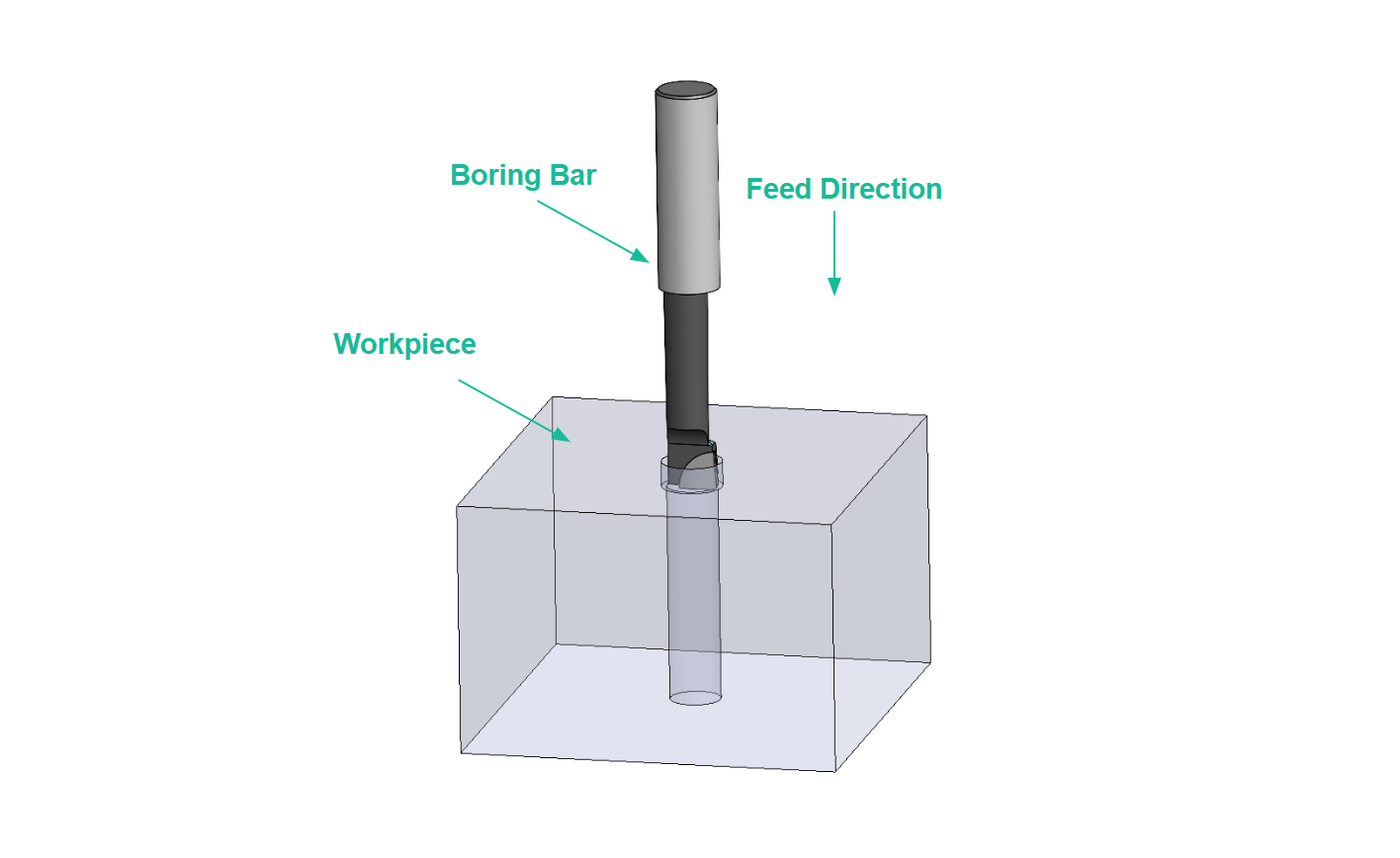

Boring is a precision machining process used to enlarge an existing hole, improving its alignment and surface finish. This operation is often performed with a single-point cutting tool held in a boring bar, and it offers some pretty exciting benefits (pun intended).
Boring can be performed on both CNC lathes and mills. When using a CNC lathe, the workpiece rotates while the boring bar remains stationary. On a milling machine, the boring head rotates while the workpiece remains fixed.
A boring bar cuts an enlarged hole in a workpiece
While drilling initiates a hole, boring improves upon it. Boring allows for better control over hole concentricity, roundness, and location, especially when a CNC boring head or boring bar is used.

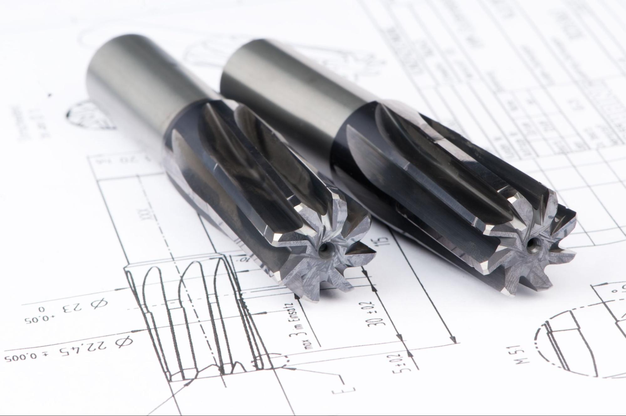

Reaming is a hole-finishing operation used to bring a pre-drilled or pre-bored hole to an exact diameter, resulting in an improved surface finish compared to drilling or boring alone. Reaming is performed after drilling or boring, not as a standalone process. Reamers are multi-edged tools that remove minimal material in a single pass.
Fluted reaming tools
Unlike boring or drilling, reaming doesn’t correct alignment or location. Instead, it fine-tunes the hole’s diameter and finish. A reamer is rotated and fed into the hole at a slower rate, trimming just 0.1 to 0.3 mm of material per pass.

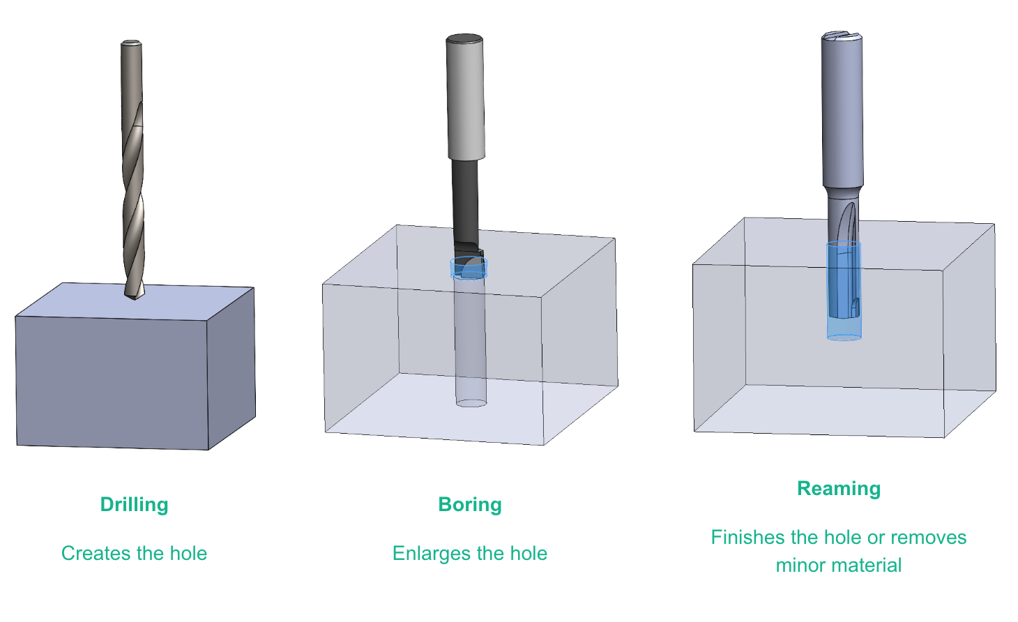

Drilling vs. Boring vs. Reaming: Comparison Table
To better understand hole machining, it can be helpful to compare drilling, boring, and reaming side by side. Each technique serves a specific role in precision hole-making, and understanding their distinctions in terms of tolerances, surface finish, and use case can streamline decision-making.
DrillingBoringReaming
PurposeRemoves bulk material quickly. Creates an initial hole.Enlarges/refines hole. Corrects hole geometry and misalignment while allowing precise control of final diameter.Ensures precise final size and smooth finish. Does not alter the hole path.
Typical Tolerance (diameter)±0.1–0.3 mm±0.05–0.1 mm±0.005–0.02 mm
Surface FinishFair (~125–250 µin Ra)Good (~63–125 µin Ra)Excellent (~16–32 µin Ra)
ToolingTwist drillBoring barReamer
Differences between drilling, boring, and reaming operations
Differences between drilling boring and reaming operations
In most precision manufacturing processes, drilling is followed by boring to correct alignment or enlarge the hole, and reaming is used last to fine-tune the diameter and finish to exact specs.
