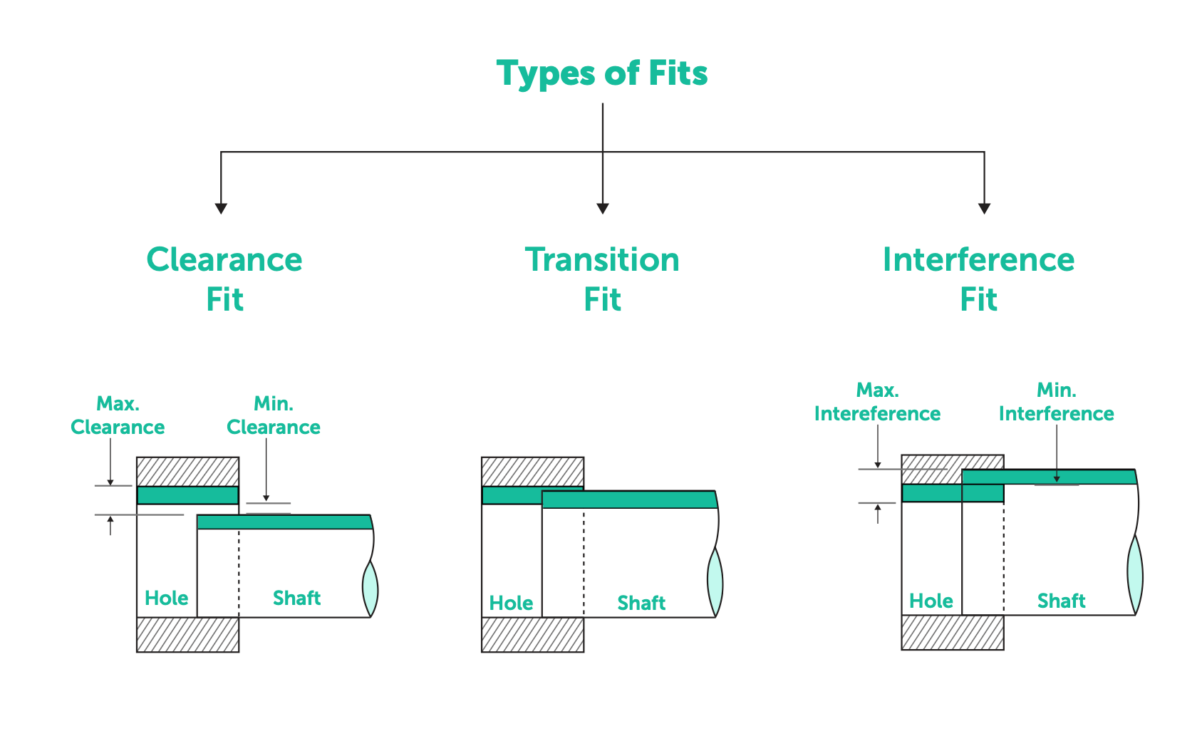

There are three primary types of fits in engineering: clearance, interference, and transition.

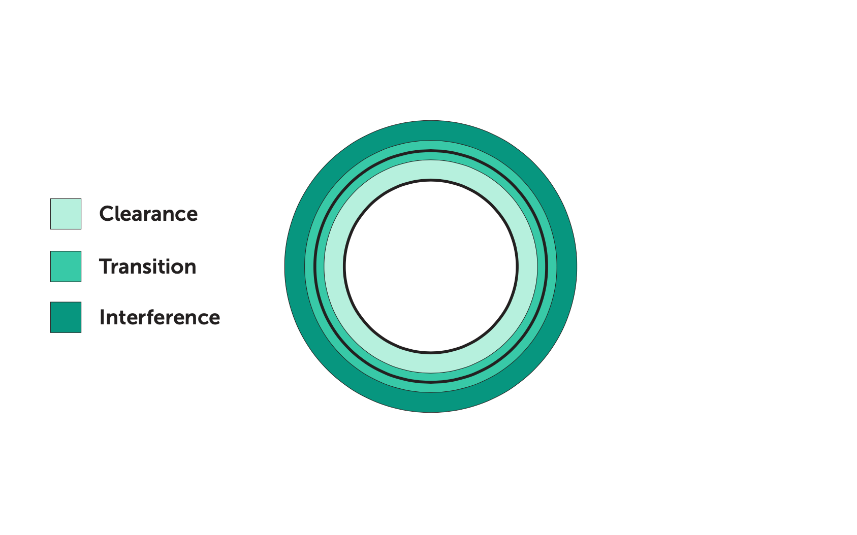

Engineering Fits Cross-Section
Types of Engineering Fits
Clearance Fit
A clearance fit is the most common type of fit, where the hole is always slightly larger than the shaft, creating an intentional gap between the two parts. This gap, or clearance, allows for free movement without friction or interference and is controlled by the tolerances of both component features to ensure a smooth fit without excessive looseness.

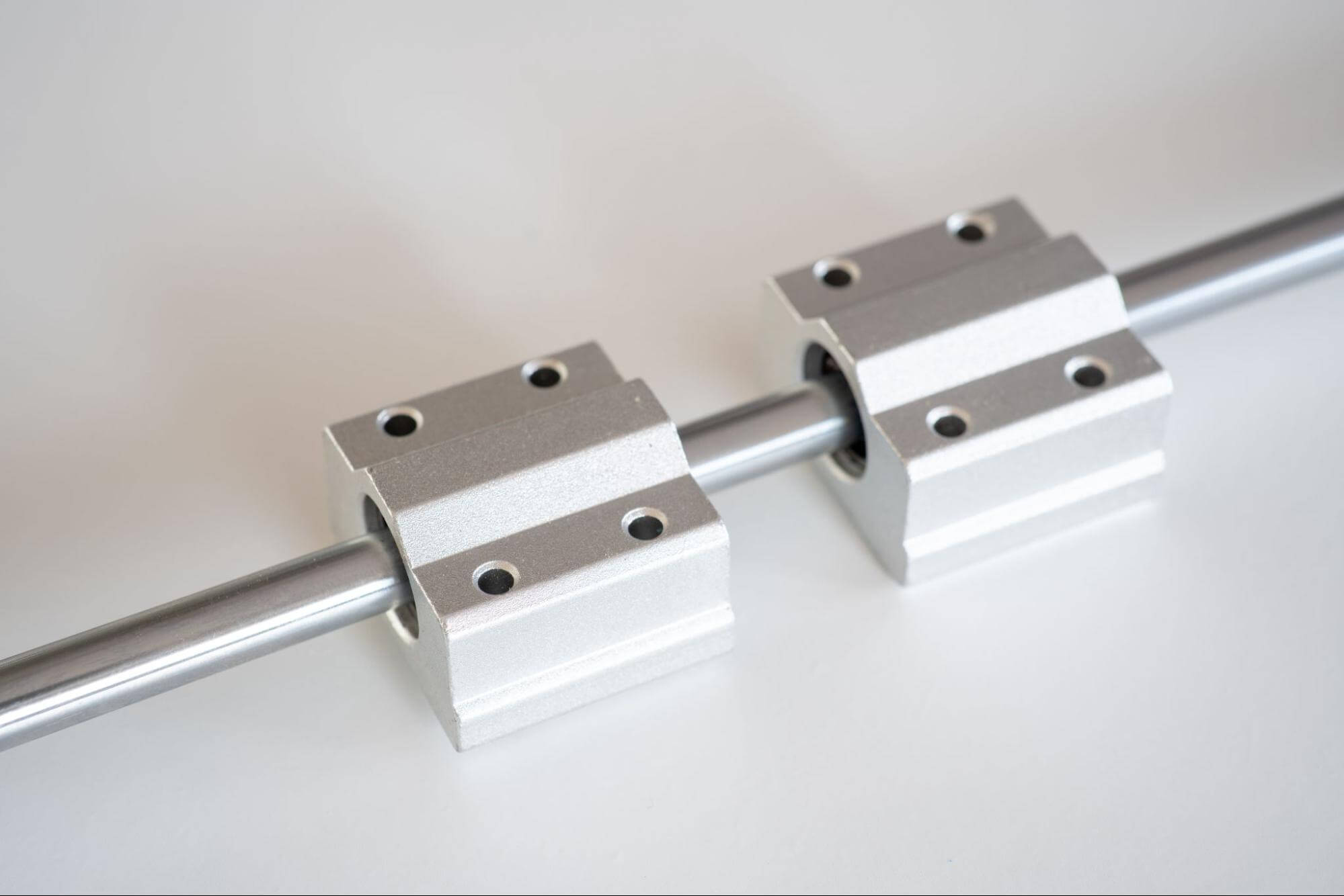

There are various types of clearance fits including slide fit, easy slide fit, loose running fit, free running fit, and close running fit. These are based on the amount of clearance and looseness of the fit.
Clearance fits are ideal in applications where movement, rotation, or easy assembly is required. Examples include:
  • Bearings: Allow shafts to rotate freely without binding.
  • Linkages and sliding parts: Enable easy insertion and removal with minimal force.
  • Gears: Permit smooth rotation while preventing tight contact.
  • Plumbing fittings: Facilitate simple assembly and disassembly by allowing pipes to slide easily into connectors.
Type of clearance fit - linear sliding mechanisms using sliding fits.
Interference Fit
An interference fit, also known as a press fit, occurs when the shaft is slightly larger than the hole, resulting in a tight, force-fit connection. The parts are assembled under pressure (or by applying heat to the hole, which temporarily expands it before fitting), creating an interference that prevents any movement between them. This fit forms a strong, stable bond that is often permanent or semi-permanent.
Interference fits are used when components must remain fixed under load, vibration, or stress. Common applications include:

Transition Fit
A transition fit strikes a balance between clearance and interference fits. Depending on the exact tolerances applied, it can result in either a small clearance or slight interference between the shaft and the hole.
This type of fit is used when precise alignment is needed, and parts must fit together tightly—but not permanently—allowing for minimal play and controlled movement.
Transition fits are ideal for applications requiring both stability and ease of assembly. Common examples include:

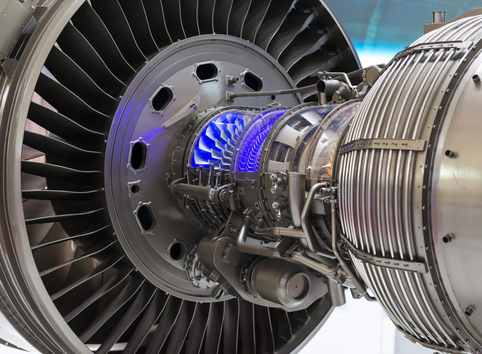

Transition Fits in Aerospace Engineering:
In aerospace systems, transition fits are employed when components need to be both securely joined and removable for maintenance. For instance, a keyed shaft and a mating clutch or wheel hub might use a transition fit to enable torque transmission without excessive play. This controlled tolerance allows precise assembly while still enabling disassembly during overhaul or inspection cycles.
Interference Fits for High-Strength Applications:
In heavy-duty industrial applications, such as gear trains or flywheels, interference fits are used to create non-slip connections between shafts and components. Press-fitting or shrink-fitting methods are applied to achieve the necessary interference. Engineers calculate the fit magnitude based on material properties and expected operating loads to minimize stress concentrations while maximizing structural integrity and vibration resistance.
Plane turbine engine components fitting together.
