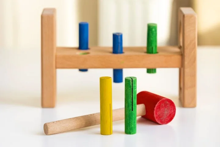

If you have kids or have been around toddlers, you’re probably familiar with a variation of the pound-a-peg toy shown in the image below — a toddler inserts a peg into one of the holes and pounds on it with the hammer. The tapered pegs stop when you hammer them far enough to achieve a press, or interference, fit.
Now, is this toy meant to develop hand-eye coordination, OR is it part of a larger strategy to expose children to different simple mechanisms and encourage them to enter into a STEM field? I’ll let you decide for yourself… but I definitely have an ulterior motive with my toddler!
Regardless of why you’re introducing press-fit toys to your kids, they’re actually representative of how engineers plan fits in their designs. Press fits are great for adapting to many situations, holding parts in alignment, and are easily forming a lasting bond between components.
press fits are commonly used in the pound-a-peg children’s toy
