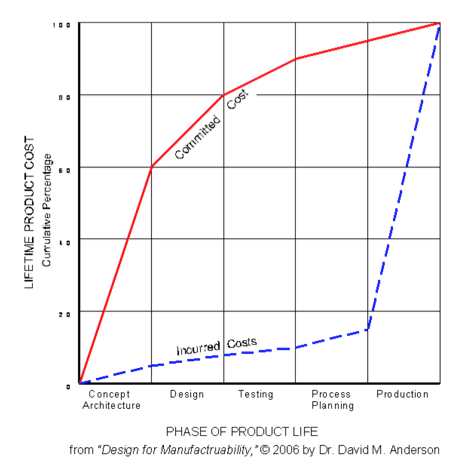

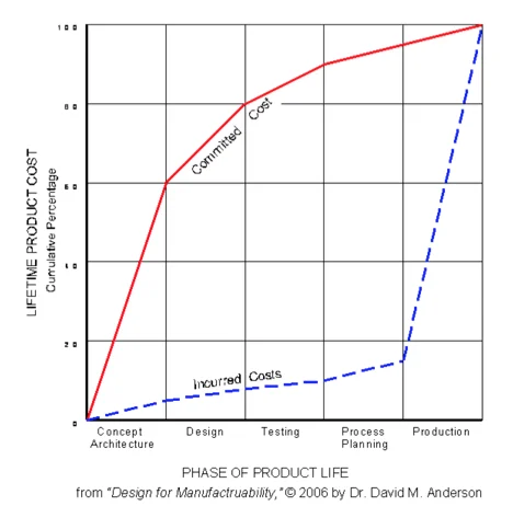

Typically, 80% of future committed costs can be calculated before completing the design stage, where incurred costs are still below 10%. Knowing this, the best place to identify cost reductions is in the prototyping phase and not during production.
phase of a product life
