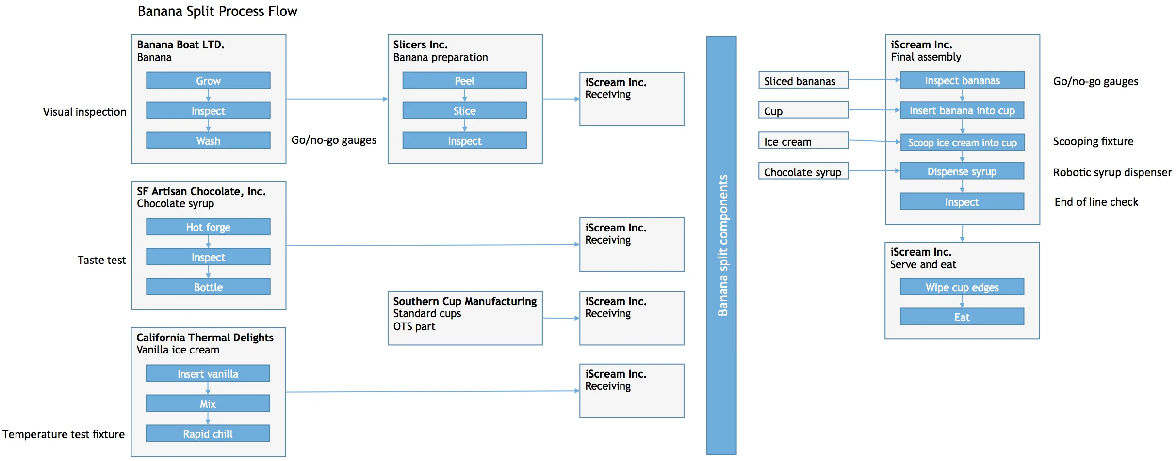

1. Build a production flow (PFlow)
A PFlow is a flowchart that shows each step of the assembly. It is a working document, starting out as a conceptual guideline or sketch, but as the design moves forward, it should begin to include as much detail as possible (eg. how the assembly is done, where, by whom, how to verify each step is done correctly). Mapping the process concretely often quickly reveals inefficiencies, places where parts can be or need to be combined, required sub-assembly steps, and any impossibilities in the assembly process.
A PFlow is also a nice tool to use when identifying and selecting vendors for production, as it gives an idea of the capability, capacity, and repeatability that will be required of them. It also provides a structured way to identify assembly steps and provide feedback in both directions.
![Process Flow](https://www.fictiv.com/wp-content/uploads/2016/01/Process-Flow.png)

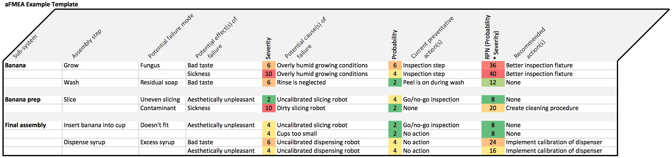

2. Iterative assembly failure modes and effects analysis (aFMEA)
Often built from the PFlow, the aFMEA is a list of the possible failure modes associated with each assembly step and their downstream effects. For instance, if a bolt is not sufficiently tightened during assembly, the possible effect is the in-use failure of the product. For each failure mode associated with a high-risk effect (for instance, product failure), mitigation should be identified to eliminate the source of the failure (for instance, test bolt tightness with a torque wrench, and add a thread locking compound). Common mitigations are adding fixtures to ensure correct assembly, testing and verification steps, and poka-yoke features that prevent incorrect assembly. What you get out of an aFMEA is very dependent on the resolution of the design, so it should be started early and improved as parts and features are refined.
An aFMEA can and should include other relevant considerations such as how assembly is verified and tested, whether or not it can be disassembled, and how the product is serviced. It can often be a useful tool to help evaluate obviously challenging parts/components early in the design process, and to figure out which aspects of the assembly can be eliminated, and what must be addressed through mitigations. At every substantial design change, walk through the assembly to see if the aFMEA is still applicable.
![partial aFMEA](https://www.fictiv.com/wp-content/uploads/2016/01/partial-aFMEA.png)
