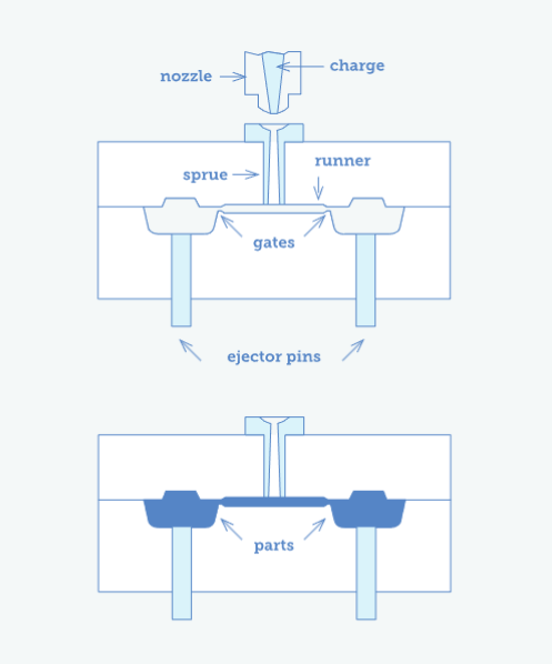

Injection molding is a fast and efficient way to produce plastic parts. The tool that it uses, an injection mold, has two main parts: the core and the cavity. These two halves of the mold come together, and molten plastic is injected into the tool.
Once the molten plastic cools, the two halves of the mold separate and the part is ejected. Depending on the construction of the mold and the part quantities that you need, this process can be repeated tens, hundreds, or many thousands of times.

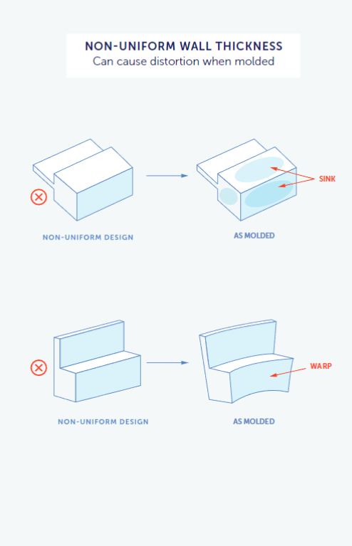

Uniform Wall Thickness
Whenever possible, apply a uniform wall thickness to your part. This best practice promotes more consistent cooling and, consequently, more consistent shrinking.
You can use walls with different thicknesses, but they’ll cool and shrink at different rates. This may cause sink, warp, and other injection molding defects.

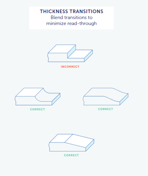

C. Thickness Transitions
Best practice is to smooth, or blend, transitions between areas with different wall thicknesses to minimize stress concentrations that can result in part failure.
Injection molding wall thickness transitions

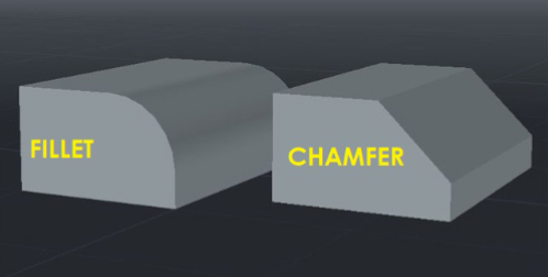

There are two main ways to achieve these transitions: chamfers and fillets.
  • Chamfers are angled edges where two surfaces meet.
  • Fillets are rounded corners or edges.
Designing Chamfers and Fillets for injection molding wall thickness transitions
Smooth transitions aren’t the only way to avoid stress concentrations, however. Using rounded corners instead of sharp ones can help.

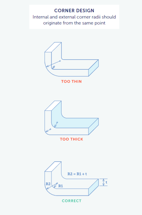

D. Corner Design
Sharp edges don’t just concentrate stresses. They also increase part costs because they require molds that are made with electrical discharge machining (EDM).
Sharp corners are a good place for parting lines, as we’ll see later in this guide, but it’s best to use them wisely and, where possible, use rounded corners instead.
Rounded corners limit stress concentrations and minimize differences in shrinkage as the plastic material cools. They also help to control tooling costs and enable the molten plastic to flow more readily throughout the mold.
When you apply rounded corners to your part design, follow these guidelines:
  • Make the internal radius at least 50% of the wall thickness
  • Make the external radius the sum of the inside radius and the wall thickness
  • Start the internal and external corner radii from the same point
Injection Molded Corner Design

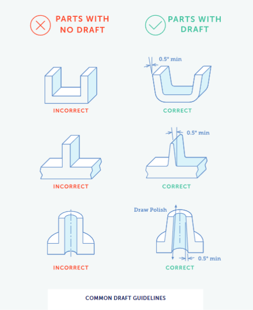

E. Draft Angle Design
Draft is an angle you apply to vertical walls so that parts will eject cleanly from the mold. This taper can also decrease tool wear and reduce cooling times, both of which help to control costs.
When specifying the amount of draft to apply, consider the following.
  • The resin you’re using
  • The standards you’re following
  • The part’s finish
  • The mold’s construction
Injection Molding Draft Designs

Finally, remember to set the draft angle based on the mold’s draw, or how it separates. Otherwise, the part may not stay in, or stick to, the half of the mold that contains the ejector
system. Consider both the draft on the part’s vertical walls and on part features.
For example, in the case of a rectangular part with four through-holes, drafting the holes toward the cavity could cause parts to stick there instead of to the core. A better approach would be to draft the holes toward the core where the ejector system is located.

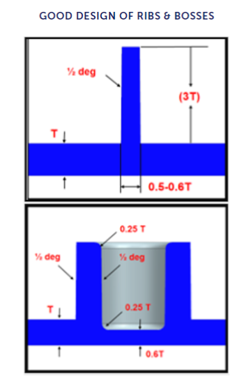

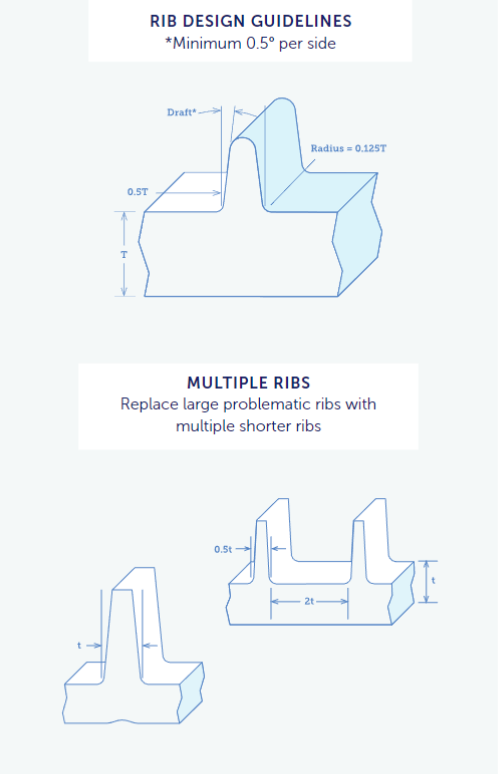

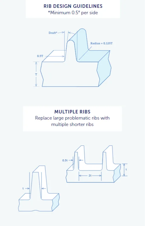

Ribs

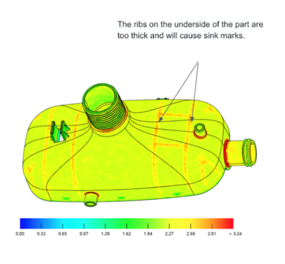

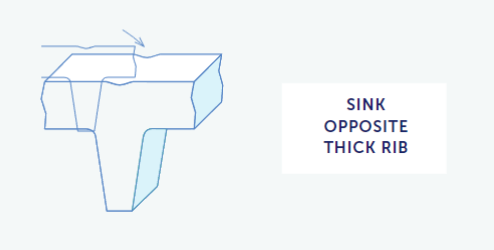

Ribs are vertical features that add structural integrity and increase load-bearing capacity.
Thick ribs are prone to shrinkage, however. If a rib is too thick, sink marks may appear on its opposite side and mar the part’s finish.
Injection Molding Sink Design
To avoid these problems, follow these best practices:
  • Wall Thickness: Make the rib’s wall thickness 50% to 60% (0.5 to 0.6 T) as thick as the nominal wall.
  • Fillets: Add a fillet to the bottom of the rib. Keep the radius of this fillet near 0.25T-0.5T, where T is the nominal wall thickness. Don’t exceed 0.010 inches for the radius.
  • Height: Keep ribs as short as possible and do not exceed 2.5T. If the height of a rib is a problem, use multiple shorter ribs.
  • Draft: Apply draft to ribs and use at least 0.5 degrees per side.
Injection Molding Rib Design

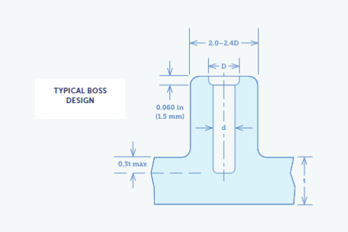

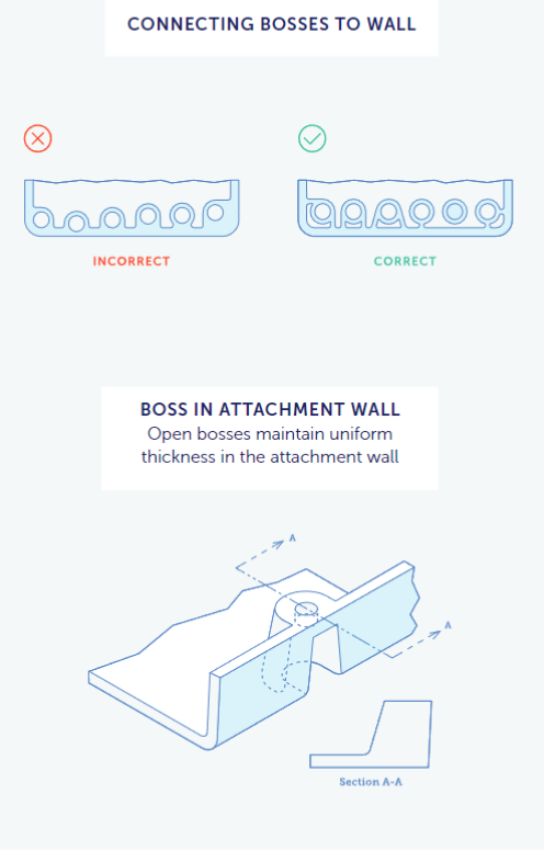

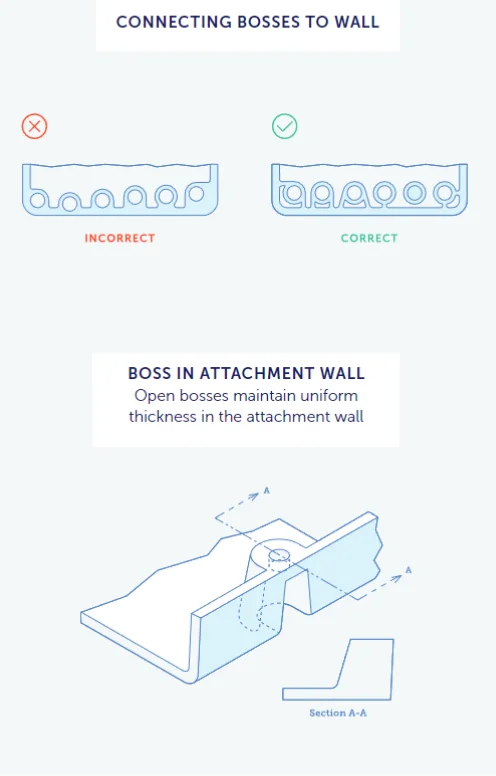

Bosses
Bosses are vertical features that support assembly and increase a part’s structural integrity. They can accommodate fasteners such as screws and, as with dowel pins, smaller bosses can be inserted into larger bosses within walls.
Injection Molding Boss Design
When designing bosses, remember the following:
  • Location: Place bosses where more structural integrity is needed, such as at screw slots.
  • Diameter: Don’t make the holes too small — they will shrink as they cool.
  • Thickness: Avoid sink marks by making the boss thickness no more than 60% of the overall wall thickness.
  • Walls: Consider how bosses will attach to walls — they need to align properly.
How to Design Injection Molding Bosses

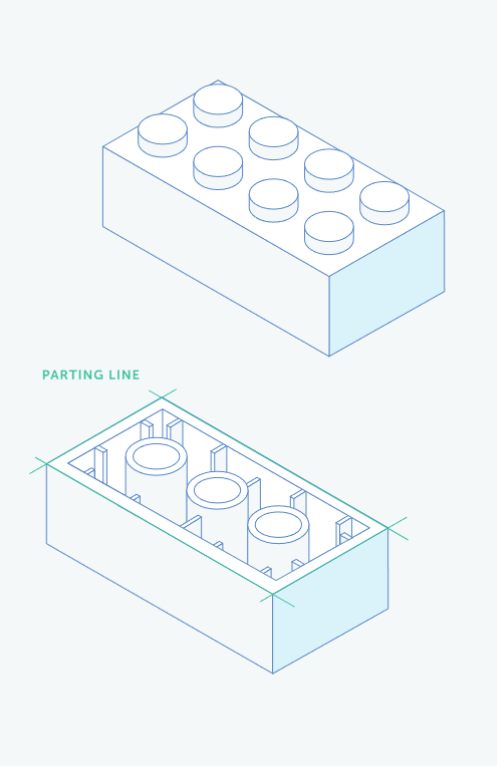

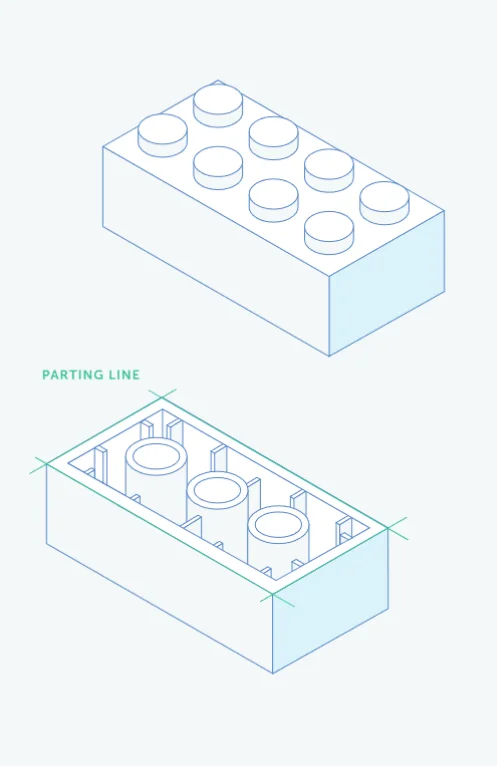

H. Designing Parting Lines
Injection molds have a parting line where the tool opens and closes. Sometimes, the parting line is right down the middle of the injected molded part. That’s usually what designers think of when they envision a parting line, but that’s not always the case – or even a best practice.
Take, for example, a LEGO® brick. The parting line is not down the top-middle of the brick, where it would be very noticeable. Rather, the parting line is along the brick’s bottom edges so that you have to turn over the brick to see it.
Designing Injection Molding Parting Lines
Sharp edges concentrate stresses but they’re a good place for parting lines because they simplify mold construction, which helps to reduce project costs. Avoid filleted surfaces, however,
because they don’t work well with parting lines:
  • Filleted surfaces require a tight tolerance mold, which increases costs.
  • They increase the risk of flash, an injection molding defect that can occur when the two halves of the mold don’t come together cleanly.

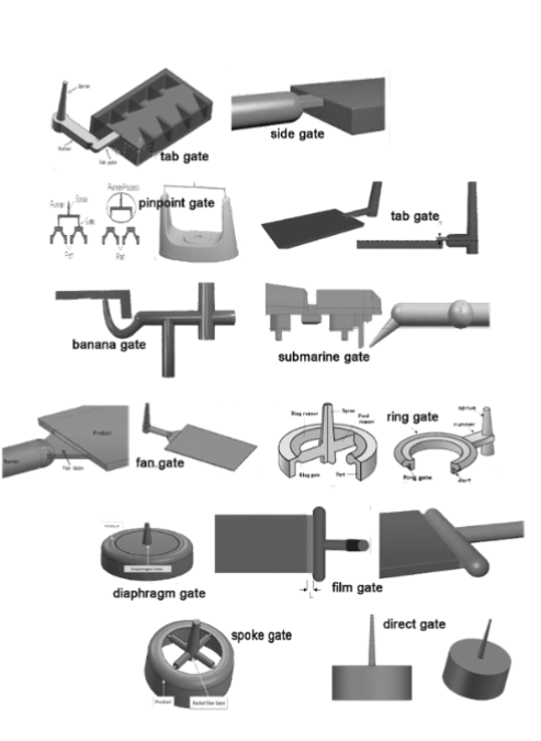

I. Design Guidelines for Gates
Gates are openings in an injection mold that allow molten plastic to enter the cavity.
  • Gate size is important because larger parts need larger gates to support higher-volume flow.
  • Gate location matters because gates can determine where warping occurs, or where there are weld lines, sink marks, voids, or other injection molding defects.
Designers also need to consider gate location because gates leave plastic protruding from the part’s surface. This extra plastic gets trimmed, but it’s best to put gates where any small marks that are left behind are least noticeable. Often, gates are placed along the mold’s parting line.
Trimming provides a way to categorize gates, but specific types of gates are recommended for parts with specific part features. Some gates require manual trimming. Others support automatic trimming where excess material is sheared during part ejection.
Injection Molding Gates
Manually Trimmed Gates
  • Edge or standard gates are recommended for flat parts. The gate’s cross-section is rectangular and can be tapered.
  • Fan gates have a large opening with a variable thickness. They permit the rapid filling of large parts and fragile mold sections.
