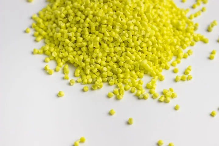

TPU injection molding is used to produce parts made from thermoplastic urethane (TPU), a type of thermoplastic elastomer (TPE). There are six major types of TPEs, a group of materials that combine the properties of plastic and rubber. TPUs can be based on either polyester or polyether urethane. They’re recyclable and provide excellent tear strength, abrasion resistance, and flex fatigue resistance.
If you’re thinking about selecting a thermoplastic urethane (TPU) for your next injection molding project, this article explains TPU’s material properties, advantages, disadvantages, design guidelines, and processing parameters. And you can plan your project’s timeline using this handy tool.

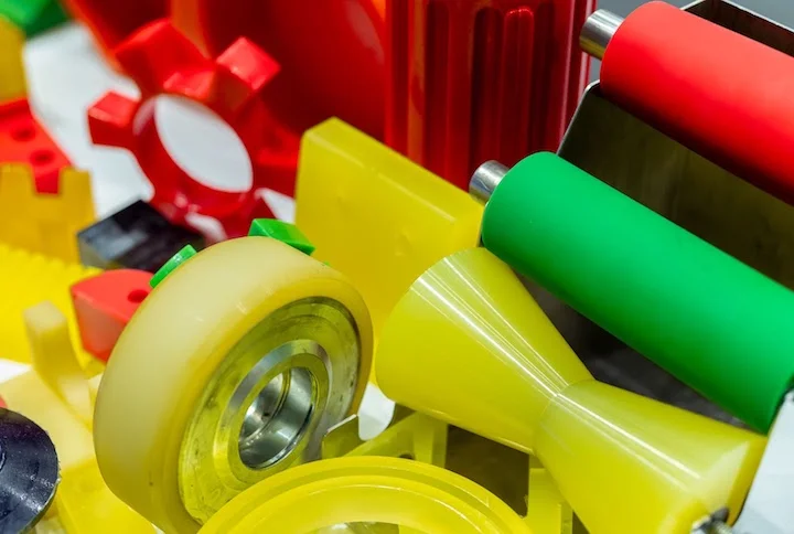

What are the advantages of thermoplastic urethanes (TPU)?
TPUs offer ten key advantages for injection molded parts.
  1. Elasticity: TPUs are highly elastic, so like rubber, they can be stretched and will return to their original shape.
  2. Toughness: TPUs are tough and durable, so they resist wear and tear, even under harsh conditions.
  3. Chemical resistance: TPUs resist a wide range of chemicals and can be used in harsh environments.
  4. Weather resistance: TPUs resist the effects of UV light (sunlight), ozone, and water. This makes them a good choice for outdoor environments.
  5. Low-temperature flexibility: TPUs can maintain their flexibility at low temperatures and withstand cold environments.
  6. Abrasion resistance: TPUs have a high degree of abrasion resistance. They’re great when there’s friction.
  7. Hydrophobic: TPUs are hydrophobic, which means that they resist the absorption of water. This makes them suitable for use in moist or wet environments.
  8. Good electrical insulation: TPUs are electrically insulating. Therefore, they’re often used in electrical and electronic applications.
  9. Biocompatibility: Some grades of TPU are biocompatible, meaning that they’re suitable for use in medical and dental applications.
  10. Versatility: TPUs can be used in a wide range of applications, from automotive and medical products to sporting goods and consumer electronics.
