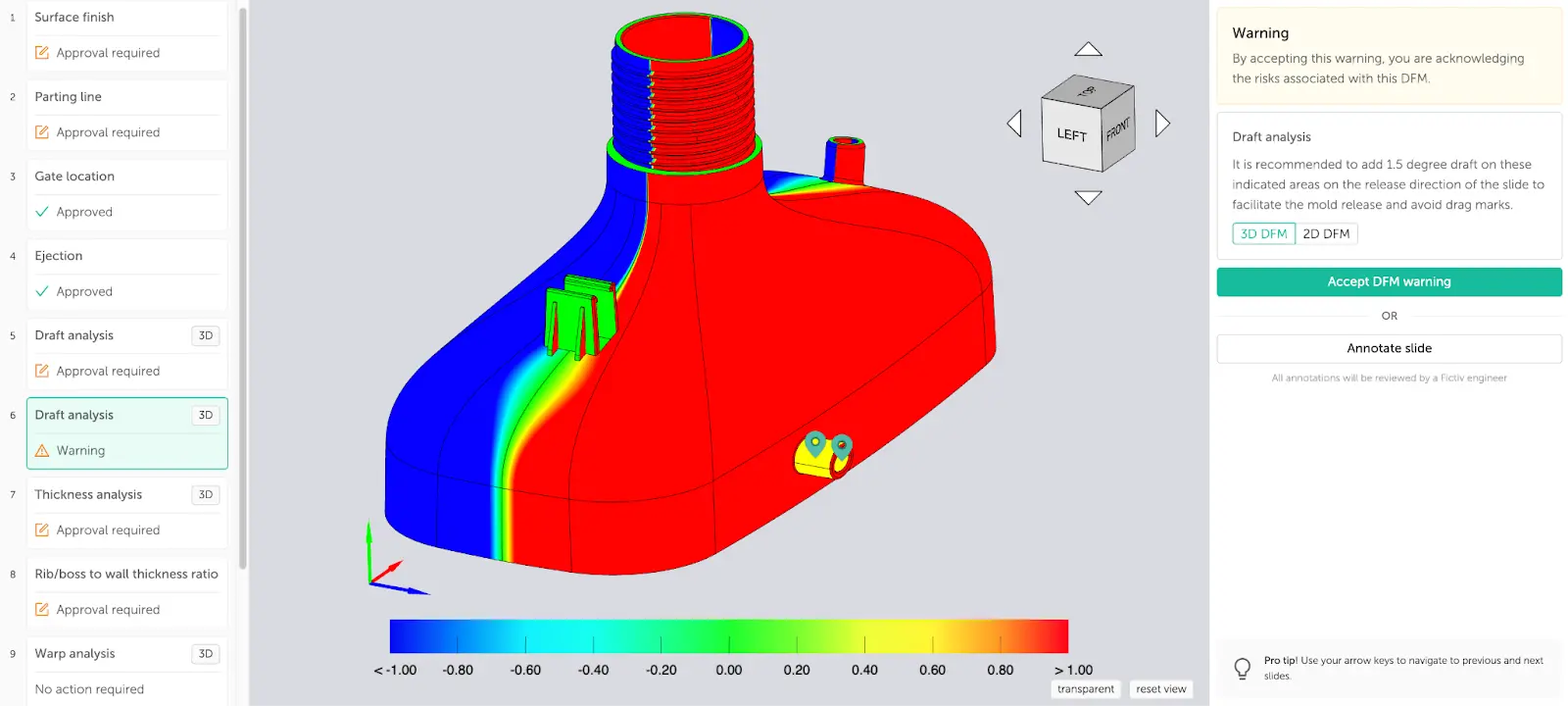

The solution to a defect may require the part designer, mold maker, and/or injection molder to perform the troubleshooting tips described in this article. Read on to learn more and download Fictiv’s Injection Molding Design Guide for our part design best practices.
DFM helps prevent injection molding defects
Fictiv provides you with DFM feedback so that you can minimize injection molding defects

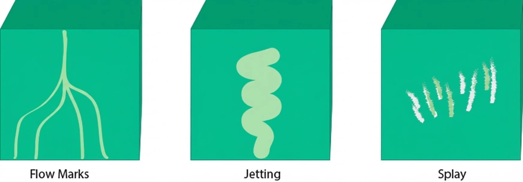

Flow Lines
Flow lines are unwanted streaks, waves, or lines on a part’s surface. When molten plastic moves through an injection mold at different speeds, the resin solidifies at different rates, which causes this type of defect. Flow lines also occur when sections of the mold have different wall thicknesses or when chamfers or fillets are too small. Following best practices for wall thickness can help to avoid flow lines.
An injection molder can reduce or eliminate flow lines by increasing the injection speed or pressure. If differences in wall thickness are the source of the problem, the mold maker may be able to place a gate in a thin-walled section of the mold cavity.

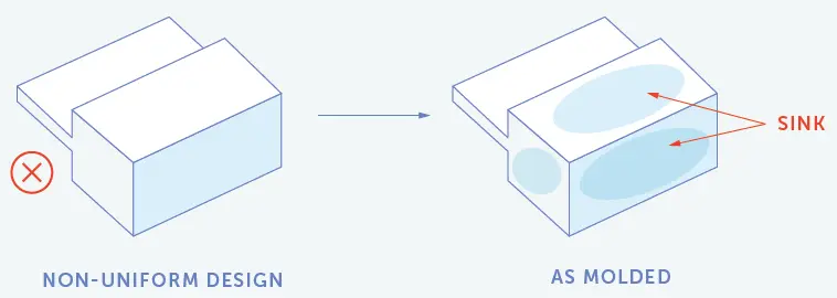

Sink Marks
Sink marks are dents, divots, depressions, or craters on the surface of a part. They appear on a part’s thicker sections, which take longer to cool. When there are significant thickness variations within a part, the thinner areas cool and contract more quickly. With sink marks, the outer skin on a thick section cools first and is pulled inward by the slower cooling of the thick material that’s beneath the part’s skin.
Injection molders can minimize sink marks by lowering mold temperatures, increasing holding pressures, or prolonging the hold time to allow for greater cooling. Part designers also play a role because most sink marks occur where ribs or bosses intersect the nominal wall. By following Fictiv’s design for manufacturing (DFM) guidelines, you can avoid sink marks.
Sink mark injection molding defects

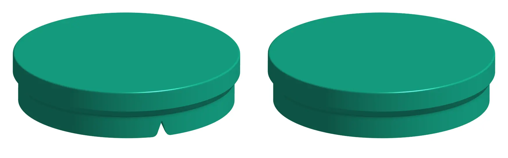

Short Shots
Short shots occur when molten resin doesn’t completely fill the mold cavity. As a result, the parts are incomplete and unusable. Short shots are caused by flow restrictions within the mold, often due to injection molding gates that are too narrow. Insufficient injection pressure and trapped air pockets are also potential causes, and material viscosity and mold temperature can contribute as well. Poor runner balance or excessive flow length-to-thickness ratios can also contribute to short shots.
Injection molders can reduce short shots by increasing mold or resin temperature or injection speed (fill rate). Alternatively, mold makers can incorporate additional vents into an injection mold to allow more air to escape. If a part design requires a thin section in its interior, placing the gate within that section can help.
Short shot defect in injection molding.
Table 4: Troubleshooting Short Shots
Project Role Troubleshooting Tips
Part DesignerMaintain uniform wall thickness and limit flow-length-to-thickness ratios.
Mold MakerAdd vents or increase their size.
Injection MolderIncrease the mold temperature or the resin temperature to slow the plastic’s cooling.Adjust the fill speed and volume.

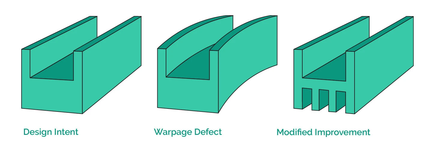

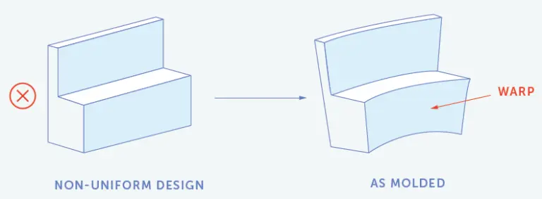

Warping
Warping refers to bending or twisting that occurs when internal shrinkage is uneven during cooling. For example, a box-like part that should have straight walls may end up with inward-curving walls instead. When regions of an injection-molded part cool at different rates, the resulting internal stresses can deform the structure. Often, this occurs when a thin wall is followed by a significantly thicker section.
Warping injection molding defect
Part designers can reduce the risk of warping by following best practices for injection molding wall thickness. Semi-crystalline materials are more likely to warp, so material selection can also play a role. For injection molders, it’s important to allow enough time for parts to cool at a sufficiently gradual rate.
Warping defect design improvement.
Table 6: Troubleshooting Warping
Part DesignerAvoid placing a thin wall after a significantly thicker section.Avoid semi-crystalline materials, which are more likely to warp because they have higher shrinkage rates.
Mold MakerAdd vents or increase their size to promote cooling.Move the gate from a thinner area of the part to a thicker area.
Injection MolderRaise the barrel temperature to promote flow.Raise the mold temperature to prevent premature cooling.Provide enough time for the parts to cool gradually.

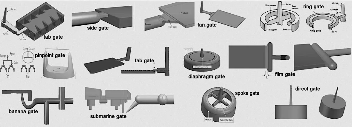

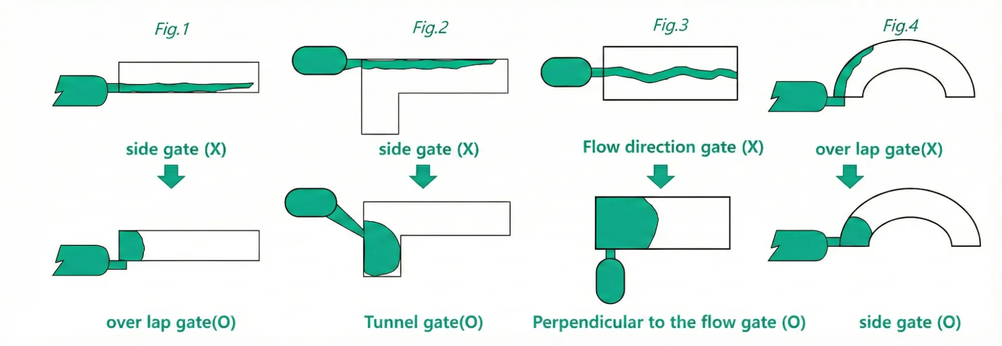

Jetting
Jetting is an injection molding defect that occurs when a jet of resin enters the mold too quickly and cools before the entire cavity is filled. The melted polymer sprays into the cavity with a snake-like motion but without first contacting the mold wall. Cosmetically, jetting produces thin, squiggly lines or wavy folds on a part’s surface. Structurally, jetting can reduce a part’s strength.
Visual comparison of jetting flow mark and splay defects in injection molding Image credit 3spacecom
Injection molders can reduce jetting by adjusting temperatures or filling more gradually. Mold makers can also increase the gate size to slow the jet’s speed. Optimizing the gate’s design can also ensure greater contact between the molten plastic and the mold. For part designers, choosing a lower-viscosity plastic can help to avoid jetting.
injection molding gate options for jetting defect improvement.
Mold makers can reduce jetting by optimizing gate design Image credit plasticmouldsnet
Table 7: Troubleshooting Jetting
Part DesignerChoose a lower-viscosity plastic.
Mold MakerIncrease the gate size to slow the jet’s speed.Optimize the gate’s design to ensure greater contact between the molten plastic and the mold.
Injection MolderAdjust temperatures and use more gradual fills.
