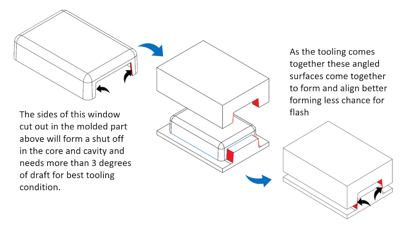

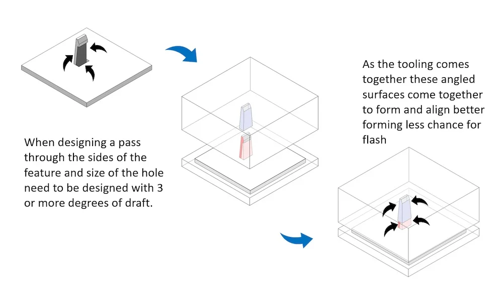

Surfaces that produce a shut-off condition in the tool require extra draft to reduce flashing. Shut-off is a term that’s used to describe an area where there isn’t any plastic, but the cavity of the tool presses against the core of the tool to stop the flow of material in that area. The more draft provided, the better the shut-off condition in these areas.
Here’s a couple examples of common tooling features that produce a shut-off and require an additional draft of 3 degrees or more, if possible.
- Vertical window or opening in side of part
![Tips to avoid flash]()
- Design pass-through to allow for straight pull
