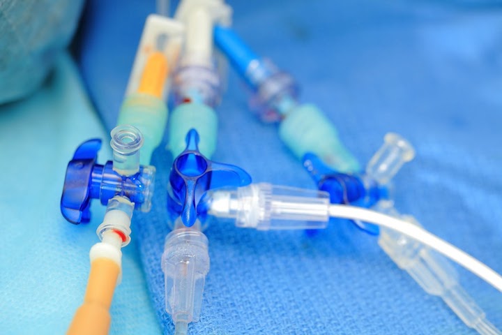

Material selection is one of the most important aspects of any engineering design. Depending upon your project requirements, you may need to balance the hardness or softness of a part in order to use a specific manufacturing method or tooling, or to meet end-use requirements for cushioning or impact resistance.
When working with rubbers or plastics, the typical hardness measurement methods and scales for metals (such as Rockwell and Vickers) cannot be used. Instead, we have what is known as durometer, which measures and evaluates softer materials like the plastics and rubbers used in medical tubing.
![Durometer and Softer Materials](https://www.fictiv.com/wp-content/uploads/2023/02/medical-catheter-close-patient.jpeg)

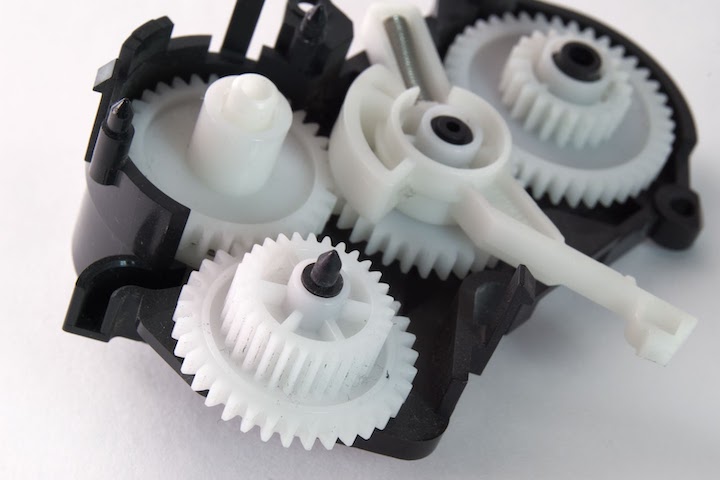

For plastics, durometer is critical for both injection molding and additive manufacturing. It’s also a consideration with parts that are CNC machined. That’s because durometer affects not only the final performance of a part such as a plastic gear, but also processing considerations such machine tools and deburring methods.
![Durometer and Harder Materials](https://www.fictiv.com/wp-content/uploads/2023/02/white-plastic-spur-gears-connected-complex.jpeg)

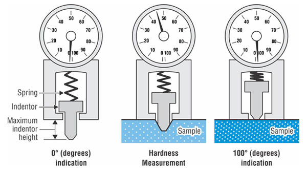

How Does a Durometer Tool Work?
As mentioned above, in order to test durometer, a tool called a durometer is used. This test generally consists of an indenter pressed into the surface of a material with a precise amount of force, then the depth of the indentation is measured and the device calculates a value. This is just a simple explanation, of course, and there are multiple factors in the testing specification — ASTM D2240 is the standard test method for durometer.
The image below shows how a durometer works.
![How Does a Durometer Tool Work?](https://www.fictiv.com/wp-content/uploads/2023/02/durometerOperation.jpeg)
Image Credit: Hoto Instruments
The value provided in a durometer measurement is not a unit of measurement like inches or pounds. Rather, durometer numbers are a dimensionless measurement compared to other materials that undergo similar testing parameters.

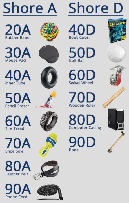

In order to capture the range of different hardnesses from various materials, 12 Shore hardness scales were created. The two most common scales are Shore A, which measures flexible rubbers to some semi-rigid plastics; and Shore D, which measures hard rubbers, semi-rigid plastics, and hard plastics.
Below you can see the hardness on the Shore A and Shore D scales of some common products, many of which are made of rubber or plastic.
![Shore A and Shore D Durometer](https://www.fictiv.com/wp-content/uploads/2023/02/HardnessShoreAandD1.jpeg)
Image Credit: Hapco Inc.
As a part designer evaluating your options, you’ll see material specifications with a specific durometer value for a material. Of course, material specs are only one element you need to consider when designing a part for injection molding — which is why we created an injection molding design guide that you can download and keep for reference.
