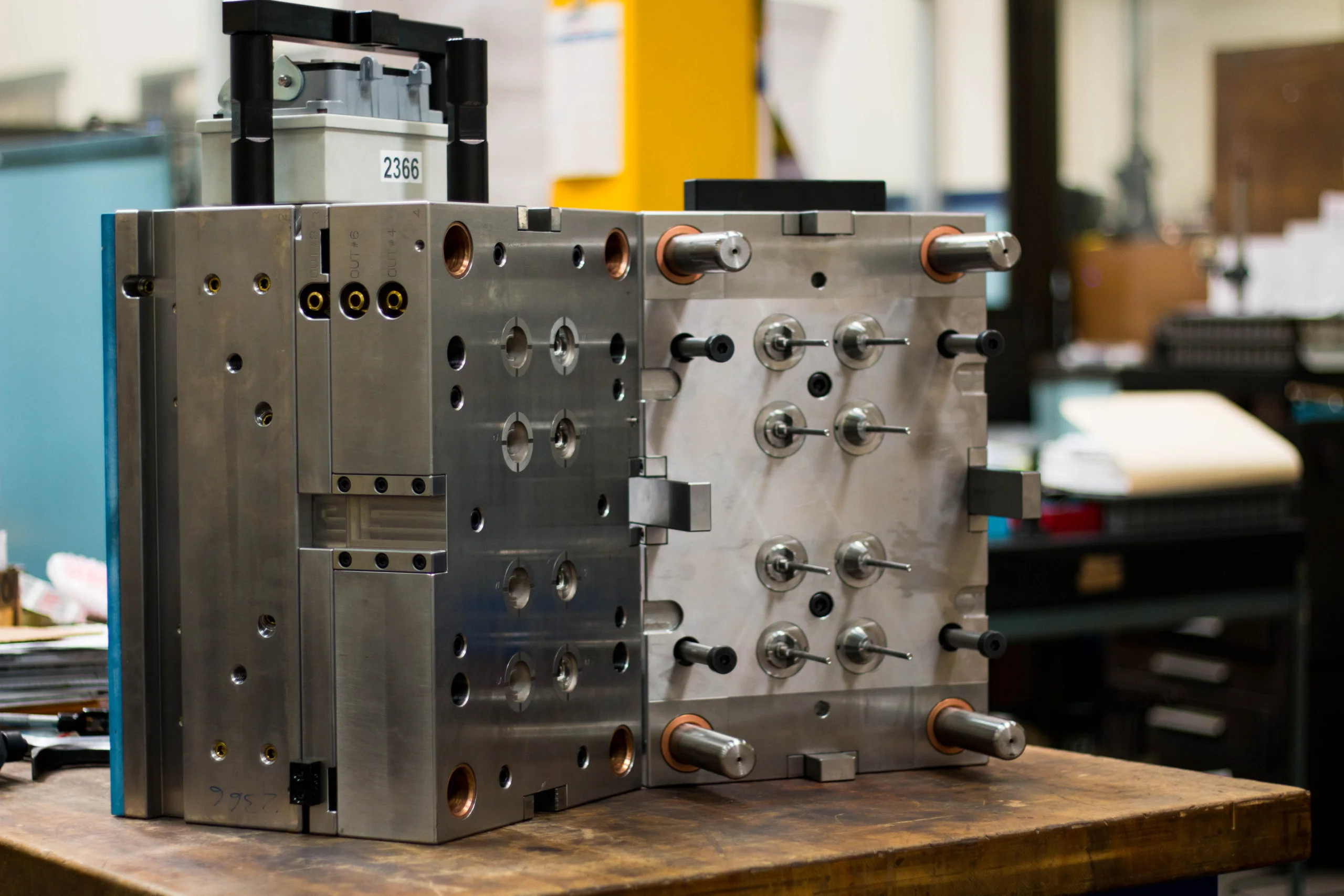

#1 Choosing the wrong mold material
Injection molds are usually made of either aluminum or steel. Hardened steel lasts longer than aluminum, but some designers think that steel molds are cost-prohibitive. With Fictiv, however, you can get hardened steel molds that are affordable. Plus, steel molds produce much higher volumes of parts than aluminum molds, which reduces the cost per part over time. Steel molds are also better at supporting more complex part features.
#2 Incorrect parting line placement
The parting line is where the two halves of the mold meet. For best results, parting lines should be paced on sharp, straight edges. Otherwise, molten material may escape and produce flash, or flashing. Also, it’s a good idea to locate the mold parting line so that it splits the draft (the angle applied to part faces to facilitate clean part ejection from a mold). If you place the parting line without considering the draft, scraping during ejection could damage the part.
![mold designs](https://www.fictiv.com/wp-content/uploads/2022/07/plastic-injection-molding-tool-shutterstock_559481938-scaled.jpeg)
#3 Inadequate venting
Air vents near the mold’s parting line enable air to escape as material fills the mold. As a rule of thumb, always vent at the end of the fill location. If there aren’t enough vents, or if vents are in the wrong places, air can pool and compress in pockets, then ignite, burn and discolor parts as they’re formed. Inadequate venting can also produce flow lines, wavy lines, streaks, or patterns.
#4 Gate problems
Injection molding gates slow the incoming molten material and regulate its flow as it enters different parts of a mold. If the gates are too small, parts may exhibit “gate blush,” a circular or halo-like pattern. Gates that are too small can also cause the uneven flow of material or result in knit lines, blemishes that occur where two resin flows meet. A mold with too few gates is susceptible to cooling problems, but a mold with too many gates introduces avoidable points of failure. Lastly, using the wrong type of gate, such as a tab gate for a thick profile instead of a thin one, can also cause problems.
#5 Cooling channel problems
Cooling channels circulate coolant throughout a mold so that injected molded parts can cool properly before the mold opens. As a rule, cooling channels should be as close as possible to the mold’s interior space. Avoid cooling channel dead-ends that form air traps, and use larger cooling channels with thicker walls. Poor cooling channel design can lead to sink, or depressions in the surface of a molded part that occur when different areas of a part cool at different rates.
