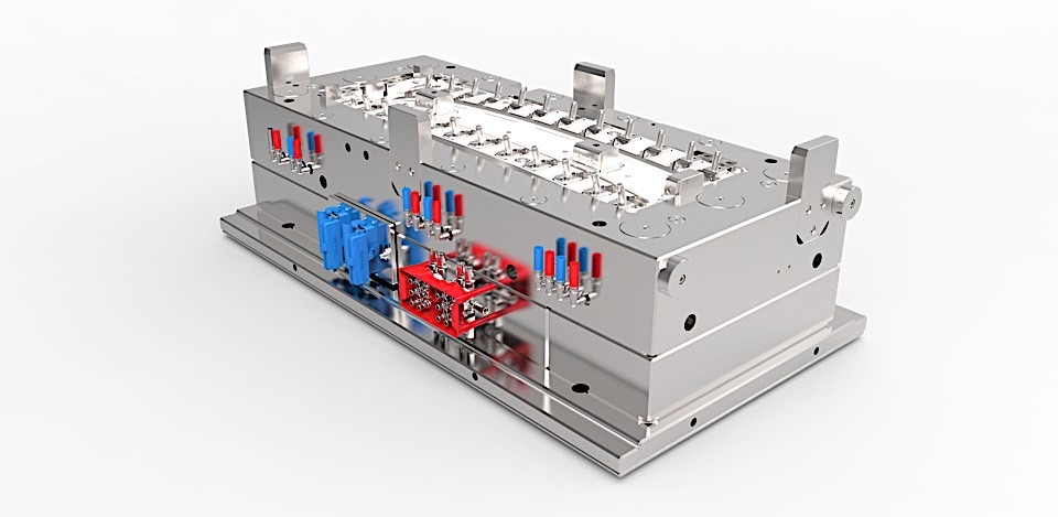

Is your injection molding project ready for success? Sure, you’ve thought about most of the injection molding manufacturing process. You’ve designed your mold with care, researched and selected the right material, and finished your CAD file or part drawing.
But have you considered the type of injection molding gate to use? A gate might seem like a small detail, but it affects tooling costs, cycle times, and part quality. The good news is that this article will help you to choose the right injection molding gate for your next project.

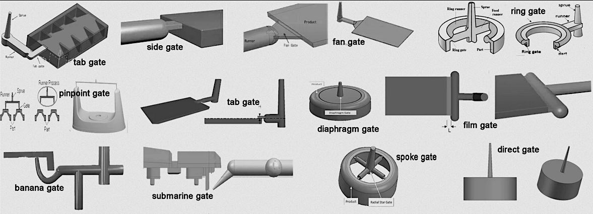

Manually trimmed gates include edge, fan, tab, direct, disc, ring, and spoke gates.
- Edge or standard gates are recommended for flat parts. The gate’s cross-section is rectangular and can be tapered between the part and the runner.
- Fan gates have a large opening with a variable thickness. They permit the rapid filling of large parts and fragile mold sections.
- Tab gates are used with thin, flat parts that require low shear stresses. A tab-like feature confines these stresses to the gate area.
- Direct or sprue gates are used with large, cylindrical parts. A sprue feeds material directly and rapidly into the cavity.
- Disc or diaphragm gates are used with round or cylindrical parts that require concentricity. Typically, these injection molding gates are difficult to remove and expensive to trim.
- Ring gates allow material to flow freely before moving into a uniform, tube-like extension for mold filling.
- Spoke gates are round gates that have a cross in the middle. They’re used to produce tube-shaped parts, but perfect concentricity is difficult to achieve.

Automatically trimmed gates include hot tip, submarine or sub gates, and pin gates.
- Hot tip gates support conical or round shapes that require uniform flow into the mold cavity. They are used in hot runner systems that keep the plastic in a molten state until it enters the cavity.
- Submarine or sub gates have a tapered channel and can help hide gate blemishes. These openings are sometimes called tunnel gates instead.
- Pin gates are used with fast-flowing resins and when a part’s cosmetic appearance is important. Pin gates are used typically with parts that cannot have vestiges on either side of the parting line.

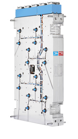

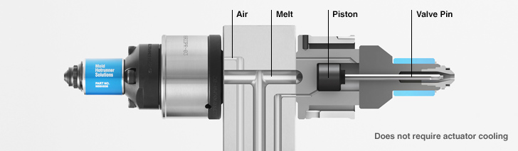

Depending on the mold system, other types of gates can be used instead. For example, hot runner systems can use valve gates where mechanical action causes a valve stem to move and then seal the gate opening. Valve gates cost more than other types of gates but can improve part quality by reducing defects such as witness marks. Valve gates also improve productivity because they support automatic trimming for faster cycle times.

![Image of an injection mold with multiple internal valve gate nozzles](https://www.fictiv.com/wp-content/uploads/2021/09/hot_runner_valve_gate_hot_half_stack_mold.jpg)
Gate size is another important consideration. In general, the width of the gate is based on the volume of the mold cavity and the depth of the gate is based on nominal wall size. However, because different materials have different flow rates, the type of plastic is a factor. For example, because polyethylene (PE) and polypropylene (PP) flow readily, gate depths may be based on only 50% of the part wall thickness.
The geometry, or shape of the gate also affects performance. For example, cashew-shaped sub gates are commonly used but not always the best choice in terms of flow restriction and fill pressure. For best results, gates should always taper down to the orifice to avoid flow restrictions. Otherwise, you may get flow imbalances and an increase in fill pressures.
