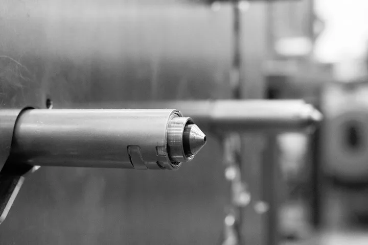

valve gates
Exposed valve gates

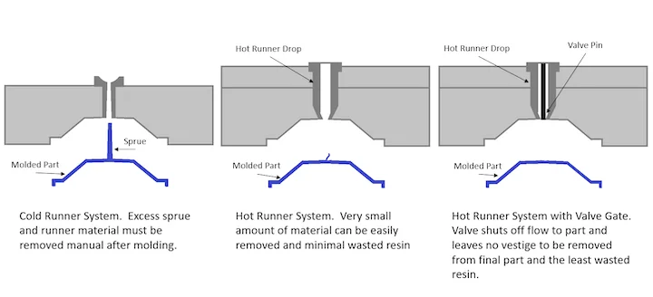

Less Waste
Valve gates reduce material waste because the valve is opened and closed during the injection cycle — cold runners have a large sprue and runner system, and standard hot drop runners lack a valve shutoff.
valve gating
Cold runner, hot runner, and hot runner with valve gate.
Reducing material waste is a good way to reduce part costs. If your project calls for making tens of thousands of parts, each small increment of material savings add up quickly. For production programs with high material usage, valve gates will reduce the amount of material that is wasted and, therefore, the amount you need to pay for material.

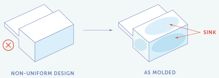

With these tighter controls of material flow and heat, you gain important advantages in controlling part blemishes during the injection molding process. Usually, a part is packed and the plastic is “frozen” in the sprue to keep material from flowing back out of the cavity. With a valve gate, however, the valve holds the material in place. This provides more consistent control and leads to parts with fewer pressure-related issues like sinking.
injection molding defects
Sink marks are a common type of injection molding defect
With tighter heat controls, you can keep the material at the proper temperature to make sure the plastic keeps flowing and fills the mold cavity completely. Valve gates also make weld lines less of an issue and give greater control to correct them if they do occur. These injection molding defects happen when two cool flow-fronts come back together again after separating.
