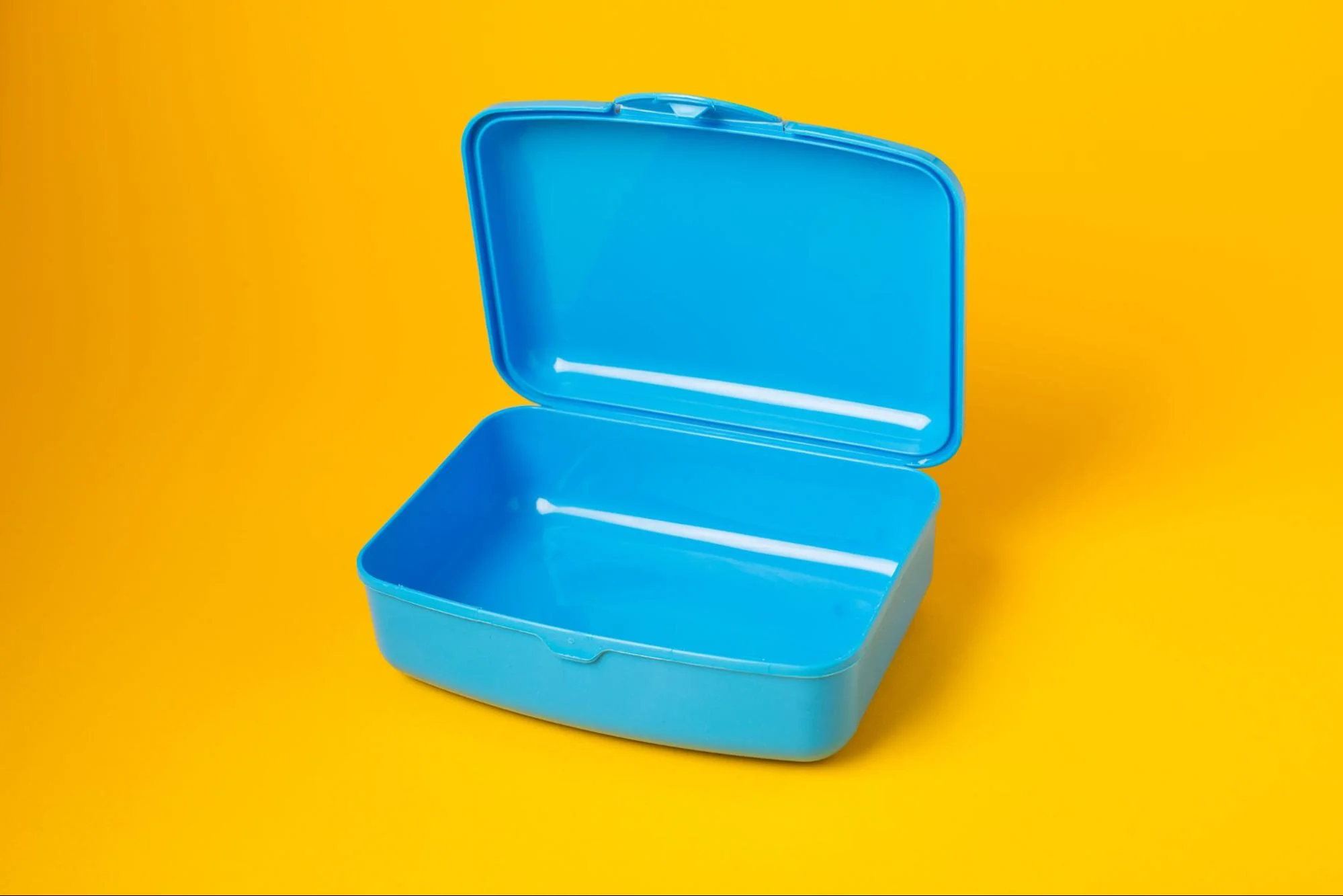

A one-piece plastic box with a living hinge
It’s alive!

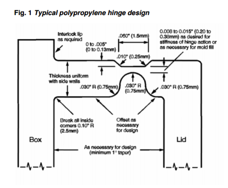

Living Hinge Dimensions and Design
Since its introduction in the 1960s, the actual dimensions in living hinge design have changed very little. Figure 1 shows the standard polypropylene design used for injection molding.
typical polypropylene hinge design

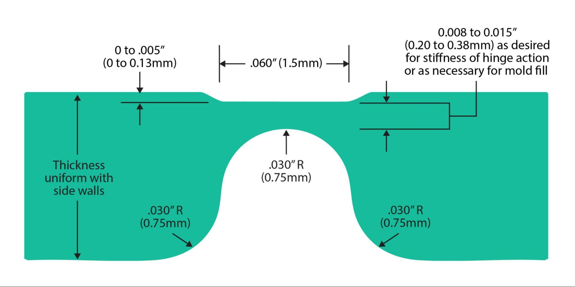

Hinge Thickness
 Typically, the hinge thickness should be between 0.2 mm and 0.5 mm, depending on the process and material.
For injection molding, it is usually best to start with a thinner wall, as it is easier to add plastic as needed (by removing tool steel) than vice versa.
 Hinge thickness can be calculated using this simple equation:
 T = H/5 to H/8

1. Add Generous Radii
Generous radii improve flow through the hinge during molding and reduce stress concentration during use.
2. Include “Shoulders”
“Shoulders” on the part create a flat recess. This ensures that the hinge will bend in the center and that the part can deform enough for the hinge to have room to close.
3. Thin and Flexible is Best
A thicker hinge may appear more robust, but the greater elongation on the surface can cause the material to exceed its yield point, shortening the lifespan of the hinge. A thinner hinge is more flexible.

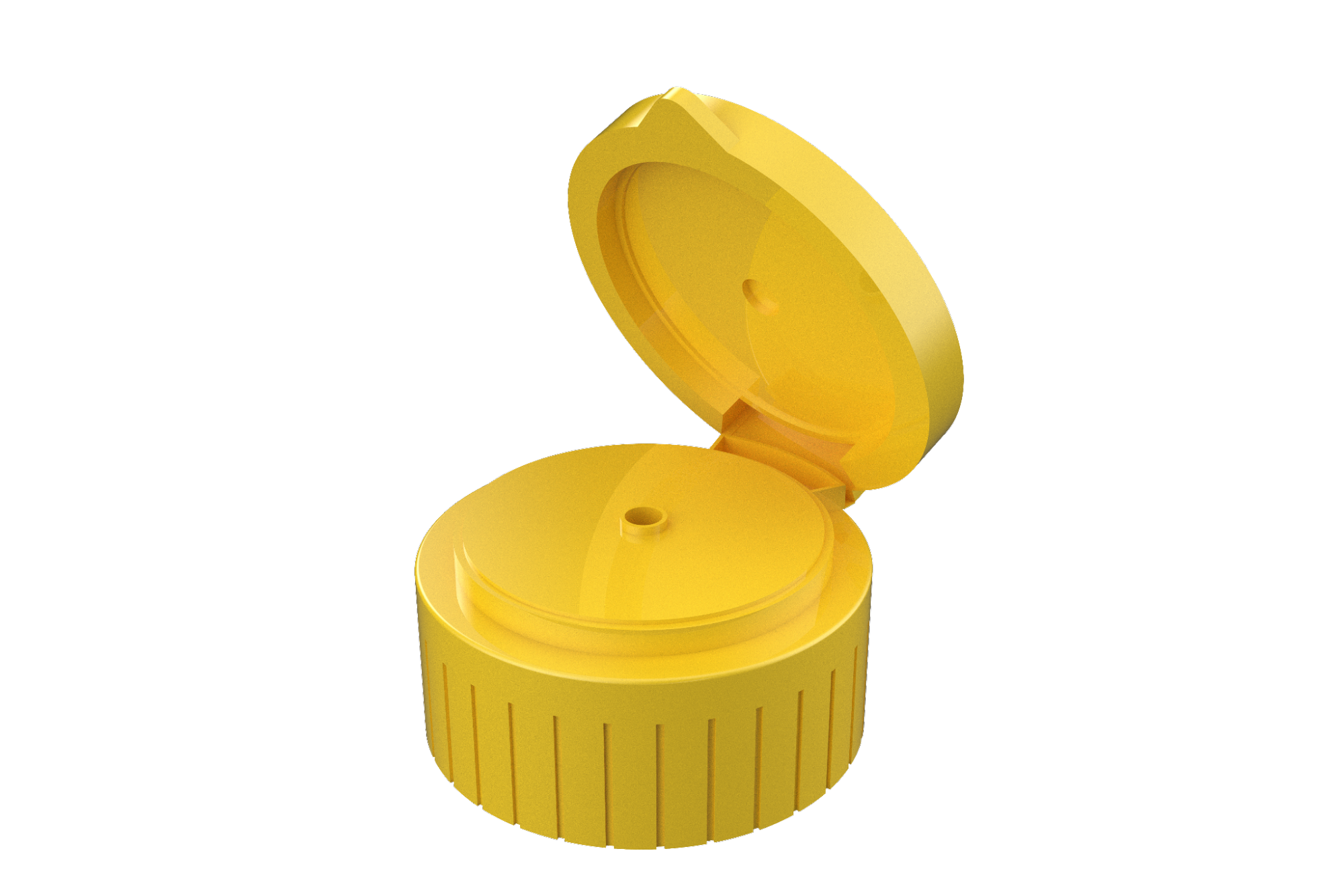

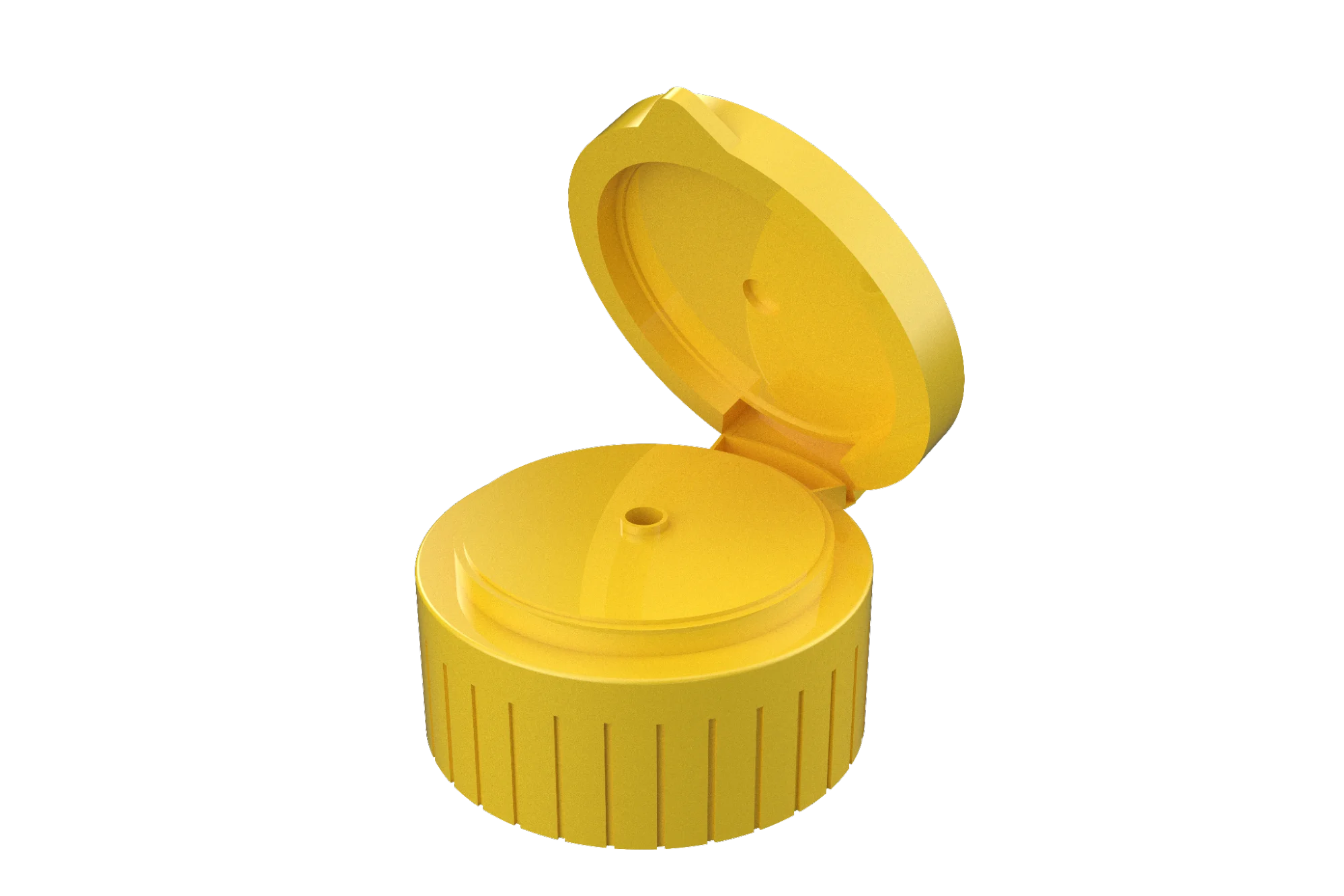

A plastic cap with a living hinge

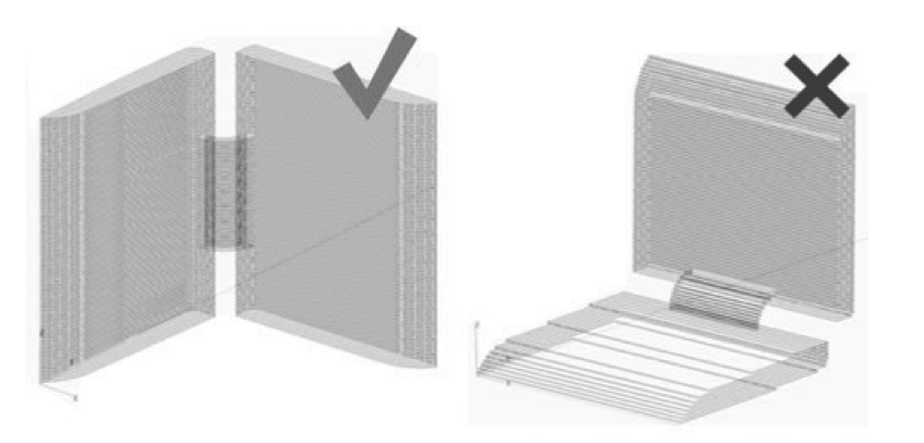

Design Tips for 3D-Printed Living Hinges
When creating hinges in 3D parts, the build orientation is very important. For the hinge to have maximum strength, the horizontal build plane should be perpendicular to the hinge direction.
Best results occur when the hinge thickness is at least twice the resolution of your print. Given that Nylon has a resolution of 0.254mm, we recommend starting with 0.5mm as a minimum thickness.
Following these instructions should ensure your print gets at least 100 flexes in its testing cycle.
