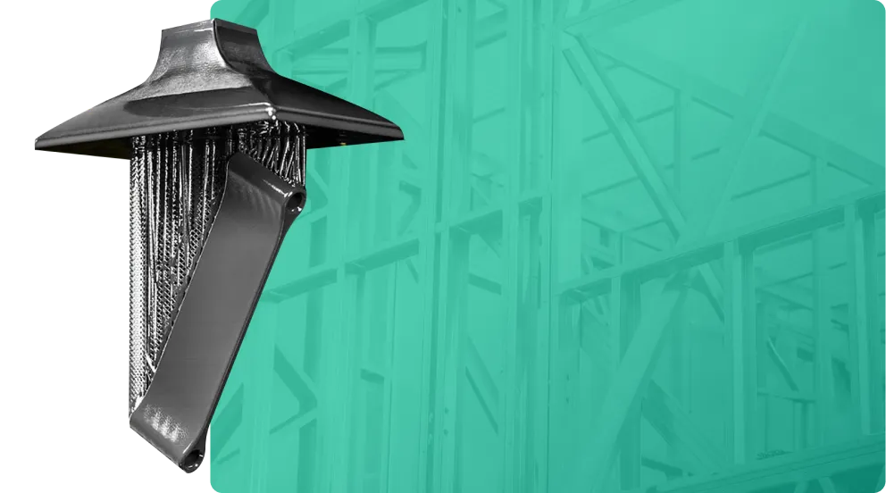

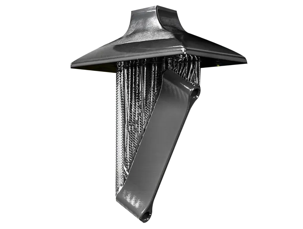

FPU 50 is an impact, abrasion, and fatigue resistant semi-rigid material that is a good choice for parts that must withstand repetitive stresses such as living hinges or friction fits. FPU 50 is mechanically comparable to polypropylene.
