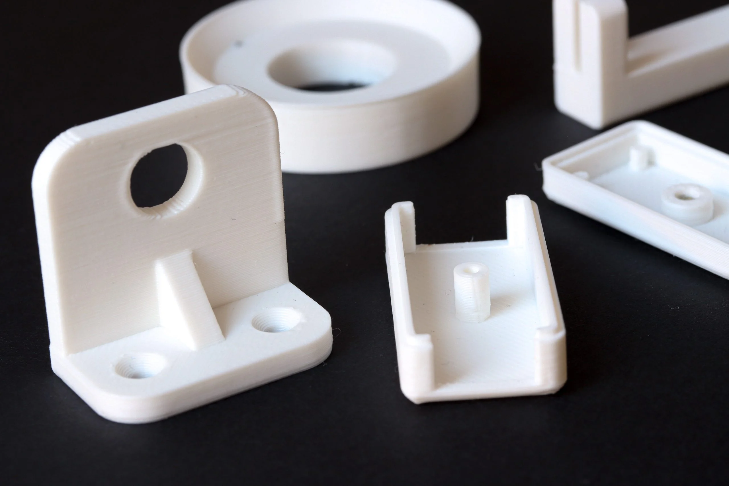

FDM (3D Printing)
FDM printed parts are anisotropic because layer-by-layer deposition creates interfaces between layers that have lower bond strength than the material within each layer. The Z direction (perpendicular to the build plane) is consistently weaker than X or Y. Typical tensile strength in Z is 15–40% lower than in XY depending on material, layer height, print temperature, and machine calibration.
This is a fundamental characteristic of the process, not a defect or a quality problem. The interlayer bond in FDM forms as adjacent beads partially fuse during printing, and it’s inherently weaker than the base material, regardless of print quality. FEA of FDM structural parts should use orthotropic material properties with a Z-direction knockdown applied, not the isotropic tensile strength from the manufacturer’s datasheet. Most FDM material datasheets report XY-direction properties only. Check whether Z-direction data is available for the specific material and use it if the loading direction is not purely in-plane.
