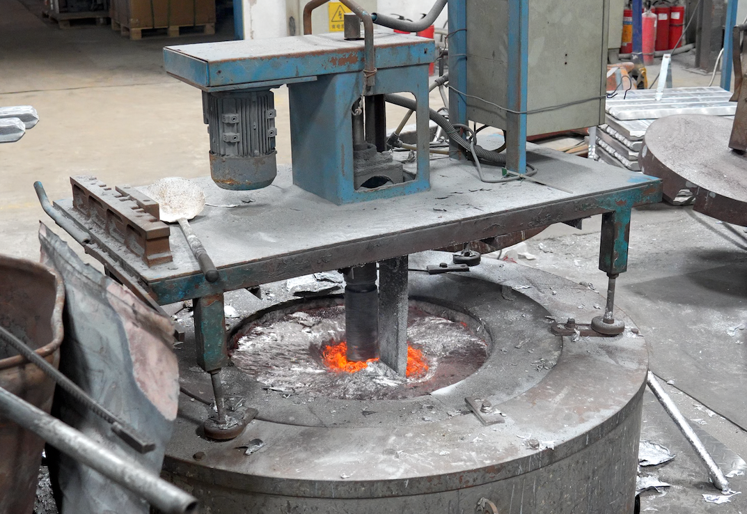

3. Material and Cleanliness Issues
The condition of the molten metal itself matters. Contaminants, dissolved gases, and oxides can become trapped during pouring, creating internal defects.
These factors often overlap. For example, porosity may result from both trapped gas and shrinkage during solidification, which makes root cause analysis difficult without deeper inspection or simulation.
Melt treatment and degassing prior to casting are critical for reducing gas porosity and improving part integrity

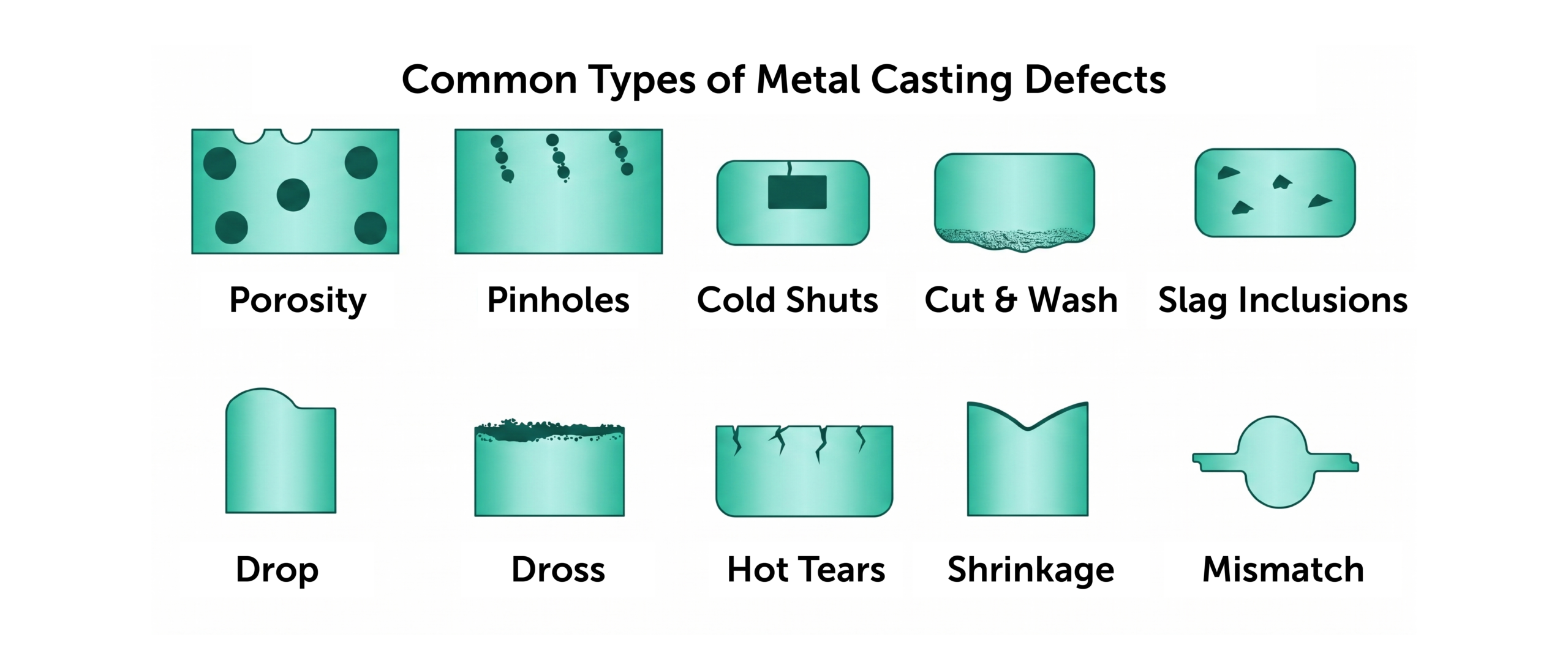

Most Common Metal Casting Defects (and How to Prevent Them)
Porosity
Porosity refers to internal voids within a casting that reduce structural integrity, fatigue resistance, and pressure tightness. It is one of the most common—and most difficult to diagnose—casting defects because it can originate from multiple mechanisms at once.
There are several forms of porosity, including:
  • Gas porosity caused by trapped gases or air entrapment during mold filling
  • Shrinkage porosity caused by metal contraction during solidification
  • Micro-porosity consisting of tiny dispersed voids that may not be visible without sectioning or CT scanning
Porosity ranges from isolated microscopic defects to larger cavities that compromise mechanical performance. In pressure-containing or structural components, even small amounts of porosity can become critical.

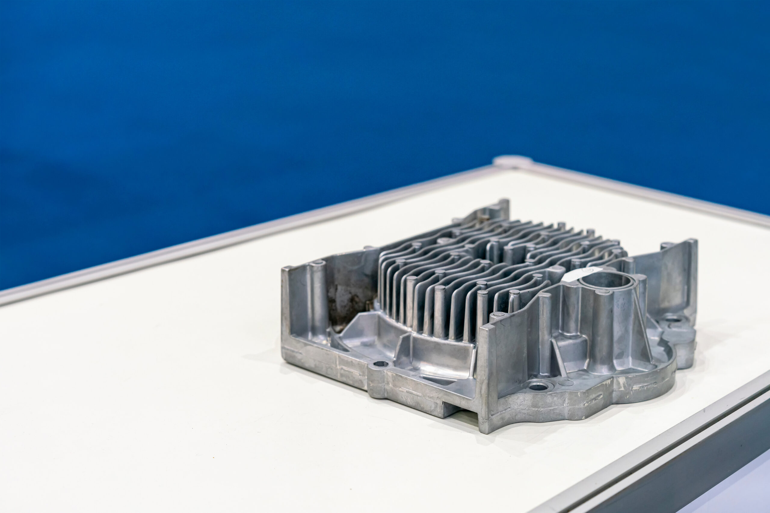

Learn more about how to design for casting and reduce defects with our Die Casting Design Guide
A die-cast part properly designed to reduce defects
A die cast part properly designed to reduce defects
