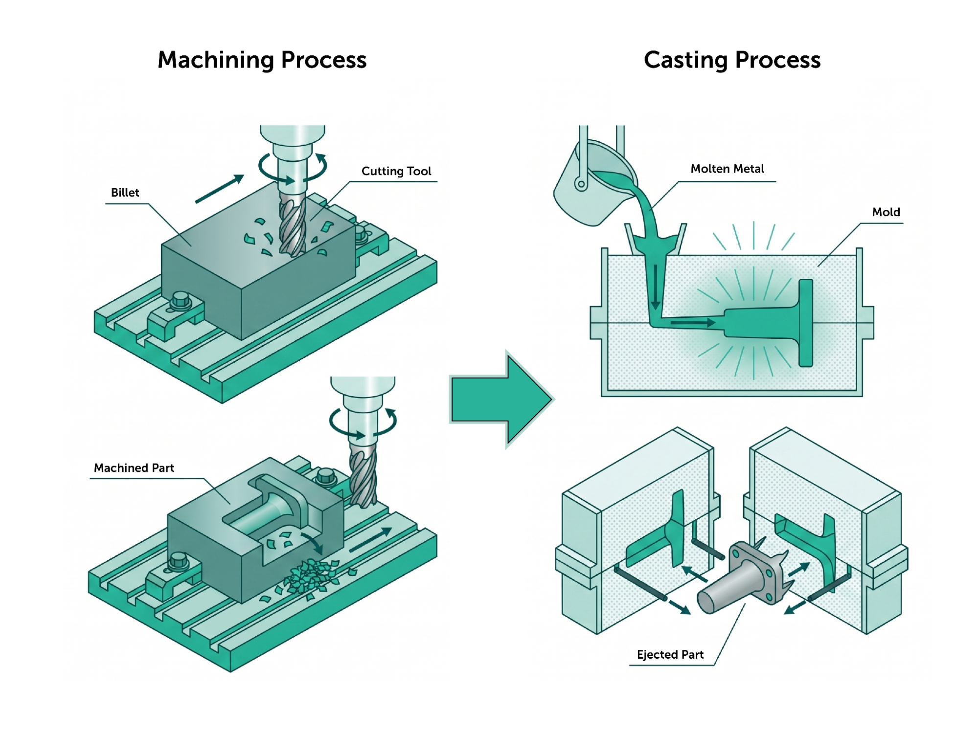

Formative casting vs. subtractive CNC machining
Formative casting vs subtractive CNC machining

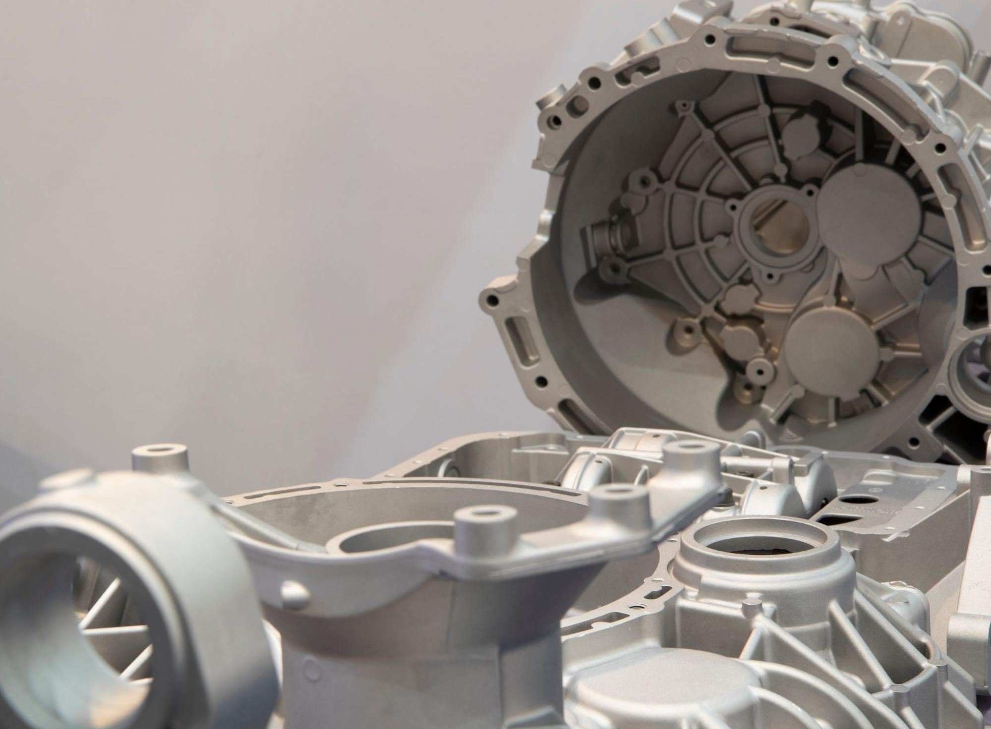

  • Complex Geometry: Organic shapes, undercuts, internal cavities, and complex curves require extensive 3D surfacing on a CNC mill.
  • 3+ Setups: If a machinist has to reposition the part multiple times to complete it, it’s a prime candidate for the geometric freedom casting provides.
  • High Scrap (Material Waste): Parts hogged out of large billets, where the final volume represents a fraction of the starting block, generate significant scrap cost at scale.
  • Weight and Wall Thickness: Thick-walled machined parts add unnecessary weight to the product. Casting allows the use of ribs and thin walls to maintain structural integrity while shedding mass.
Casting is typically worth evaluating when annual volumes exceed ~500 to 1,000 units, especially for parts with long CNC cycle times, multiple setups, or high material waste.
Examples of part geometry that are better suited for casting

To successfully transition a part from CNC to casting, engineers must reevaluate their design approach. Parts are no longer designed for CNC cutting tools. They’re designed for flowing liquid metal that solidifies in the mold.
Manufacturing Mindset Shift
A CNC mindset is subtractive: engineers may think in terms of tool reach, clearance, and machineability.
A casting mindset is formative: engineers may think in terms of flow, pressure, solidification, and cooling time.

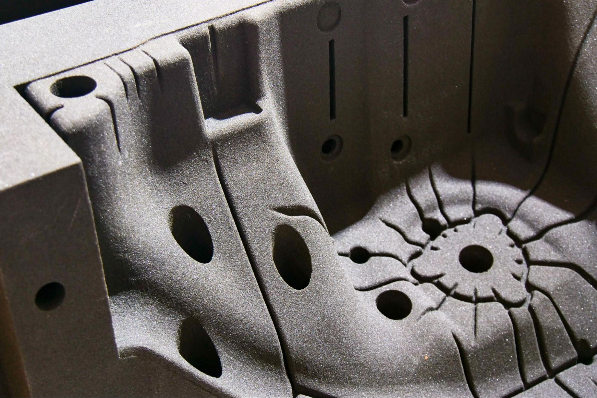

Feature Limitations: When designing for CNC, engineers avoid deep pockets due to tool chatter. In casting, engineers embrace cored-out pockets to reduce mass. However, it’s important to replace sharp internal corners with generous fillets to prevent stress concentrations and tearing during cooling.
Surface texture of a sand-cast part
Surface texture of a sand cast part

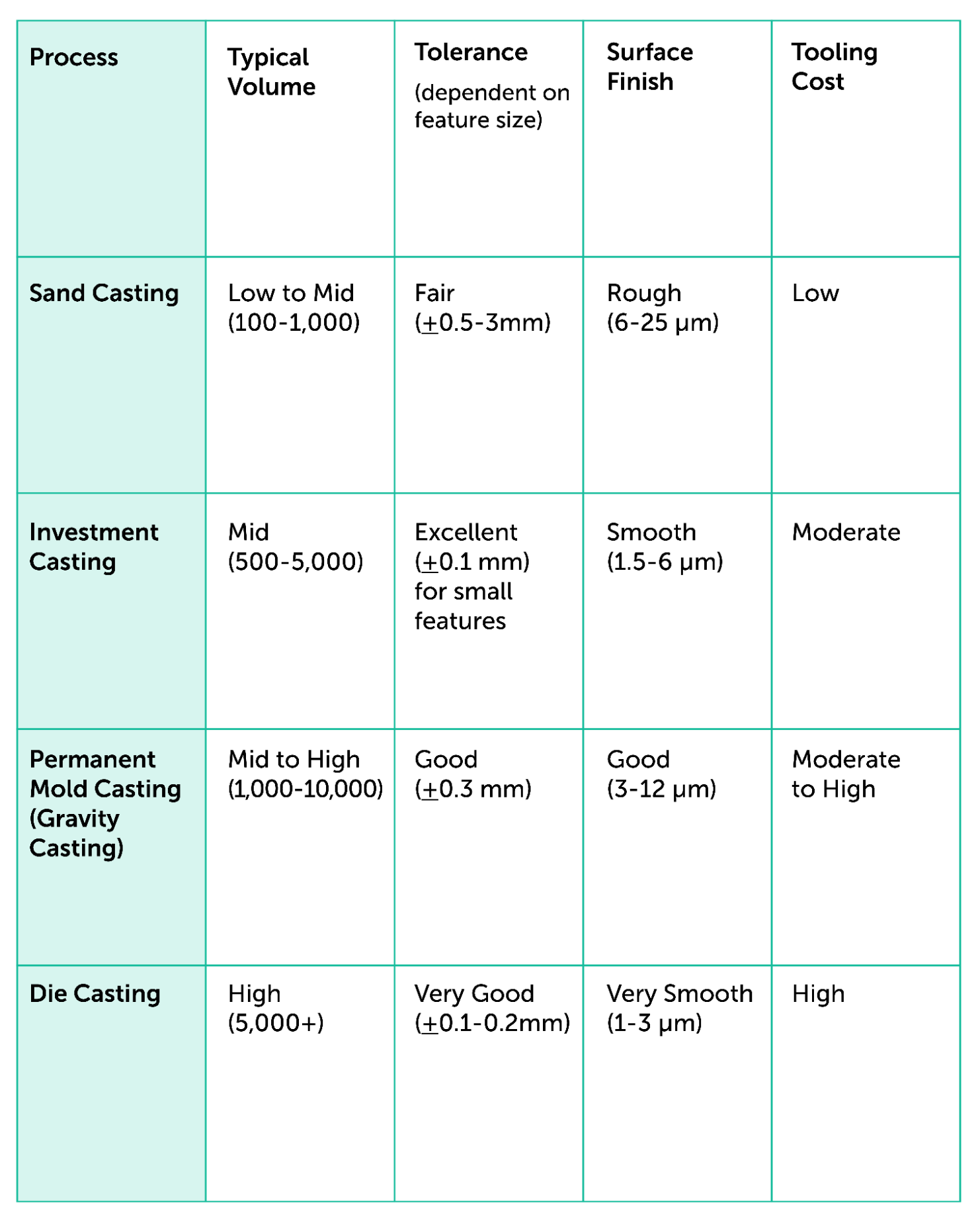

Selecting the appropriate casting process depends on part geometry, material requirements, and production volume, and is a key factor in achieving cost and quality targets. Matching the part’s requirements to the appropriate process ensures you don’t overpay for tolerances you don’t need, or end up with a process that can’t meet volume demands.
Casting Process Comparison
Other specialized processes, such as centrifugal casting, are used for axisymmetric parts like tubes and rings, but are less common for general part geometries.
Achievable tolerances vary by process, part size, and geometry. In some cases, advanced sand casting processes can achieve comparable or better accuracy than permanent mold casting.
Matching the Casting Process to Your Part
To choose correctly, evaluate your part against three pillars:
  1. Volume vs. Complexity: High volume dictates die casting; high complexity with lower volume is ideal for investment casting.
  2. Tolerance Needs: If you need features with no post-machining, investment casting or die casting are the strongest options.
  3. Material Compatibility: Not all alloys can be cast in all processes. For example, high-melting-point steels are rarely die-cast due to thermal degradation of the dies. These are great candidates for investment casting.

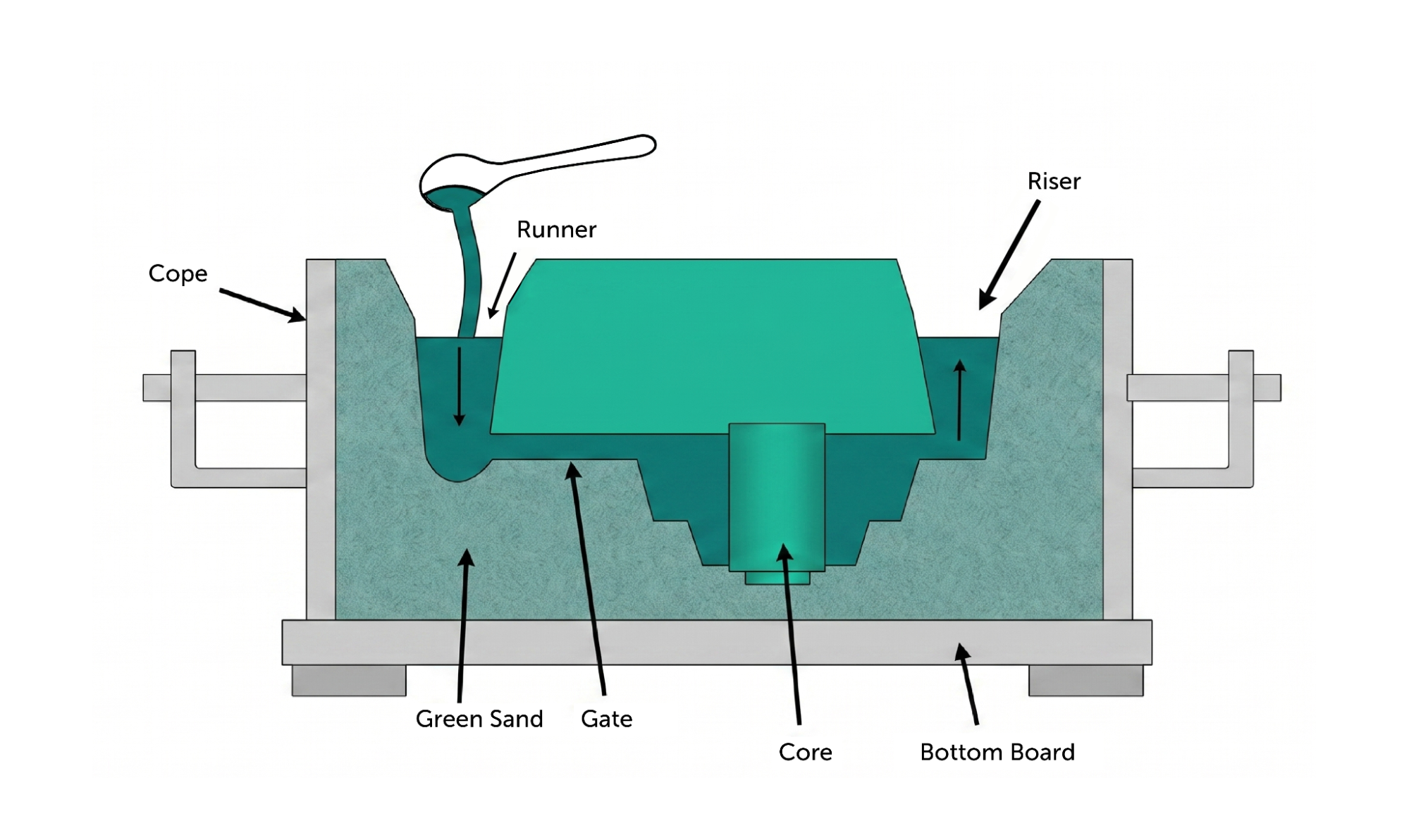

Sand Casting: Best for large structural components and low volumes. Sand casting requires large draft angles and generous tolerance allowances, but offers a significant reduction in raw material cost.

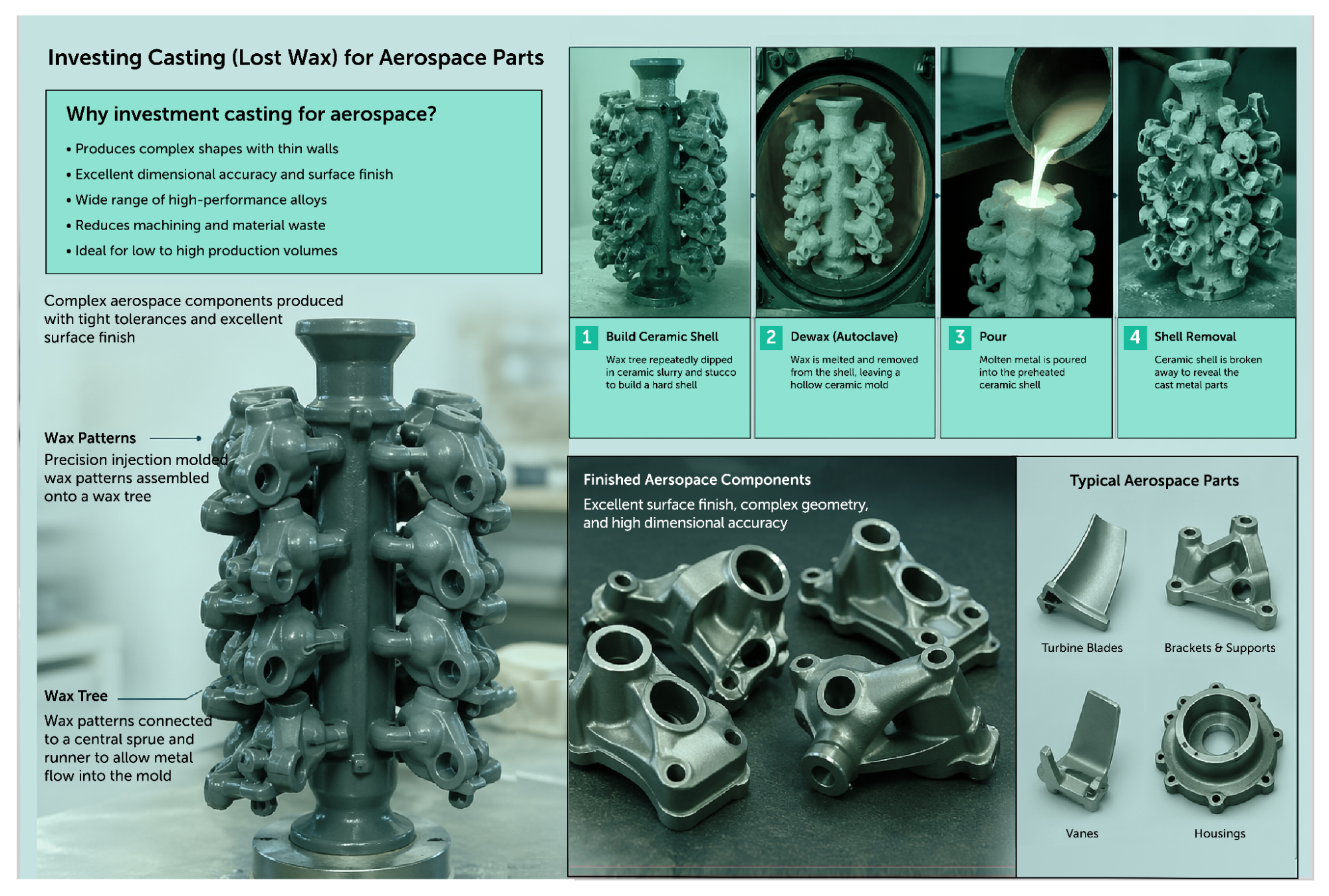

Investment Casting: Best for highly complex, intricate geometries, even with stainless steels or superalloys. Investment casting achieves near-CNC levels of detail without the tool-access limitations, provided heavy cross-sections are minimized to prevent shrinkage cavities.
Lost wax (investment) casting explanation
Lost wax investment casting explanation

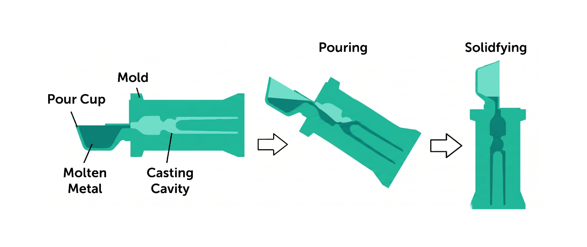

Permanent Mold Casting (Gravity Casting): Offers lower turbulence and lower gas entrapment than conventional high-pressure die casting (HPDC), but mechanical properties depend on alloy, process control, heat treatment, porosity limits, and inspection requirements. HPDC can have more gas porosity, but structural, vacuum, and high-integrity die casting can be engineered for demanding parts.

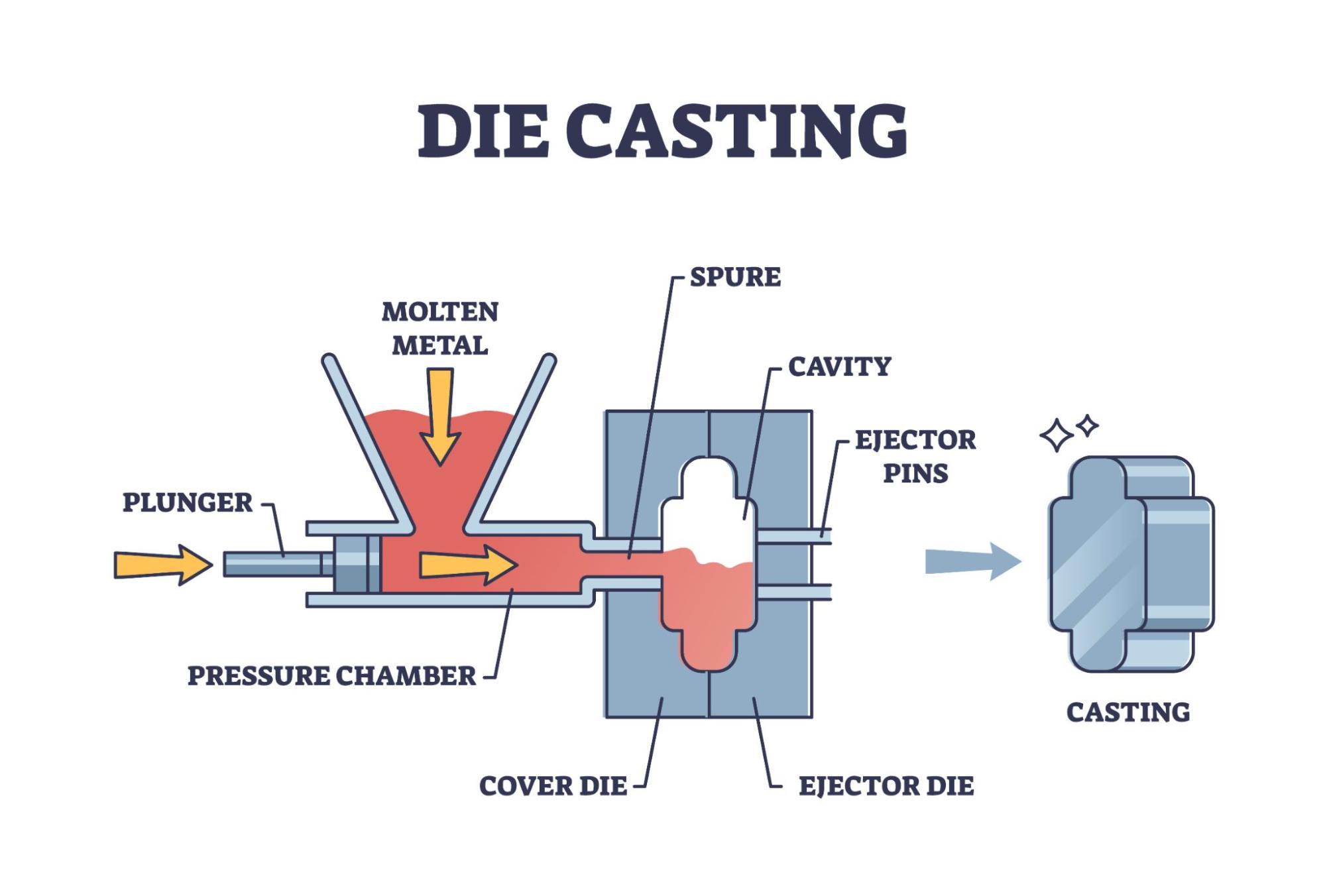

Die Casting: Best for high-volume and thin-walled parts or enclosures across a broad range of industries, most commonly in aluminum or zinc. Die casting offers fast cycle times and a low piece price, but demands high upfront tooling costs.

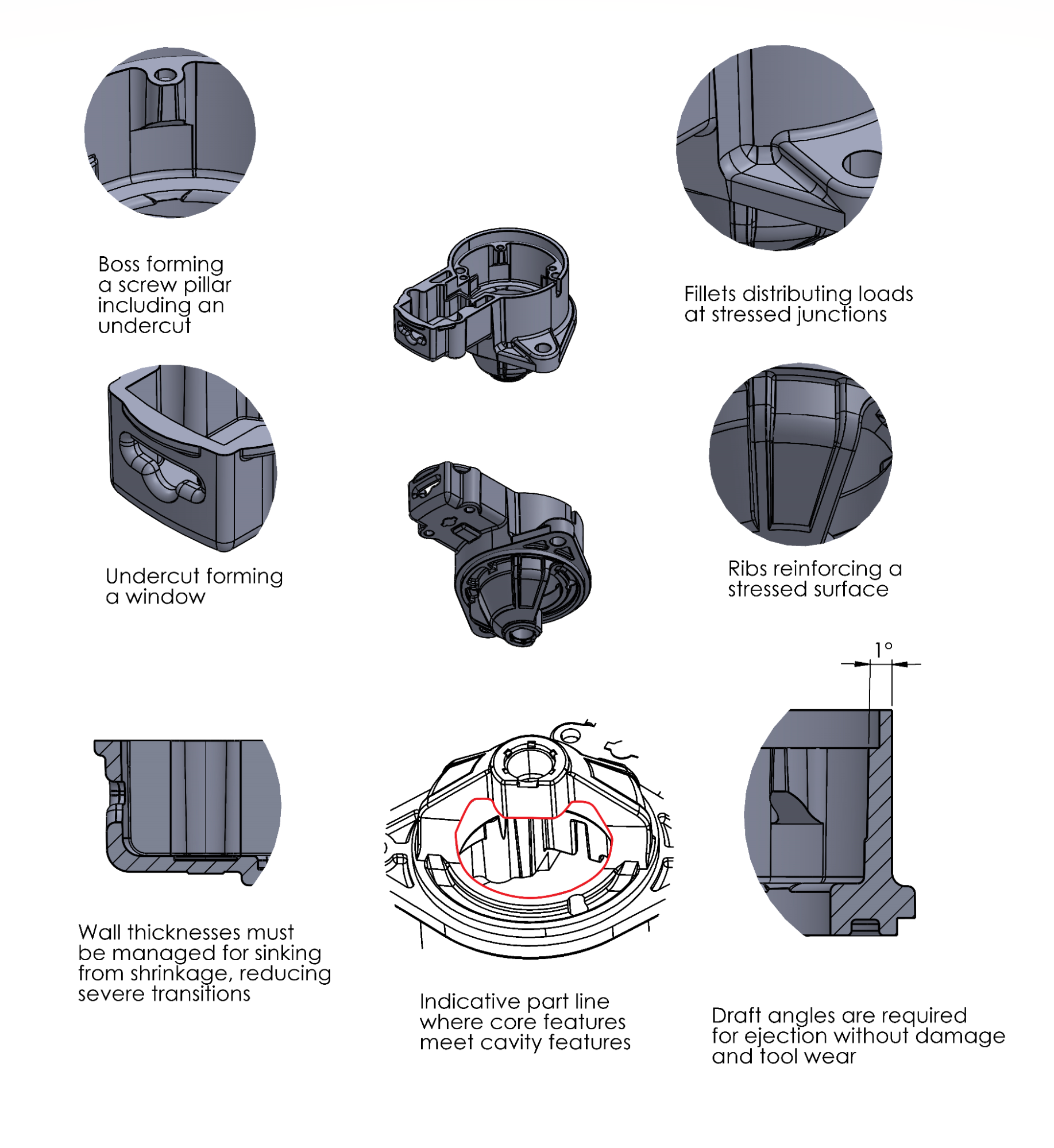

Geometry Changes

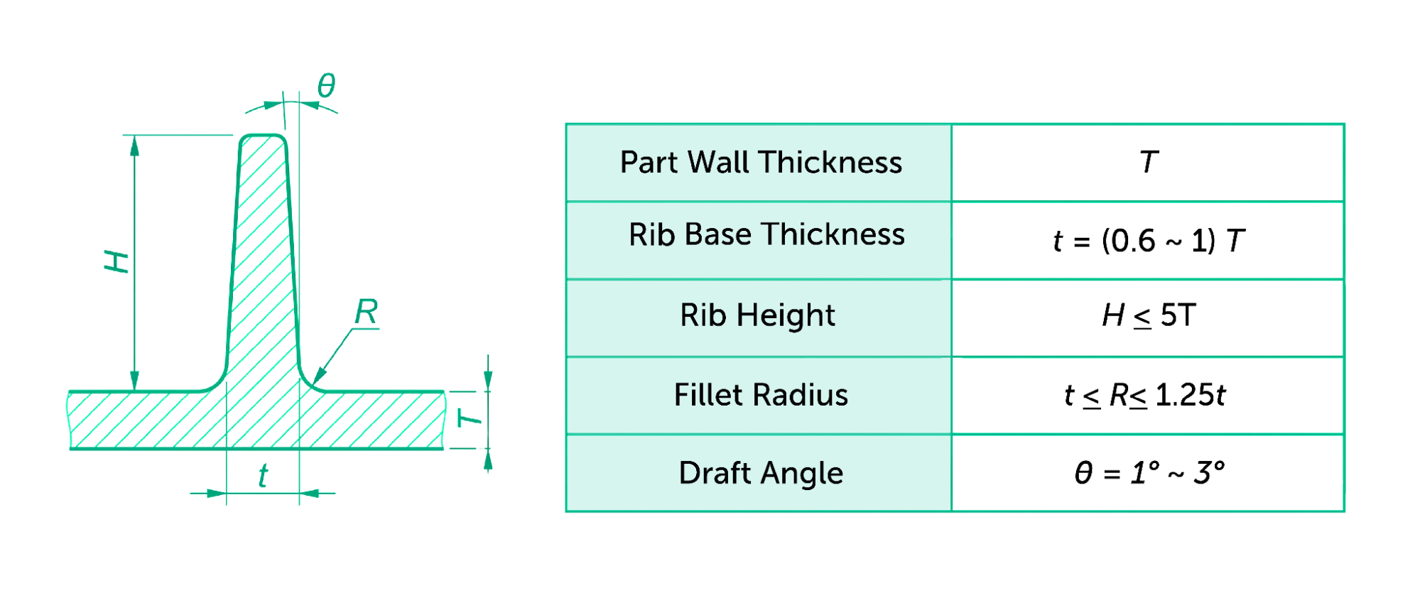

Add Draft Angles: Cast parts require draft angles (typically 1° to 3°) to eject cleanly without damaging the mold or the part itself. Recommended draft angles depend on the part size and process:
  • Sand casting: 2–5° draft
  • Die casting: 0.5–2° draft
  • Gravity/permanent mold casting: 1–3° draft
  • Investment casting: 0–1° draft (wax removal dependent)

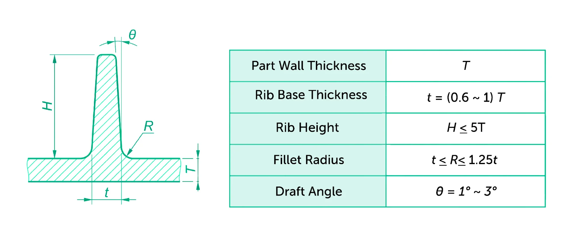

Increase Fillets and Radii: Sharp internal corners create stress concentrations where cracks form during cooling and restrict fluid flow. Replace them with generous radii.
Remove or Redesign Undercuts: Features that prevent the part from being pulled straight out of the mold require complex slides or cores. Eliminate them whenever possible to keep tool costs down.
Die casting rib design guidelines
Wall Thickness Optimization
In casting, thick sections are a liability because they cool more slowly than thin areas. This creates internal stress, warping, and shrinkage voids (porosity).
The location and severity of shrinkage-related defects are determined by part geometry and solidification direction, which is why uniform sections and proper feeding strategies are critical. Recommended wall thickness depends on process, alloy, part size, flow length, and structural requirements. Thin-wall die castings may be 1–3 mm thick, while sand/permanent mold steel, iron, or large aluminum castings often require thicker nominal sections.
To stiffen a part, add thin, drafted, intersecting ribs to provide structural rigidity without adding concentrated thermal mass by thickening walls. Rib thickness should be 50-70% of nominal wall thickness.

Critical Feature Redesign
Avoid casting precision or load-bearing threads. Cast the boss solid or with a pilot hole, and machine the threads as a secondary operation. For features that require tight tolerances (including bearing bores and sealing faces), add extra material (machining allowance so they can be CNC machined after casting.

Engineers should design the part so it can be gated, vented, fed, and ejected effectively; the foundry typically finalizes runner, gate, riser, vent, and overflow design. Designers must ensure that the metal can flow smoothly, without creating turbulence that traps air and creates defects. Part orientation within the mold affects filling and flow behavior, and should be considered in the design process.
Filling and Feeding
It’s important to distinguish between filling and feeding: filling is how molten metal enters the mold via the gating system, while feeding is the process of compensating for shrinkage during solidification by supplying extra molten metal via risers or pressure. Optimizing both may require tradeoffs in geometry and process design, as features that are easy to fill may be difficult to feed during solidification.

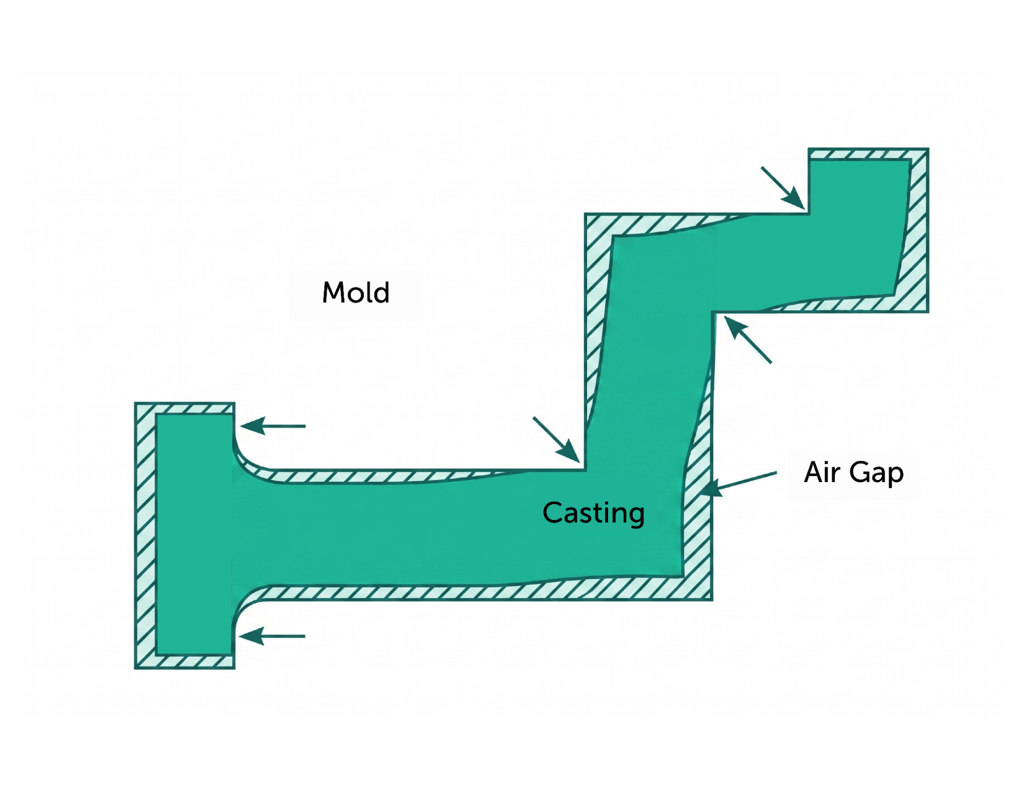

Shrinkage, Tolerances, & Allowances

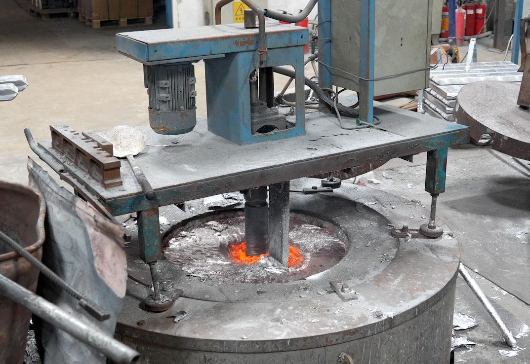

Metal shrinks as it changes from a liquid to a solid, and shrinks further as it cools to room temperature. To account for this, provide a machining allowance (typically 1.5 mm to 3 mm) on any face that will require post-cast CNC machining to ensure the cutter doesn’t “air cut” or fail to fully clean up the cast surface.
Molten metal undergoing degassing prior to casting

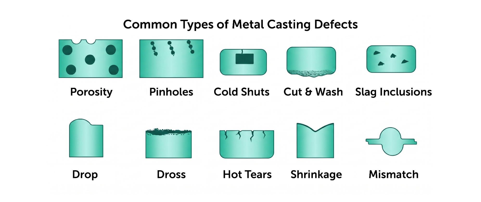

Casting Defect Prevention
Casting defects are often driven by the interaction of part geometry, material behavior, and process conditions during filling and solidification. Understanding the root causes of common defects helps guide better design decisions and reduces the need for costly tooling or process changes.
  • Warping: Caused by uneven cooling rates and thermal gradients across the part, leading to distortion. Prevented by designing uniform wall thicknesses and balancing mass distribution to promote even cooling.
  • Misruns/Cold Shuts: Occur when molten metal solidifies before fully filling the mold or when two flow fronts fail to fuse properly. Prevented by avoiding overly thin walls, optimizing flow paths, and maintaining proper pouring temperature and speed.
  • Shrinkage: Occurs when metal contracts during solidification without adequate feeding, creating internal voids or surface sinks. Prevented through proper riser design, directional solidification, and avoiding isolated thick sections.
  • Inclusions: Caused by non-metallic contaminants (such as slag, oxides, or sand) becoming trapped in the casting. Controlled through clean melt practices, filtration, and minimizing turbulence during pouring, which can entrain surface oxides into the molten metal.
  • Discontinuities: Includes cracks or separations formed due to thermal stress during solidification or cooling. Prevented by using uniform wall thicknesses, adding fillets, and designing to allow controlled contraction.
  • Hot Tearing: Occurs when the casting is restrained during solidification and cannot contract freely, causing cracks at high temperatures. Prevented by using uniform wall thicknesses, adding fillets, and designing to allow for controlled contraction.

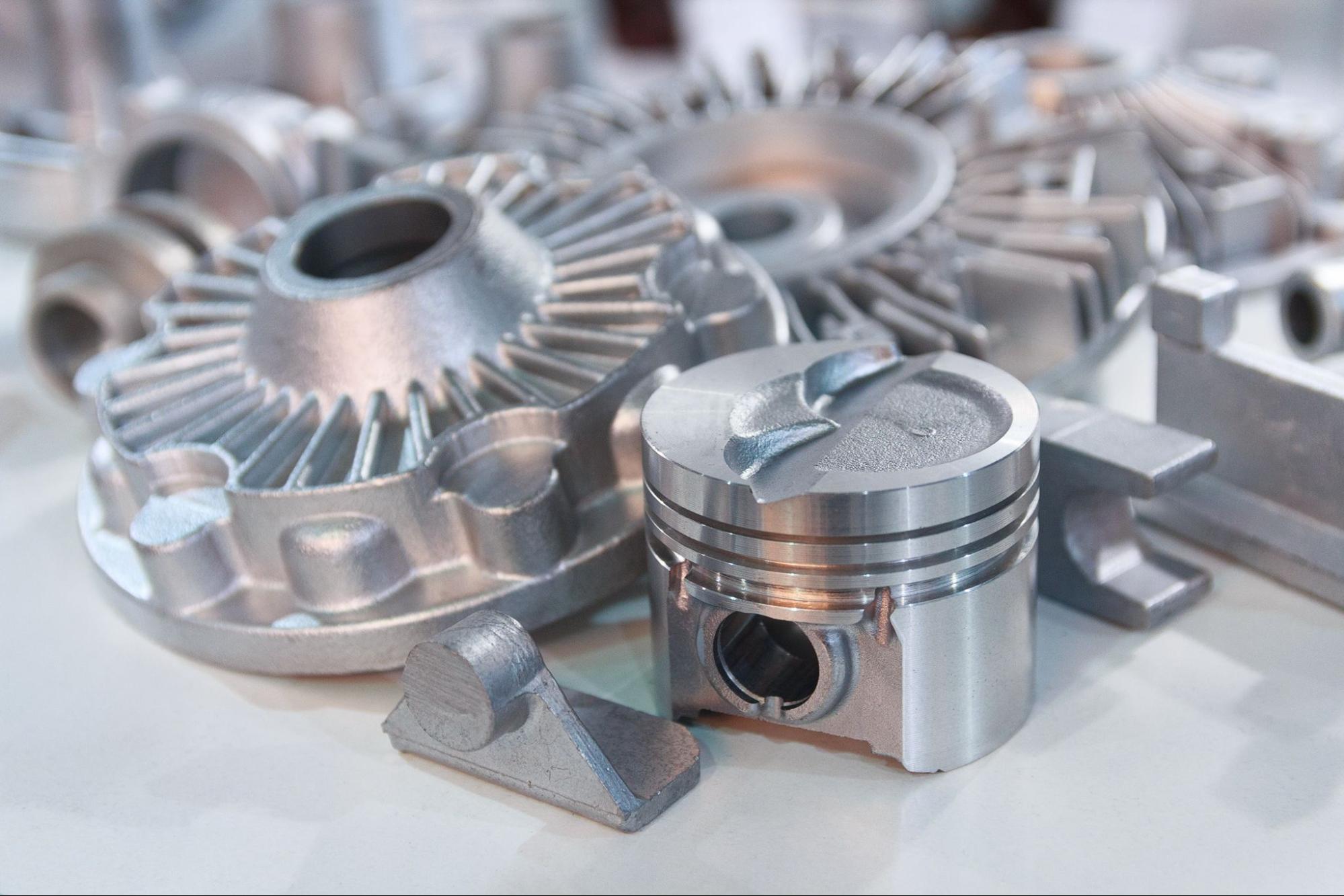

Hybrid Strategy: Casting + CNC Finishing
The most effective high-volume manufacturing programs rarely rely on casting alone. A hybrid strategy combines the speed of casting with the precision of CNC. For instance, you can use casting to achieve 95% net shape, then use CNC machining to finish only the critical interfaces, precision holes, and sealing surfaces.
To make this hybrid strategy successful, consider incorporating CNC fixturing into the cast part design. Ensure the cast part has reliable, repeatable “datum” features that a CNC fixture can locate against, so post-machining operations stay aligned with the cast geometry.
Cast parts with post-machined finish

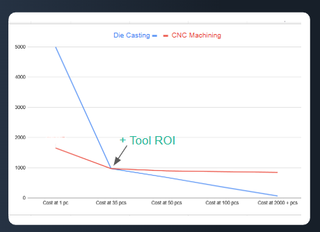

Understanding the break-even dynamics of your specific project allows you to optimize purchasing. Batch size plays a massive role in casting because setup costs for a die-casting machine are high.
The CNC line starts low and decreases slowly; the casting line starts with a high tooling cost, but slopes down with a positive ROI after only 35 pieces. Manage orders carefully and run larger batch sizes to maximize ROI and lessen the impact of machine changeovers. Always account for the cost of secondary operations (including machining, coating, and heat treating) when calculating the final scaled unit cost.

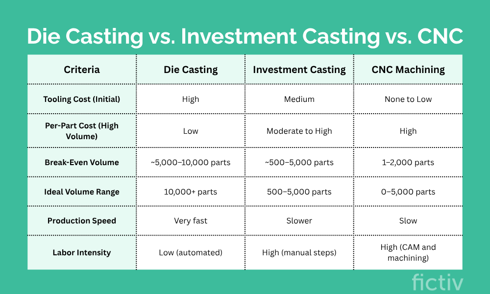

Cost Break-Even Framework
Deciding when to pull the trigger on casting requires a life cycle cost analysis.
Tooling vs. Piece Price: CNC has near-zero upfront tooling costs but a higher piece price. Casting requires significant upfront investment in molds, dies, or patterns, but yields a much lower piece price at high volume.
Volume Thresholds: Sand casting generally becomes viable in the low-to-mid hundreds. Investment casting often makes sense in the mid-hundreds to low thousands. High-pressure die casting usually requires volumes in the thousands to justify the cost of steel dies.
Plotting the total cost of CNC vs. casting (Tooling + [Piece Price × Volume]) shows the exact point at which casting becomes the cheaper financial option.
