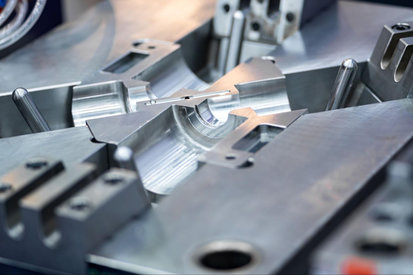

A machined mold for casting - CNC vs Casting scorecard
Die casting mold
