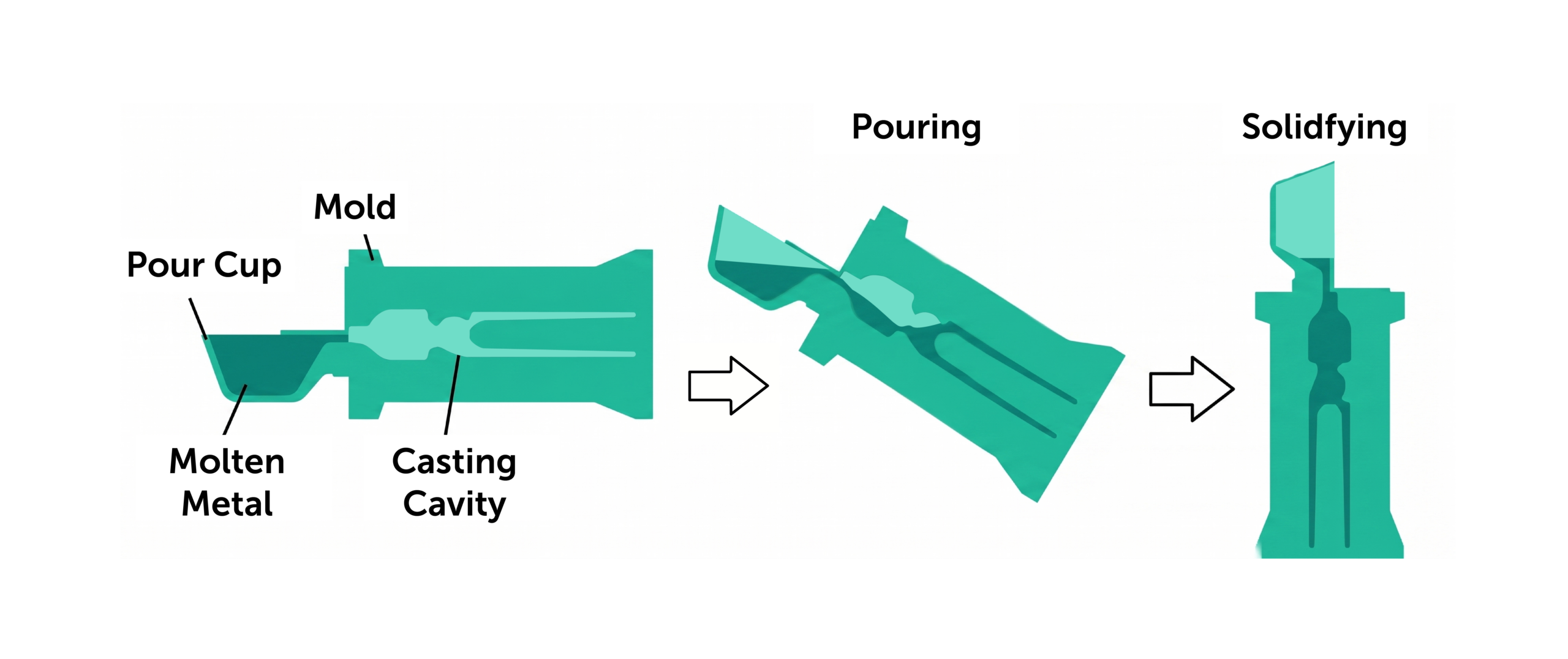

Tilt-pour gravity casting
Tilt pour gravity casting

Reusable gravity casting molds, usually made from steel or cast iron, are preheated before production begins. Preheating raises the mold temperature to a controlled range, which reduces thermal shock, slows premature metal freezing during initial contact, and promotes more consistent mold filling, especially in thinner sections. After preheating, mold coatings or release agents, such as graphite or ceramic compounds, are applied to control heat transfer rates, improve surface finish, and facilitate easier part release.
Pouring Through the Sprue and Runner System
Molten metal is poured into the mold through the sprue, then travels through runners and gates into the cavity. Because gravity alone drives this movement, flow path design is especially important. Poorly designed runners or abrupt directional changes can create turbulence, trap oxides, or cause incomplete fills.
Controlled Solidification and Feeding
Once inside the cavity, the metal begins to cool and solidify. Metal molds extract heat faster than sand molds, which often improves grain structure and dimensional consistency. Solidification must also be managed so that shrinking metal continues to receive feed material from thicker sections or risers. If wall thickness changes too abruptly, or if gating and riser placement are poorly designed, shrinkage cavities, hot spots, or incomplete feeding can compromise part quality.

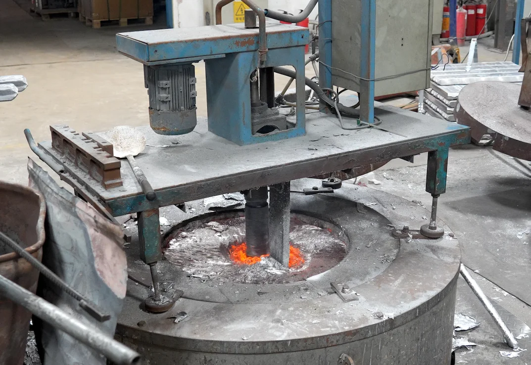

Metal mixing and degassing before gravity casting

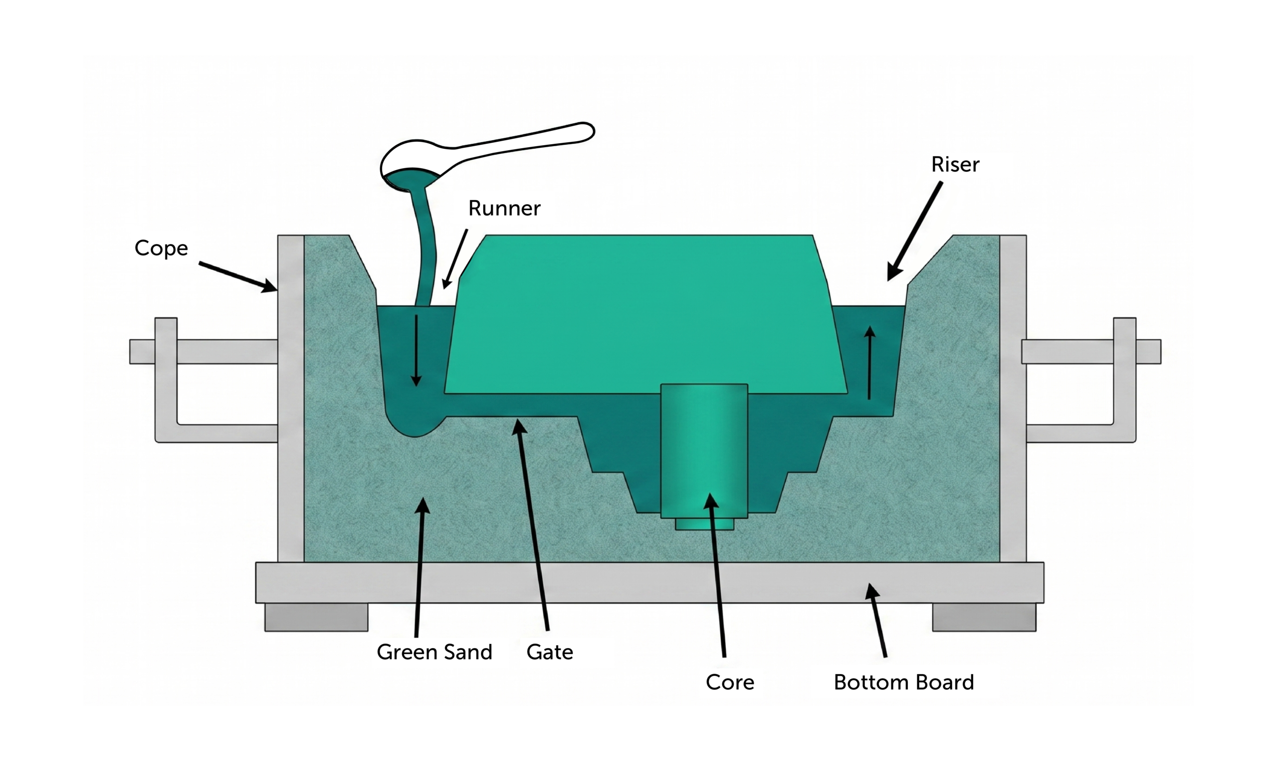

Permanent Mold Casting vs. Sand Casting
Sand casting uses expendable molds, which keep upfront tooling costs lower and allow greater flexibility for low-volume production or large parts. Permanent mold casting, by contrast, uses permanent molds that provide more stable cavity geometry from cycle to cycle. That stability improves as-cast surface finish, dimensional consistency, and mechanical property repeatability, though it comes with higher initial tooling investment.
permanent mold gravity casting vs. sand casting
