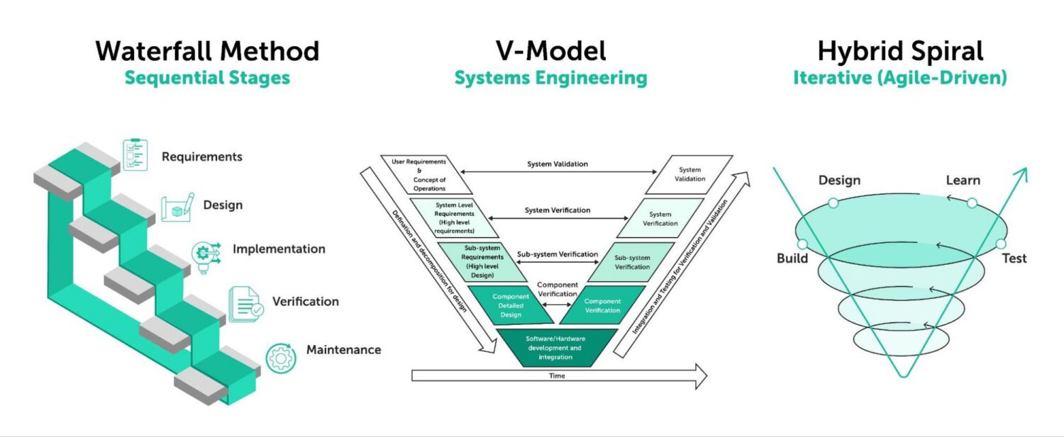

The Main Types of Stage Gate Product Development Process Models
Stage gate product development process models

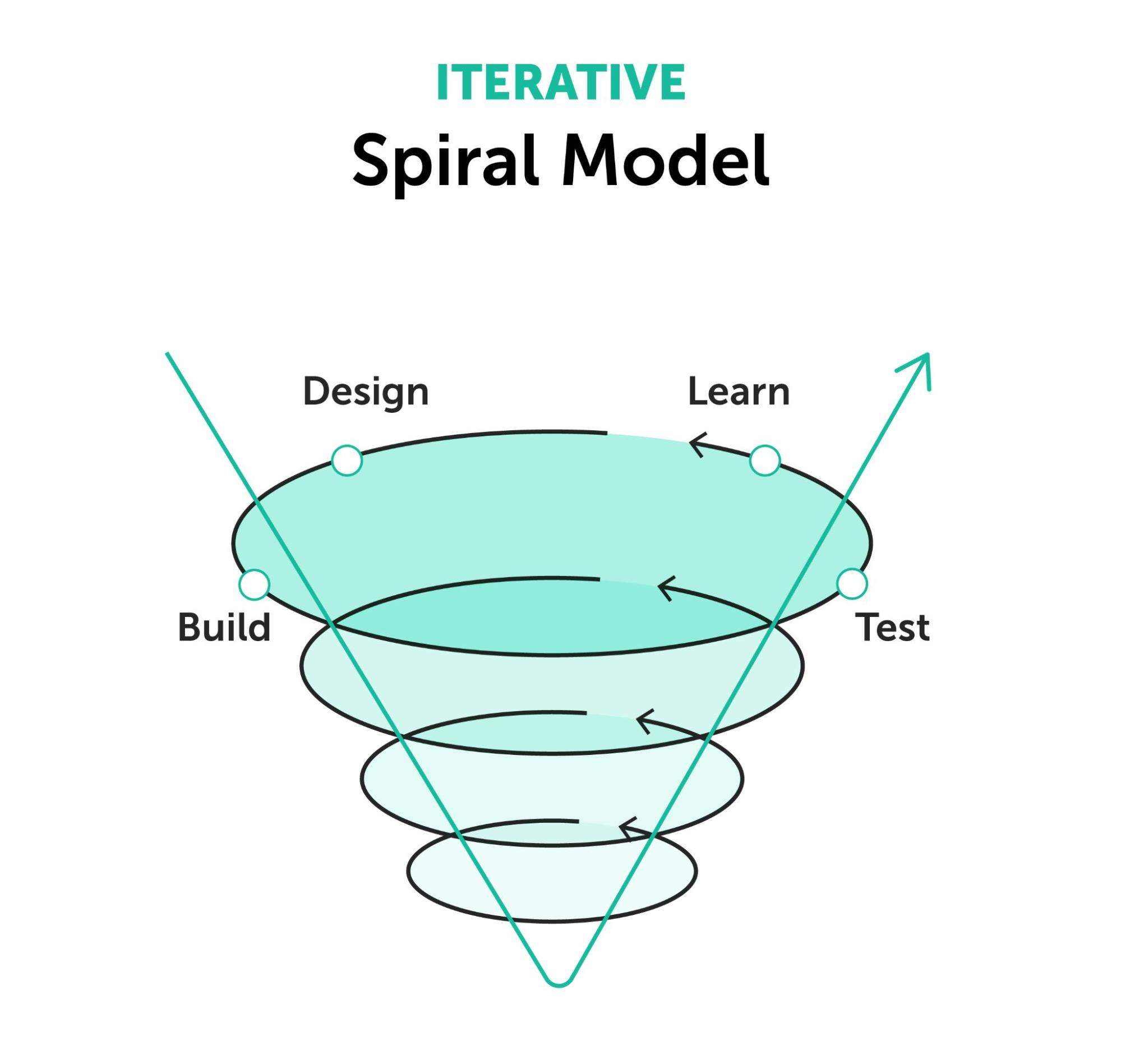

Stage gate product development process models Waterfall V Model Spiral
For complex hardware programs across robotics, aerospace, automotive, and consumer hardware, the result is a broad set of process variants that all trace back to the same core idea: use defined stages and reviews to manage integration risk in physical systems—ensuring that mechanical, electrical, software, and manufacturing systems converge into a functioning product at the right time and cost.
What follows is necessarily selective. Thousands of variations exist, each shaped by an industry’s regulatory environment, risk tolerance, cost of change, and speed requirements. Even within the same sector, Company A’s “phase-gate” may look nothing like Company B’s, and a single organization can run several distinct flavors at once. Cataloging them all would require a textbook.
Instead, we look at three widely recognized archetypes that represent the major ways stage gate thinking is applied today:
  • Waterfall: Sequential phases with major, infrequent milestone reviews
  • V-Model: Systems engineering flow linking requirements to verification
  • Hybrid (Agile-Derived): Short, iterative cycles with lightweight gates and periodic larger releases
These are not the only models, nor are they always used in pure form, but they capture the dominant frameworks used by modern engineering teams. Understanding where each excels and where it falls short helps teams align their processes with their technical, market, and regulatory constraints.

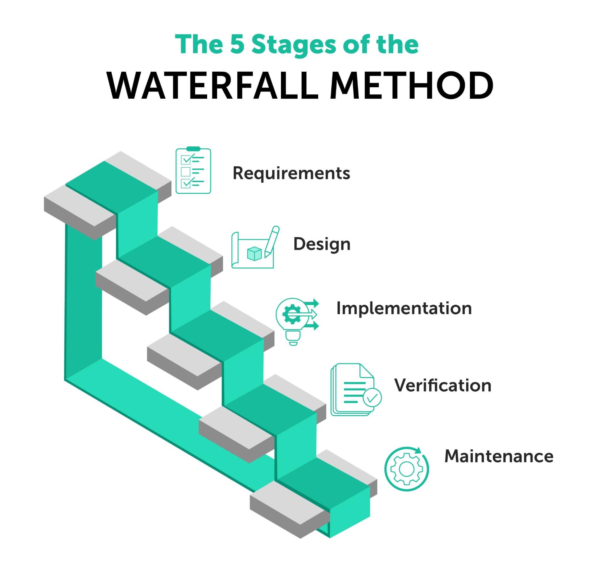

Waterfall Development Cycle
5 stages of the waterfall stage gate process method
5 stages of the waterfall stage gate method Management
Waterfall is the earliest expression of stage gate thinking and follows a predominantly sequential progression from requirements → design → build → verification → launch
Its clearest descendant in modern hardware development is the EVT–DVT–PVT build path, where each phase forces the team to mature the design and manufacturing process together and pass a formal gate before moving on.
  • Engineering Validation Test (EVT): Integrate the full system in a production-intent form factor, select the design configuration, and uncover the complete issue list. Soft tools and engineering processes are still allowed.
  • Design Validation Test (DVT): Validate that the chosen design meets all requirements across performance, environmental, reliability, and cosmetic tests, using production materials, hard tools, and documented manufacturing procedures.
  • Production Validation Test (PVT): Validate the manufacturing line(s) at target speeds, confirm yields, train operators, and lock the process for ramp. Units can be sellable if quality requirements are met.
Most teams start with a prototype build (Proto)—a low-volume run used to test early concepts and validate key mechanisms—before the three formal gates above.
These validation steps help program management plan and evaluate trade-offs among risk, performance, cost, and schedule. Testing at each stage validates whether the design adheres to the original design intent and identifies where any changes are needed.
Most Used In: High-volume hardware and electronics programs, including consumer devices, IoT, robotics products, wearables, appliances, and industrial electronics. Any industry where manufacturing ramp drives the development cadence.

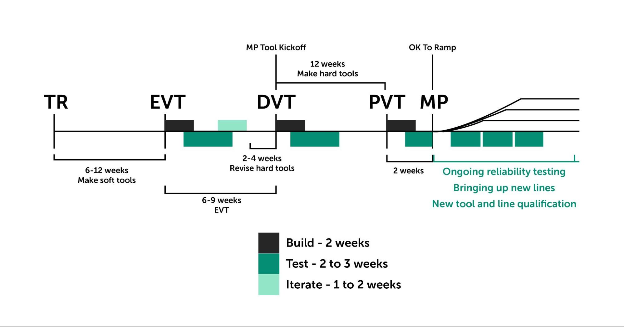

A Representative Development Schedule (EVT, DVT, PVT)
A Representative Development Schedule Instrumental
If you’re using injection molding for prototyping or production, use Fictiv’s Injection Molding Gantt Chart to align tooling and build timelines with your stage-gate milestones.

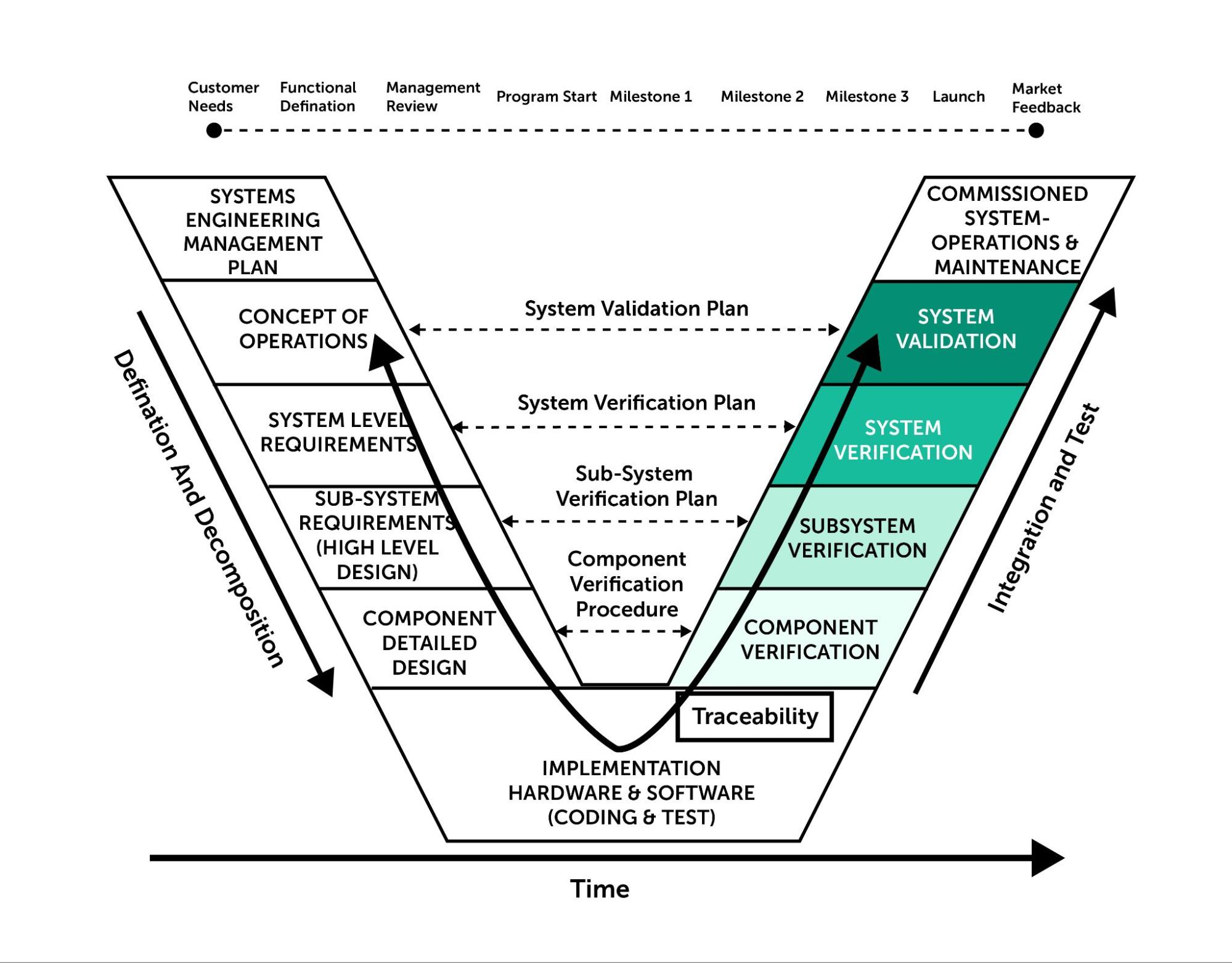

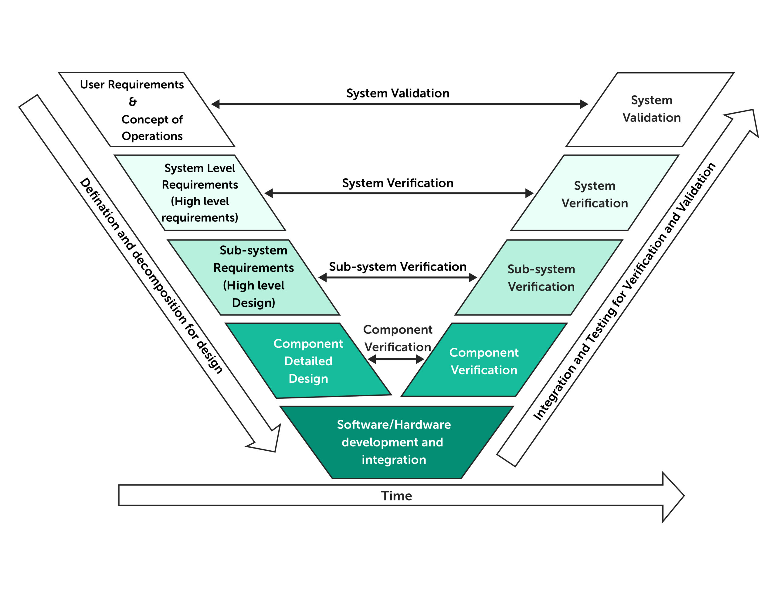

V-Model Development Cycle
V-Model process for hardware systems verification
V Model for hardware systems verification Source
The V-Model is the systems engineering expression of stage gate thinking. Instead of a primarily linear sequence, it explicitly maps the relationship between requirements, architecture, implementation, and verification. This structure is especially critical in systems where subsystem interfaces must be defined early and validated rigorously to avoid late-stage integration failures
The left side of the V decomposes the problem, from system requirements down to subsystem specifications. The right side climbs back up, validating each layer and pairing every requirement with a corresponding test, analysis, or inspection.
What distinguishes the V-Model from a sequential development flow is traceability. Requirements are allocated to subsystems, linked to verification methods, and revisited during integration.
In safety-critical and regulated industries, the V-Model remains the dominant framework because its emphasis on requirements traceability and structured verification matches the rigor these programs demand.
Most Used In: Traditional aerospace and defense programs, automotive (ADAS, autonomy, functional-safety components), medical devices.

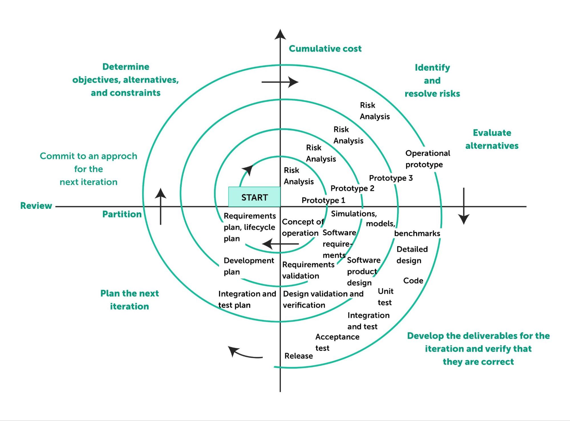

Hybrid Spiral (Agile-Derived) Development Cycle
Hybrid spiral process model for iterative product development
Iterative hybrid spiral model for product development MIT

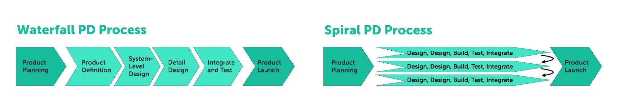

In engineering development, “agile” is less a standalone process and more a response to the limits of traditional stage gate thinking in environments where uncertainty is high and fast learning matters. Instead of committing to long sequential phases, teams work in short, bounded cycles designed to surface risks before they compound.
Each cycle (V0, V1, V2, and beyond) functions as a contained experiment where the goal isn’t to be right upfront, but to reduce risk and increase fidelity with each loop. Every iteration produces something concrete (subassemblies, test coupons, early prototypes) that generates data and informs the next decision.
One classic contrast illustrates this mindset shift.
The traditional aerospace development model (design → build → test) assumes early correctness, freezes architecture early, and verifies only after full integration.
SpaceX’s model (build → test → learn → redesign → test → scale) assumes early uncertainty, integrates from the start, and treats milestones as checkpoints—not destinations.
Where traditional development cycles emphasize specification maturity before major integration, agile-derived approaches deliberately front-load experimentation. Architecture is allowed to evolve, and requirements may be provisional.
Not all requirements flex equally: top-level mission outcomes (e.g., payload mass, range) are fixed anchors, while lower-level design parameters are tradeable as iterations inform the next architectural decision.
Iteration speed becomes the primary mechanism for reducing technical and integration risk. These cycles still have gates, but they’re lightweight and tied to learning objectives rather than formal maturity milestones.
In practice, most engineering teams adopt iterative loops early (when the cost of change is low) and transition into more structured stage gate processes as the design stabilizes, the supply chain locks, and verification requirements tighten. The result isn’t pure agile but a hybrid—with rapid iteration upstream and disciplined validation downstream.
Most Used In: Early-stage aerospace and space systems, advanced energy, and new material systems. Any domain with quickly evolving requirements where continuous integration is the safest (and potentially fastest) path to a viable architecture.

Waterfall PD process compared to Spiral PD process
Waterfall PD process compared to Spiral PD process MIT
