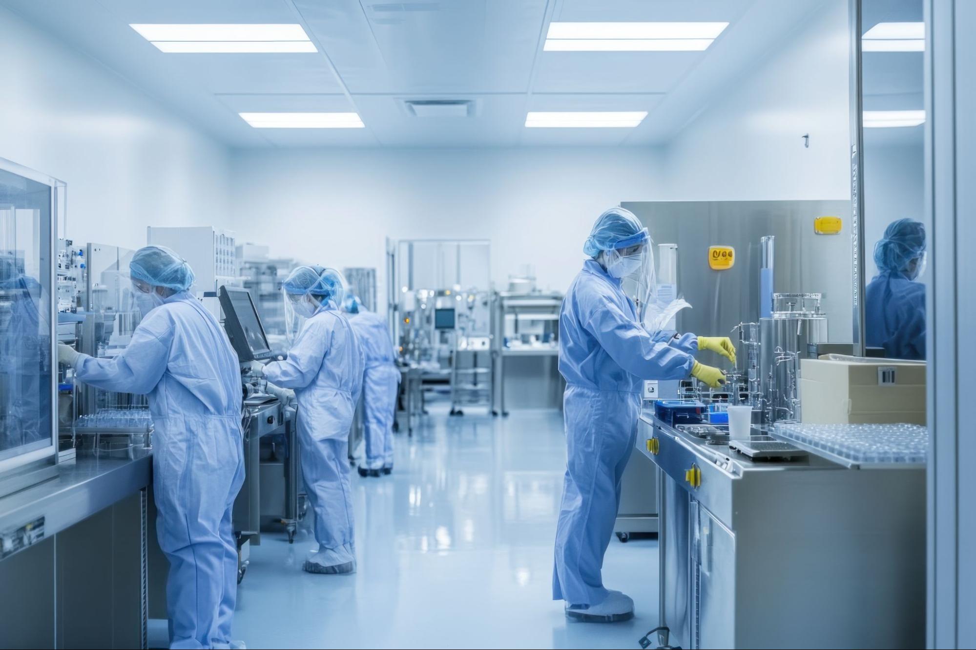

Manufacturing in a cleanroom environment.

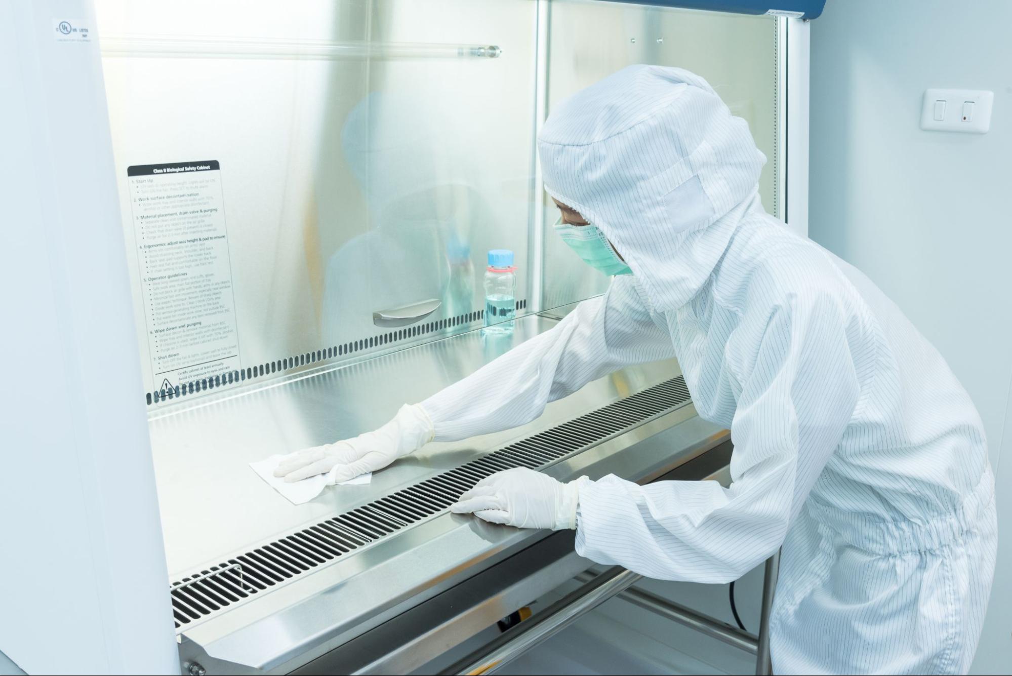

A manufacturing worker cleaning a biological safety cabinet used for assembly.

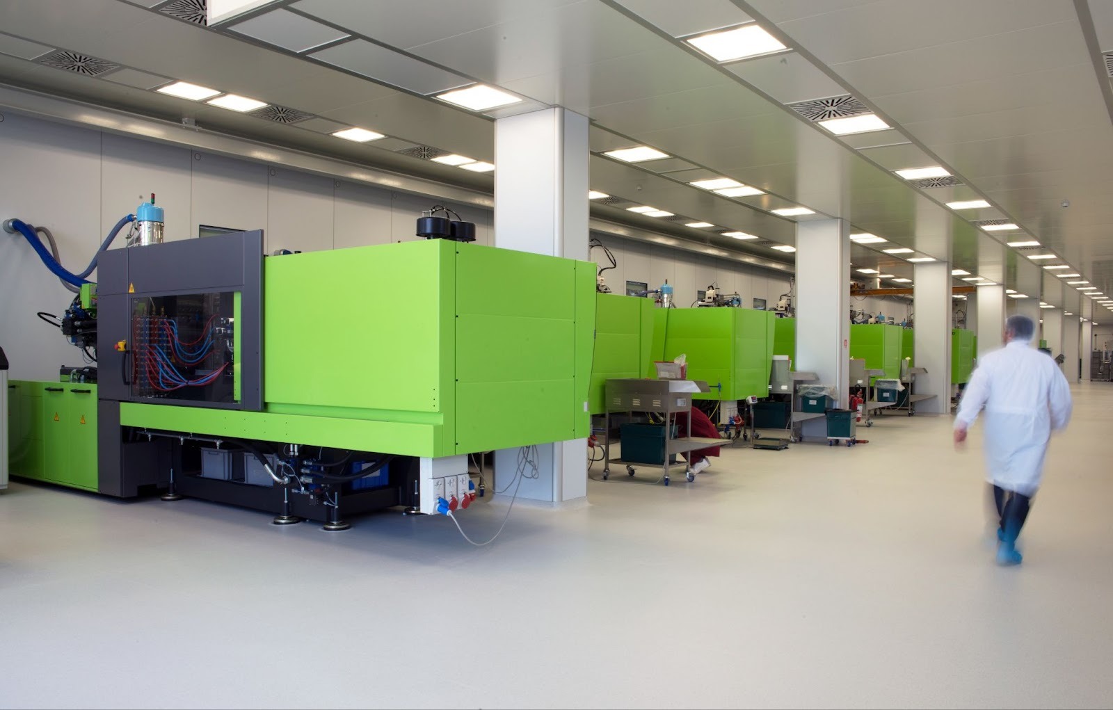

Injection molding in a cleanroom

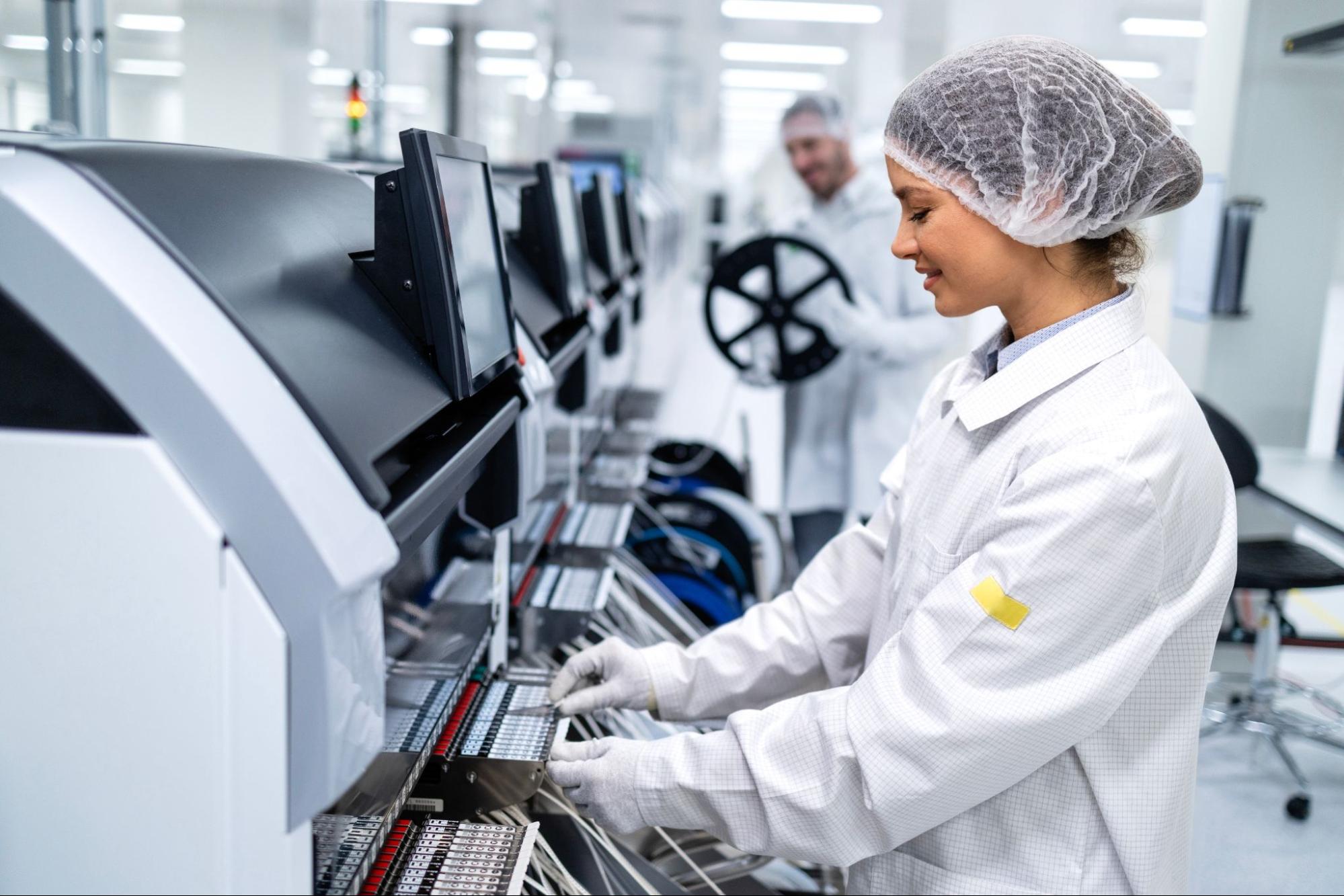

Factory worker operating a semiconductor production machine in the electronics industry.
